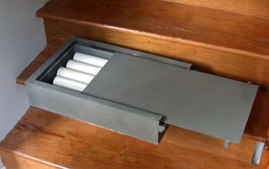

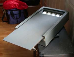

Hallo Sandy
Sometimes a pictures tells more then 1000 words is it not possible to show your setup on a picture because I did not fully get it, because english is not my motherlanguage.

OK, I am attaching a couple of jpegs. Hope this explains the concept of the light safe developing tray. As you can see, once the top slide is inserted the inside of the box where the tubes are is light tight. To agitate, I simply turn off the lights, pull out the slide and move the tubes around as I want. With this particular box I can do four 7X17 sheets at a time, using either normal, minimal, extreme minimal or stand agitation.
The box was made by cutting the wood to the right size and gluing everything together with epoxy glue, then the outside and inside was coated with epoxy paint.
