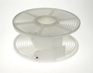

The Arista Premium/Samigon/AP reels with the larger tabs work great - much easier than the Paterson version.
These ones: http://www.freestylephoto.biz/55043-Arista-Premium-Plastic-Developing-Reel
They are sold under a number of different names. Be sure to get the version with the larger tabs.
They look like this:

Thanks! that funnel looks so much better!!
Do these fit in a Paterson tank?
