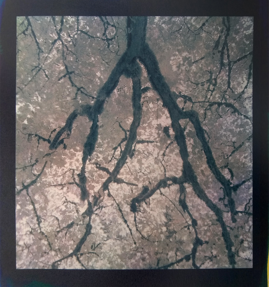

Arterial
Arterial

adding a black by four colour separation (CMYK), will increase dmax... I don't do that. I use cyanotype as my cyan, then drop yellow and red layers over top. I'm quite please with the dmax. I don't use shiny papers... never heard of anyone doing that with gum. I use a good paper like Hahnemuhle Platinum Rag. For about a year now, I've been printing with just two negatives, my monochromatic images. The first negative is for cyanotype, the second negative is for both the red and yellow. I'm really liking my results. I've also been dropping just an orange layer (forgot the pigment name) over top of the cyanotype, to give it a more bluish/purple look. I've stuck a few in my gallery. The church image is orange over cyanotype. The next two are red and yellow over cyanotype.
