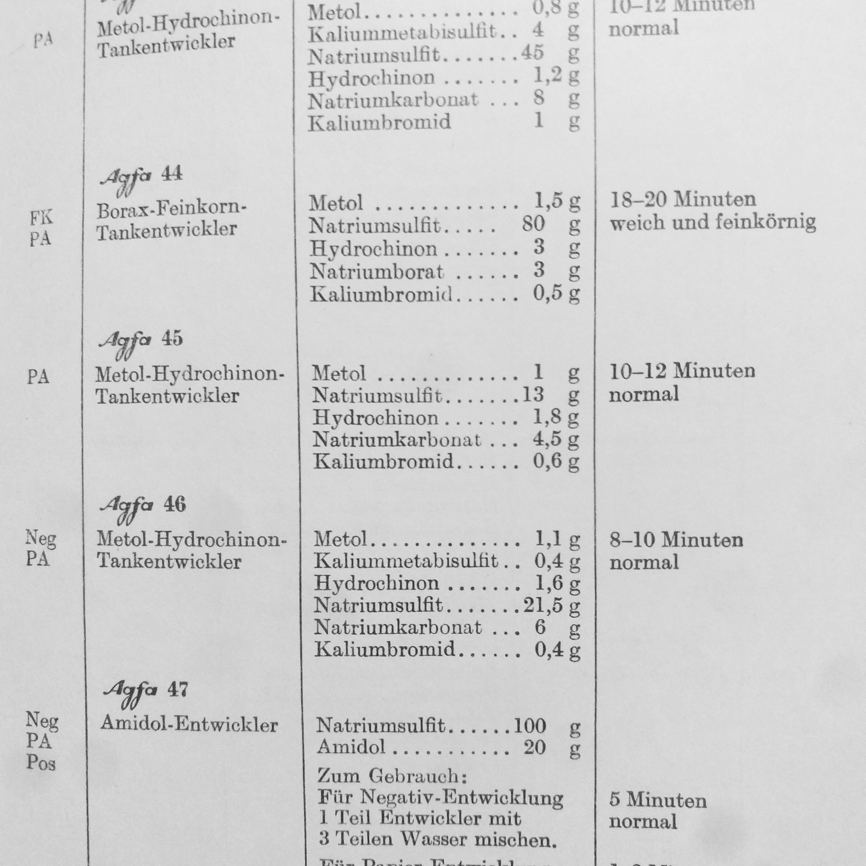

Agfa 45 with just 13g of Sodium Sulphite but not marked as fine grain developed....
PA: Portrait and Ameature
FK: Feinkorn (Fine grain)
Luckily the chemistry is easy to translate, I have two Agfa Rezeptes, and a later Orwo Rezeptes. I think Agfa 45 will be quite grainy with some films. I also have a Dr Moome Andresen Agfa Photo-Handbuch but my German is rather non existent.
I like the term "Feinkorn" for fine grain :D Makes me think of taht Kodak film was it 2475 that had grain the size of Sweet Corn (cob corn). :smile:
Ian
Opposite to feinkorn is grobkorn :getlost:
Will mix Agfa 44 for HP5+ and FP200.
