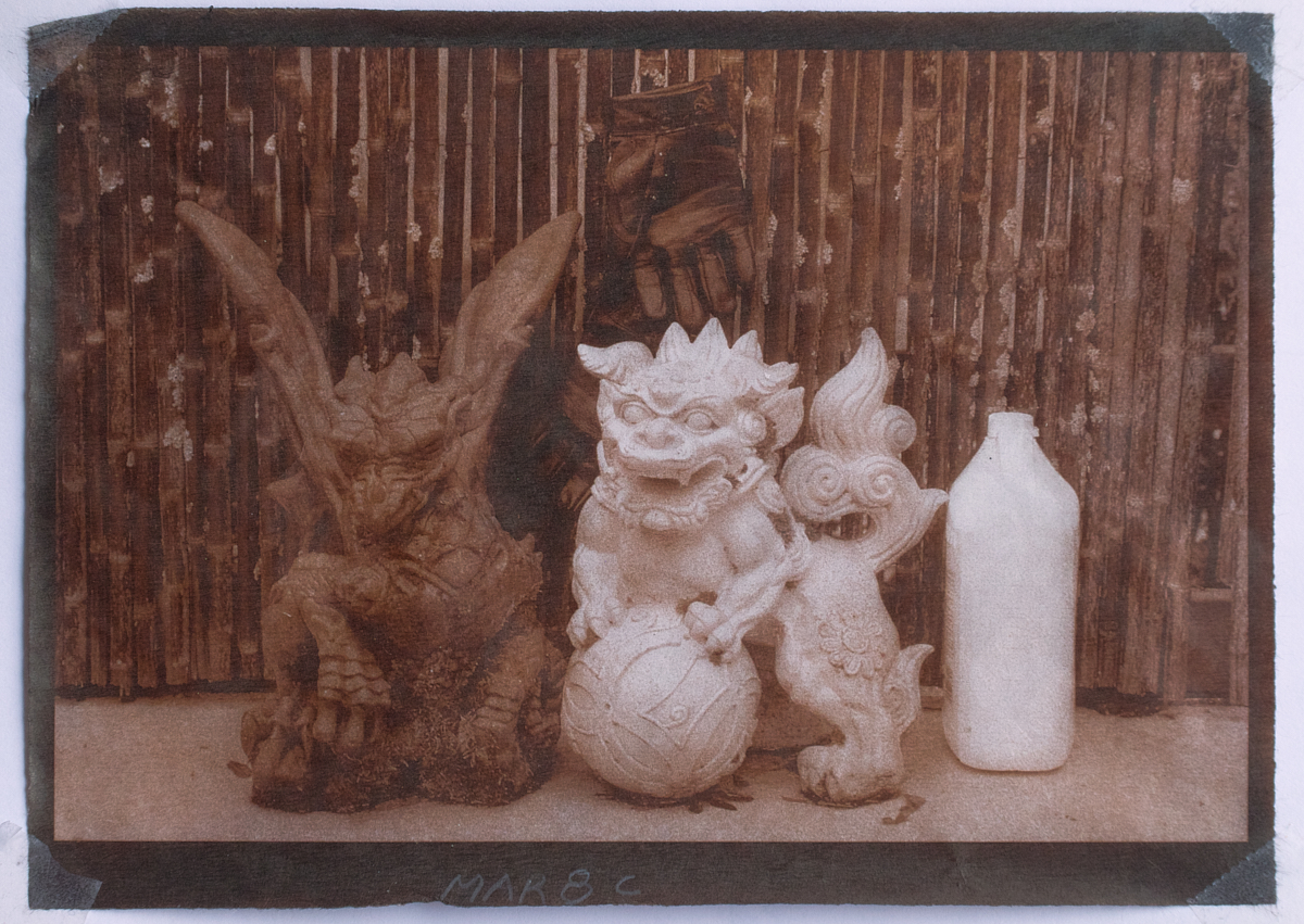

Anybody else messing around with Mike Ware's Argyrotype process? Seems to be a bit of a rare breed in the siderotype, ferric-silver world.
Do you have any you want to share? Any discoveries of note? Process and/or paper findings?
I first tried salt prints, kallitypes next, then found there was something about argyrotypes which is fuelling the necessary resolve to try and wrangle things into control. Just placed my first order for palladium, so that has to be some kind of positive sign! Have been dabbling at it for a couple months, so still making test prints...nothing even close to a finished print yet.
To get the ball rolling, here are some early tests:
Straight print on Kozo compared to the same print heat treated after drying for about 5 minutes at 150F...
...and the first one on Kozo with the second on Clearprint 1000H cotton vellum from the same negative, same # of drops, and same exposure...
I'm investing minimal time on copying these test prints (obviously) just posting them here as examples of the wild variations found so far. The Kozo used here is wrong for the process (blotchy) and have another Kozo on order. Don't think the Clearprint cotton Vellum will be used again...just doesn't have the transparent when wet, fabric like feel when dry, or mystique of Kozo.

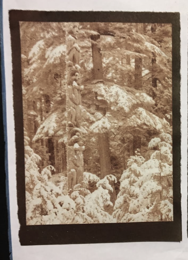

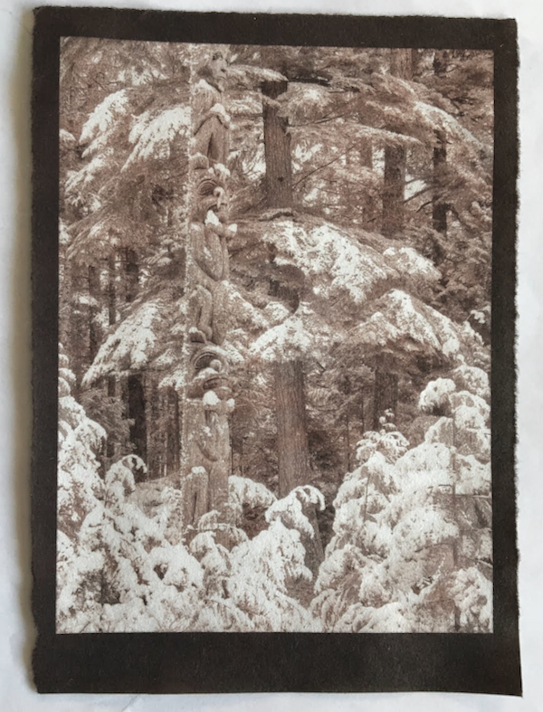

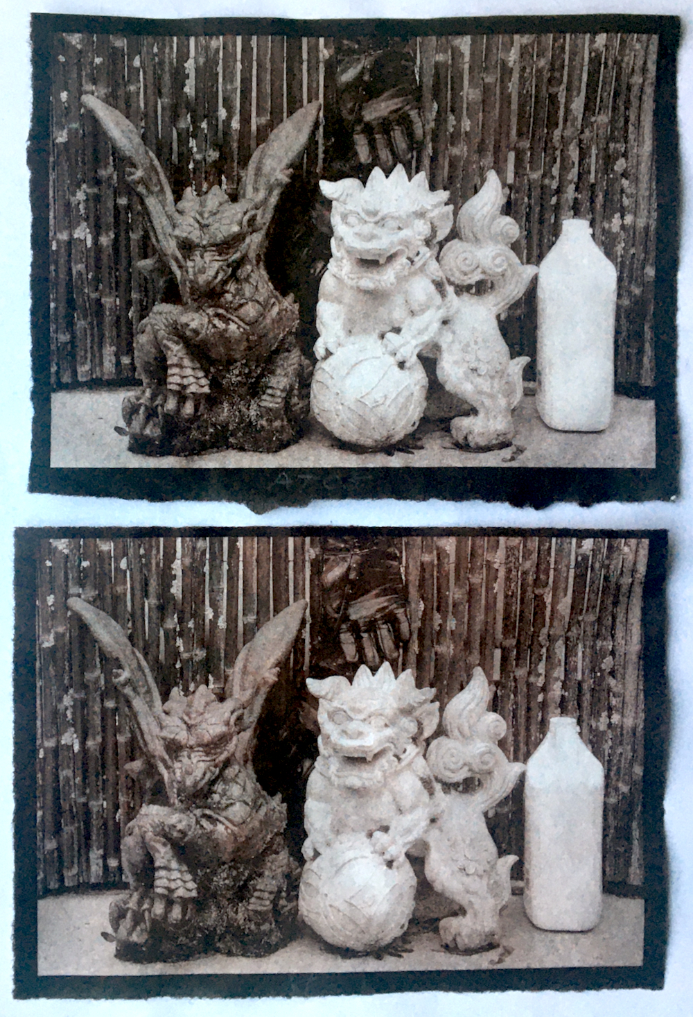

Had a couple days in the dimroom to play. First image is straight from Capture One and the second via an old iPhone, printed on 30gsm Kozo. Pretty happy with the low to mid tones...high tones need some tweaking.
Also discovered that I was printing on the wrong side of the machine made 100% mulberry bark Kozo I have. Read that painters paint on the smooth side and use the 'rough' side for glueing to heavier papers or silk. Sensitizing the smooth side has resulted in much crisper fine lines/details and a deeper max 'black'.
Still a ways to go.......

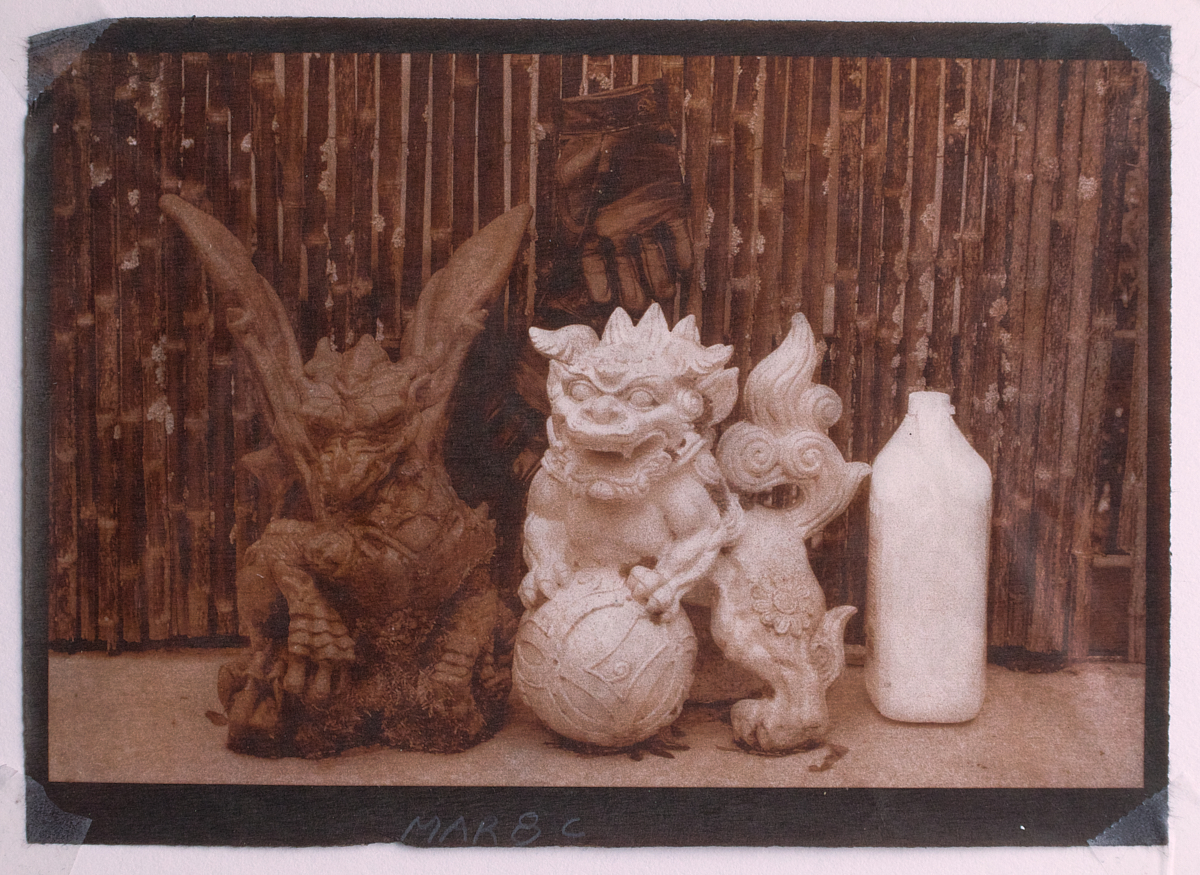

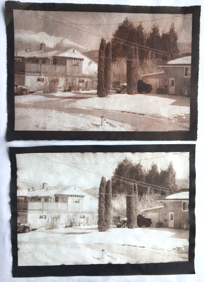

Looking past the extreme yuckiness of this iPhone shot...
Played with the curve a bit more by lowering high tones (while still getting a max white) and lifting shadows in the bottom print at a max black exposure time. Still trying this manually which is helping in one respect; I'm starting to pre-visualize what will happen to the negative and print while changing the curve shape. Hoping this will pay dividends later when serious printing commences.

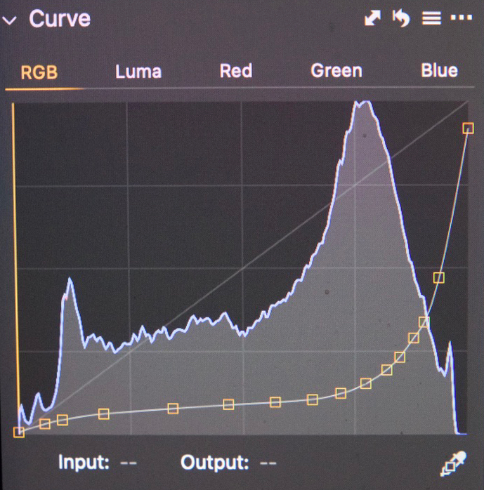

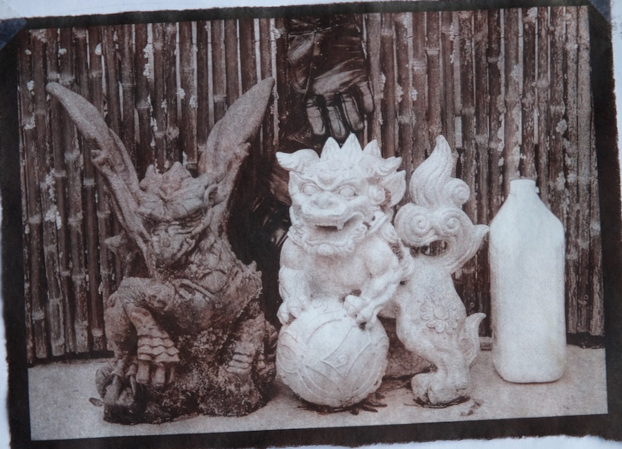

Managed to get some "me time" for another manual tweak to the correction curve.
Last one was flat in the high tones, so looking for a more 'sculptural' feel in the white Dragon's muscles. Second photo is the new one.

You might want to try taking digital snaps of the results accompanied by a print-out of the corresponding curve shape. That could serve as a useful reference going forward.
The photos above are from RAW digital camera files, then emailed in jpeg form to my MacBook. The only adjustments were to crop and add .10 to the exposure before emailing. Haven't started wheat starch glueing them to a support paper yet.
I am a hack. Not even a mere glimmer of anything distantly approaching expert status. Doing this manually, by feel (no densitometer, etc) so consider yourself forewarned if using this curve. Here's the shape of it in Capture One...
...and here it is by the input/output numbers:
0............2
15..........8
25..........12
49..........16
88..........20
120........23
146........25
167........28
184........32
198........40
209........50
217........60
225........75
231........87
239........121
225........234

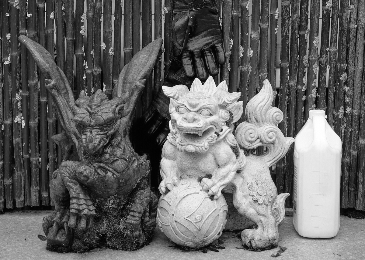

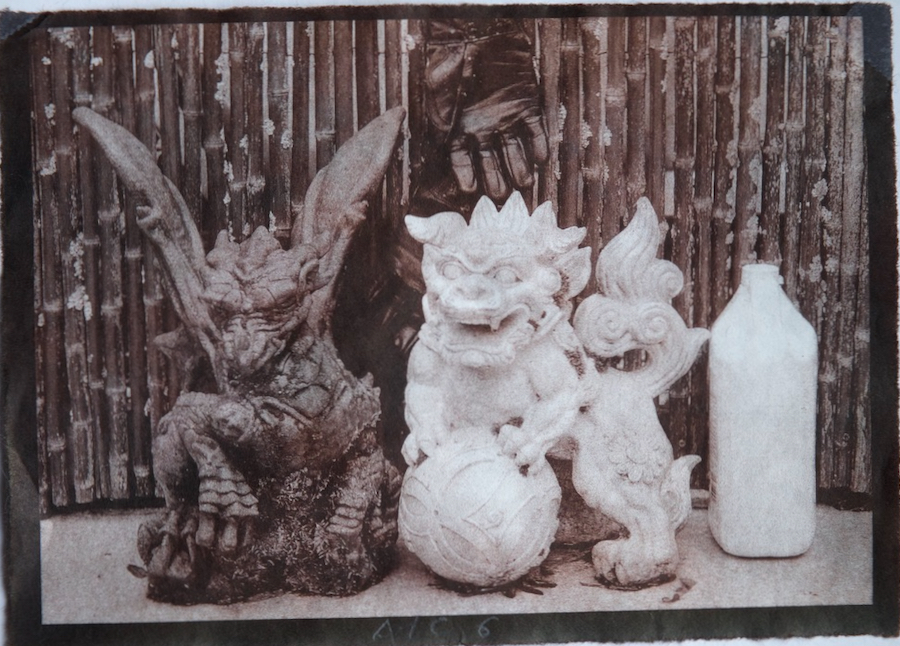

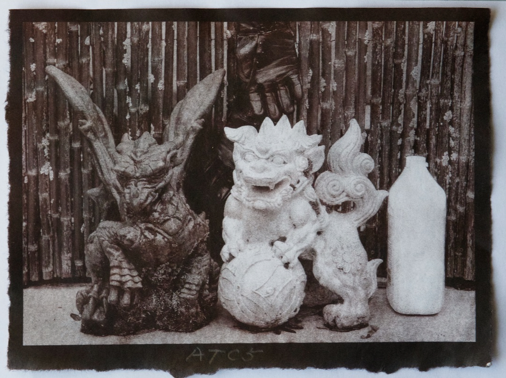

Japanese handmade Gampi has landed. Got sample sheets of 21gsm, 29gsm, and 43gsm. Trying the 21gsm first.
Didn't do any test strips, just jumped right in where I'd left off with the Chinese machine made Kozo. Had to lengthen the exposure by 1 minute 30 seconds to get a solid black.
Initial observations are that higher values are subtler with much more detail. This is probably from Gampi having a smoother surface...lots of detail was getting lost in the Kozo fibres. Blacks are about the same, but lose some resonance(?) because of the natural reflective sheen of Gampi. This Gampi has none of the machine made Kozo's tonal blotchy weirdness.
No problem at all with wet handling. Very thin, but very strong!
One big change over Kozo was how light the coating brushwork has to be. First one went straight into the garbage because of all the paper fibres which got peeled off the surface. Another difference is the natural warm colour of the paper itself compared to the Kozo I'd been using.
Here are a couple untoned examples. (Basic max black exposures...no editing heroics). The second one picked up some reflective sheen from a window. Tried to show how pivotal the support surface is by placing it on Rising museum board (warm) and plain paper (cold) to show how that affects higher values as light passes through the image, and is reflected back through the print. Tried to get the colours close (and failed) so treat the colour casts as mere approximations. (These didn't get the wood stove heat treatment).
For reference, the only pure white is supposed to be on top of the plastic jug handle, and the only pure black is below the glove behind & between the Dragon and Foo Dog heads. The lighter Dragon values are supposed to be Zone V.
