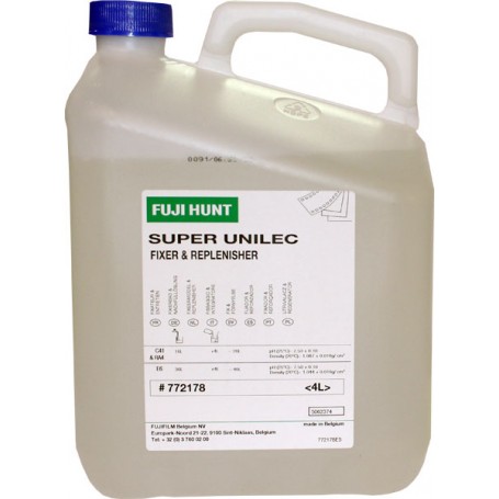

Fuji-Hunt Unilec is what you need.
I am aware of c41 fixers, but i have hypam... Liters of them...
