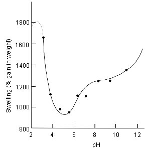

Plot of fix/swell/wash rate vs pH - Bone Gelatin
I have posted this graph before on APUG and Photo Net illustrating the effects of pH on the fix rate, wash rate and swell of bone gelatin in photomaterials.
This comes from a site in Australia and was passed on to me several years ago by someone. The site is concerned with archival properties of primarily motion picture film and has studied fixers wash rates as a function of pH.
Thus, this is a graph that encompasses all 3 characteristics of any photo product using bone gelatin, on a relative scale based on thickness and hardening. Rate/swell goes up reading left to right.
If you wish to use Porcine gelatin, then flip the chart on the X axis and it will roughly reflect the differences in the two gelatins. In the case of the pig gelatin, the minimum, instead of being at about 4 pH units would be at about 9 pH units.
swell of bone gelatin in photo materials. PE
The graph only deals with the swell of the gelatin and that with
regard to it's gain in weight. The graph deviates considerably
from one included by Dr. Robert Chapman in an article for
Photo Techniques. Both do agree though on the ph of the
isoelectric point, give or take some little.
His article dealt with older emulsions and today's hardened
emulsions. Dr. Chapman holds a doctors degree in chemistry
and has worked for DuPont's and Unicolor's product research
departments.
I've the article to locate. Will make an effort to post. Dan
Dan;
The graph is good enough considering the huge variation in Bovine gelatin around the world, the huge variation in the type and quantity of hardener used and gelatin coated and etc. This figure represents a good enough approximation for our purposes.
I have run tests regarding weight and swell both, and have done them with and without hardeners at EK and I could draw a generic family of graphs that fit the one posted above. I have run hardness tests vs pH as well, and wash vs pH etc. etc.
The bottom line is that one can track wash rate, fix rate and swell by means of the above graph and it fits well with experimental results.
PE
