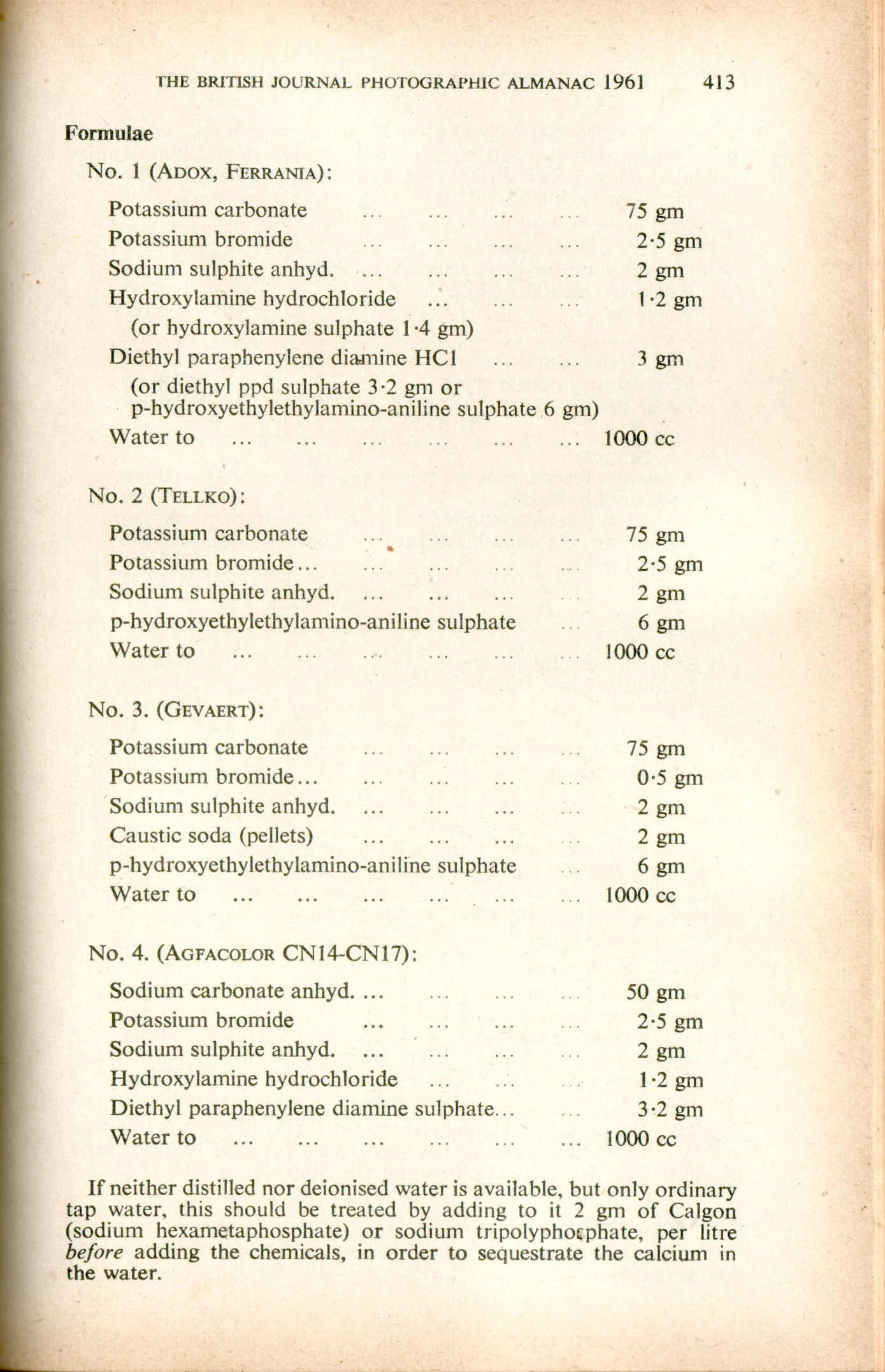

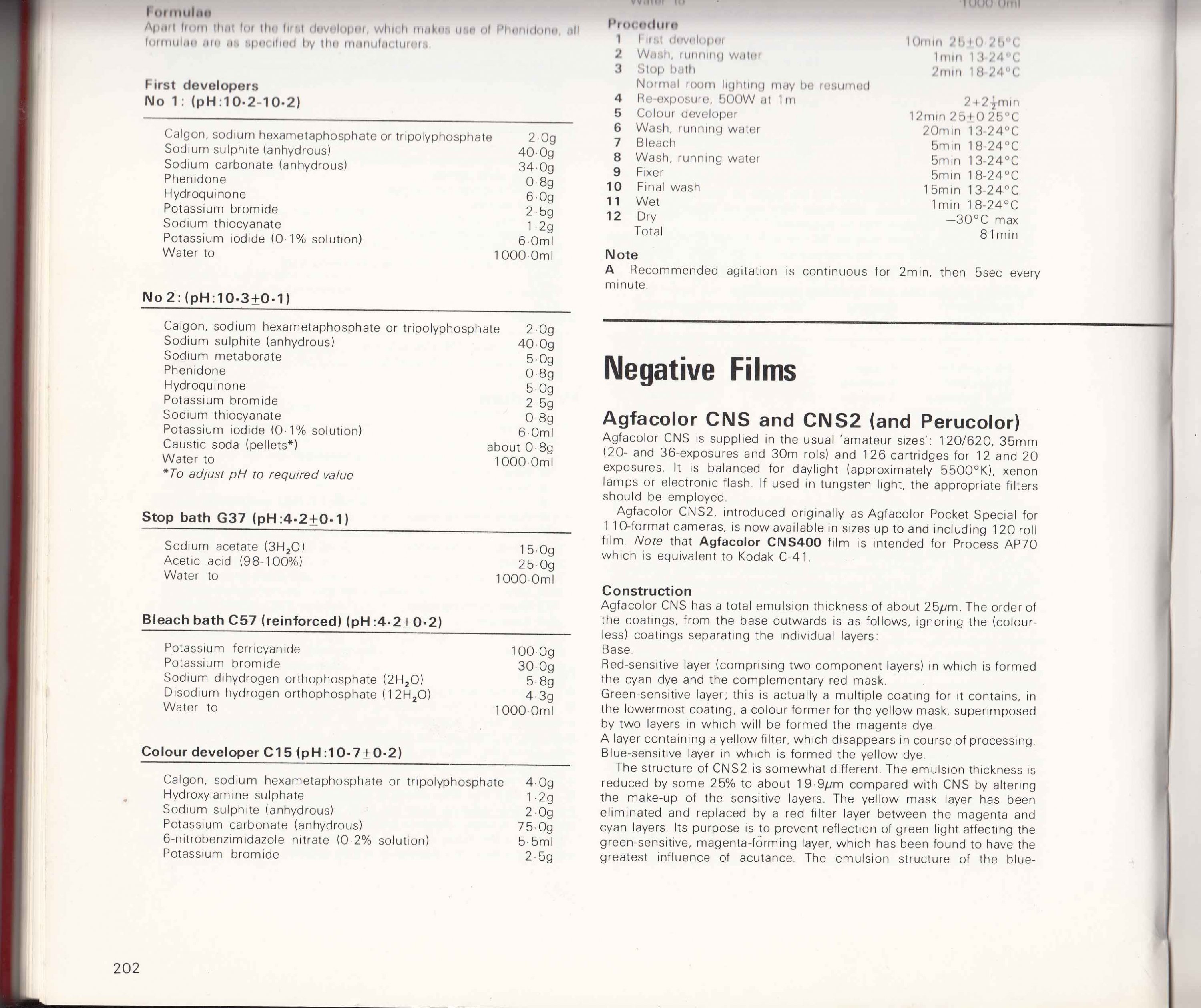

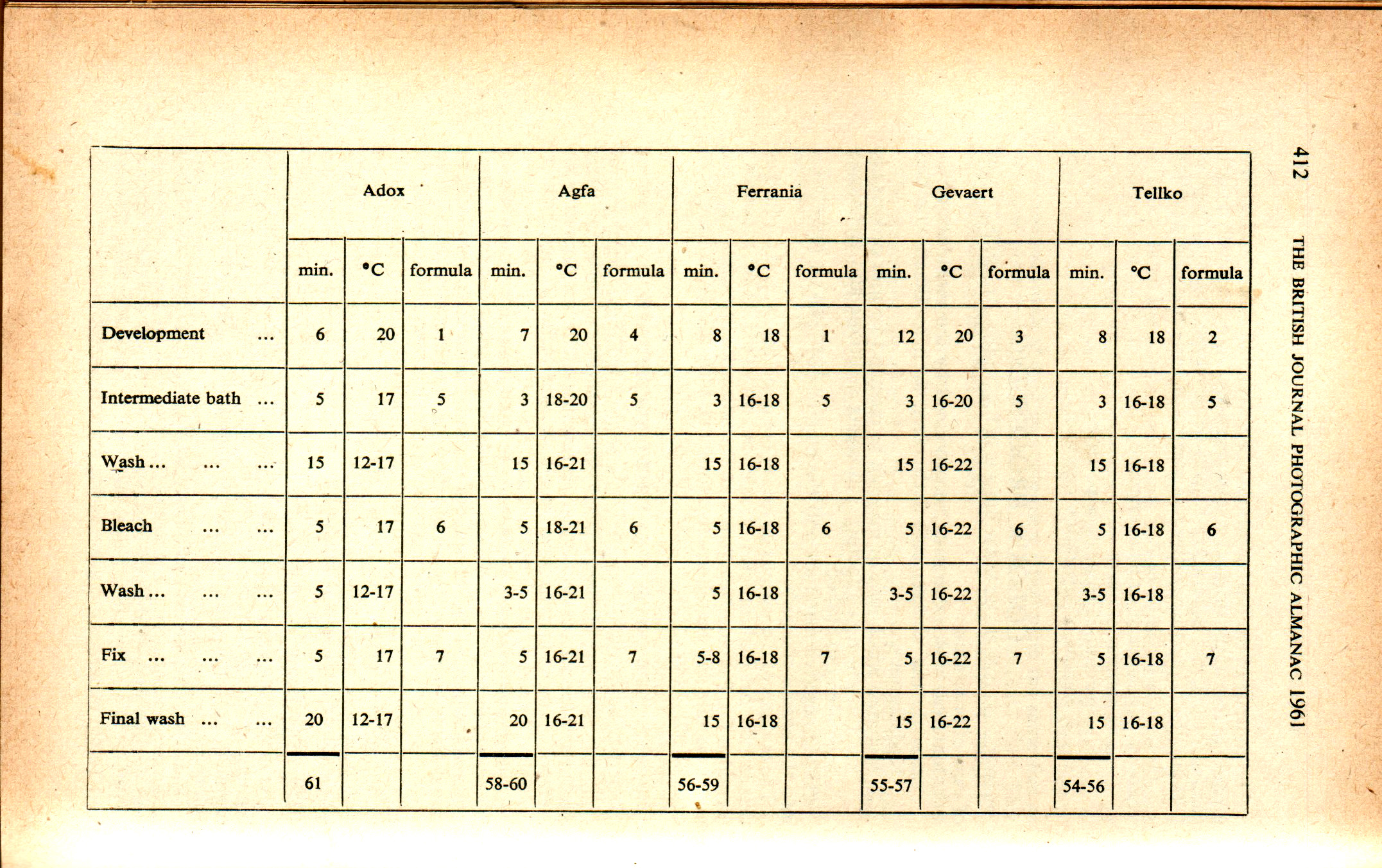

Here are the formula from the British Journal Almanac, 1961.
Brian P
Brian P
Thanks. You're kinda tempting me to try it with the next batch. Then again. I'm not sure I'm ready to invest the time and the effort, and I haven't tried out the low-temperature C41 process yet.

Well, so far I have to report that I have lost two films attempting to reconstruct the 20 degrees centigrade 50-minute C41 process with CineStill two-bath developer instead of Tetenal as was recommended by folks who'd tried it with results. My two films came out an even transparent brown. At least when I tried to develop one in b/w chemistry, I got actual results (the quality was poor, but you could still see the frames and the shapes on them. CineStill didn't do the trick. I don't deny the possibility I might have done something wrong, but I'm fairly sure I followed the instructions to the letter—only using different chemicals.
At any rate, that Agfa recipe posted above is beginning to look more and more promising. I could probably find a local chemist and custom-order myself a batch. Thanks once again.

Right. So I've checked the local chemicals and reagents vendor, and the only thing missing from the British Journal Photographic Almanac recipes is Diethyl paraphenilene diamine, ditto diethyl ppd sulfate, ditto all the aniline-based alternatives. Any idea of what a viable substitute might be?

Oh, absolutely, I'd be delighted! Well, I have a bunch of expired Agfacolor CNS film sitting in the fridge. I was going through the recipes from the British Journal Photographic Almanac, I've already established that I can source everything but the mystery aniline-based component from a local vendor; my knowledge of chemistry is poor, but I have a hunch I could use Metol as a substitute for diethyl paraphenilene diamine/diethyl ppd sulfate (I'd still love someone to confirm that it's a valid substitute). I'd love to take a look at your version. Maybe try out yours, maybe the other one with Metol, maybe both, I have a bunch of film, as I've said… I'm definitely not going to offer any negative commentary; besides, your pictures speak for themselves. How serious am I? Serious enough to buy the chemicals, once I establish which ones I need exactly (I was thinking of using the Ferrania bleach/hardener, for example), and to muck about with mixing them and trying them out. Is that what you'd call a sufficient level of dedication? :smile:

You need a dedicated developing agent. The various designations for same agent may be confusing though.
In any case you need a Paraphenylenediamine-derivate, which Metol is not. Some earlier european films even seem to have worked with two different derivates. Of the apt derivate then it seems of lesser importance whether you got the Sulfate or Hydrochloride salt.

I've checked, and they have ethylenediamine dihydrochloride and N-(1-Naphthyl)-ethylenediamine dihydrochloride… Would either of those work?

Okay ,,
First you have to get any color development agent, and the rest of the items can be easily fetched one way or the other.
You can first buy any of these items, (CD4) or (CD3) or (CD2)..
For example,,, A friend managed to get this item from eBay.
Regarding PPD, yes it can be used but it will not give you good results at all. A colleague from Ukraine did tests on it and it didn't work and the results were not convincing at all.
I will send you a private message..
