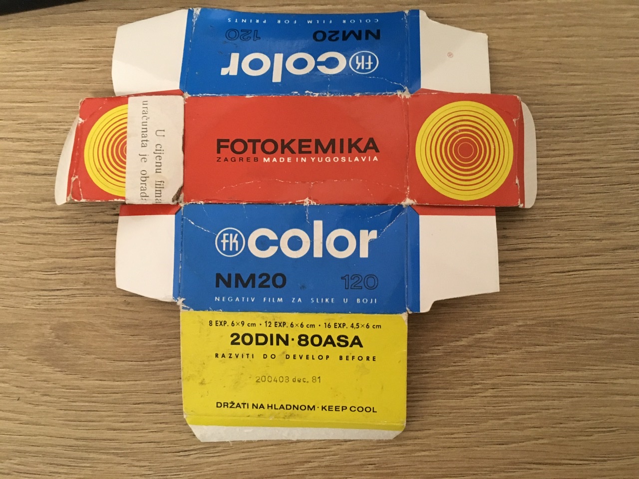

Sooooo… If I forego the stabilising altogether, will I have enough time to scan the bloody things in 3200 dpi/48 bit? Technically, all 80 rolls (with two more films from the same age, another Agfa and a Yugoslavian one) are part of one big experiment, and if I had to do a tradeoff between sourcing formalin locally and losing the originals in a few weeks to a month but keeping the hi-res scans, I'd go for the latter.

Colour, and also pre-C41, apparently.
