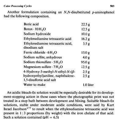

In case you haven't come across it yet, this site has some potentially useful information: https://www.photomemorabilia.co.uk/Colour_Darkroom/Early_Agfa.html#anchorAgfaCN3108.
It would seem that Process 92 papers were compatible with the Kodak EP2 process. I am pretty sure that the instructions you mention erroneously refer to "E2" instead of EP2.
For optimum results, you should probably look for an EP2 or Process 92 formula and mix the developer yourself.

It seems you are looking for process EP2, indeed. I found this finished auction on eBay. The packaging says Agfa Color Process 92 - EP-2 compatible:
A few months ago I bought the photo recipe collection by the late Udo Raffay of CG Chemistry. It's originally from the 1980s and was sold out then. Since 1992 they are selling a computer printout. I was curious about it.
Anyway, it contains two suggested recipes. They are not the original Kodak recipes, but will probably work well enough. One is using CD4 colour developer, the other one CD3. My guess is that EP-2 originally used CD-3, not CD-4. So I would suggest to use this recipe:
Water (30°C) 850 mL
Photo-Calgon (probably Sodium hexametaphosphate) 2 g
Hydroxylamine sulfate 2g
Sodium Sulfite, anhydrous 2 g
Potassium carbonate (I guess anhydrous) 30 g
Potassium bromide (I guess anhydrous) 0.4 g
Benzylalcohol/Diethyleneglycol* Mixture 1:1 30 mL
6-Nitrobenzimidazole * HNO3 (nitrate), 0.3% solution in water, antifoggant 7 mL
CD3 (Colour Developer 3) 4.4 g
Water to make 1000 mL
Further comments extracted from Raffay:
Adjust pH to 10.1 - 10.2. Use 10% sulfuric acid, or 10% NaOH (or KOH), respectively, to adjust. If you are making your own you can also play a little with pH to adjust gradation, if desired. Higher pH -> harder gradation.
Benzylalcohol aids colour brilliance. A higher amount of it also, supposedly, increases colour intensity somewhat. As does an increase in CD-3.
Diethyleneglycol (HO-CH2-CH2-O-CH2-CH2-OH) helps dissolving Benzylalcohol and, according to Raffay, helps with more even development in colour and b/w processes.
If you make concentrates for dilution before use you should keep CD3 and also the Benzylalcohol/Diethyleneglycol mixture seperate and add before use.
Raffay suggests to use C41 Blix diluted 1:1 for the bleach fix stage.
Process step 33°C 38°C
Colour development 3,0 min 2,0 min
Stopp bath 30s 30s
Bleachfix 1.5 min 1.0 min
Washing 5 x 30s 4 x 30s
My own thoughts:
I do RA4 printing and I wash RC paper, both colour and b/w for 2-3 min in running water in the wash slot of my slot processor.
I don't use anti calcium agents (Calgon) when I make up my own photo solutions, instead I use deionised water.
As a stopbath between dev and blix I strongly suggest to use TS-7 from the film developing cook book. 2% acetic acid works only when always used fresh. The neutralisation curve of weak acids makes them useless for much more than one-shot use.
TS-7 is a buffer, which also means high salt content, which helps keeping down swelling. I make mine from 60% acetic acid (110mL) and 23.5g NaOH in 1L water. That way I don't need to buy sodium acetate. It has higher activity than dilute acetic acid, and higher capacity and keeps pH for a long time. Also a much film/paper friendlier pH than fresh 2% acetic acid.
Raffays recipe for C41 blix. The one which he suggests to use 1:1 for EP-2. But if you can buy RA4 blix I guess that should work?
Water, 50°C 300 mL
Ammonium-Fe(III)-EDTA Solution, 50% 230 mL
Ammoniumthiosulfate, 60% 345 mL
Potassium metabisulfite (see comment below) 26 g
Water to 1000 mL, pH 6.5
I'm not sure about the Potassium metabisulfite. As far as I know you don't want Potassium ions in fixer. Maybe Raffay wasn't aware. I'd use an equivalent of Sodium metabisulfite. It is acidic and brings the pH to 6.5.
If you require a source for (photo) chemicals, Foto Suvatlar (CG Chem) in Hamburg has all the special chemistry. I also bought Raffays 'book' there. After all Raffay worked there. Let me know if you want to contact them and need their contact or help.
Let's suggest a very cheap and respectable Blix formula, one that I personally use with movies.
The last two things I don't add as I use a cleansing bath before using Blix.
This is a very cheap, very practical formula that will last you a very long time if you use deionized water
It seems that today is your lucky day, French man. By the way, I'm a fan of the respected Alpine Team Ocon Questionnaire driver.
