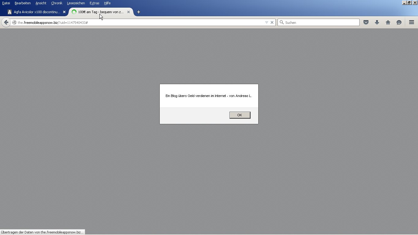

This is what opens in my browser (firefox 38.0.5) when I click the link in your message to www.stereopan.tk (it redirects to a different site each time I click the link, all of them fishy)
