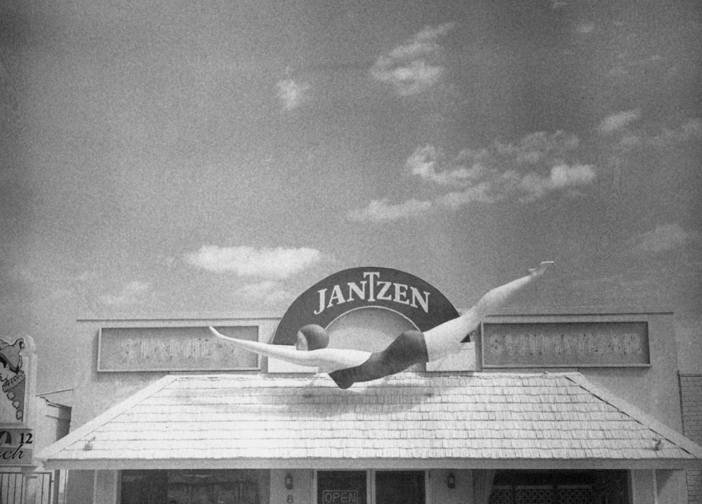

This example probably isn't what you're looking for, but it's sorta interesting. When I first started developing I was getting all sorts of odd looks. Now, unfortunately, I know what I'm doing and cannot replicate those earlier "mistakes". It's a pity, as some of the earlier stuff had an old look to it that I liked a lot.

if you want mistake and old look that you will not be able to repeat (again) - take some old expired B&W film from ebay, some old box camera and develop semi-stand in Rodinal 1+100 for one hour :wink:.
Joke on the side - what method did you used before (lens, film, developer...)? Maybe we can help :smile:?
