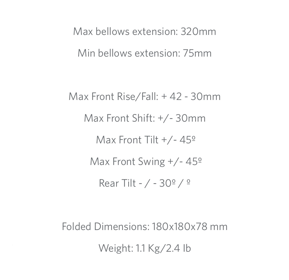

One thing that bugs me is that it looks like the Intrepid mk4 that I previouly taught I would buy seems to have more room on some movements than the Chamonix 45F-2. Here are some specs. If anyone can comment on this... (second one is the Intrepid mk4 of course)
