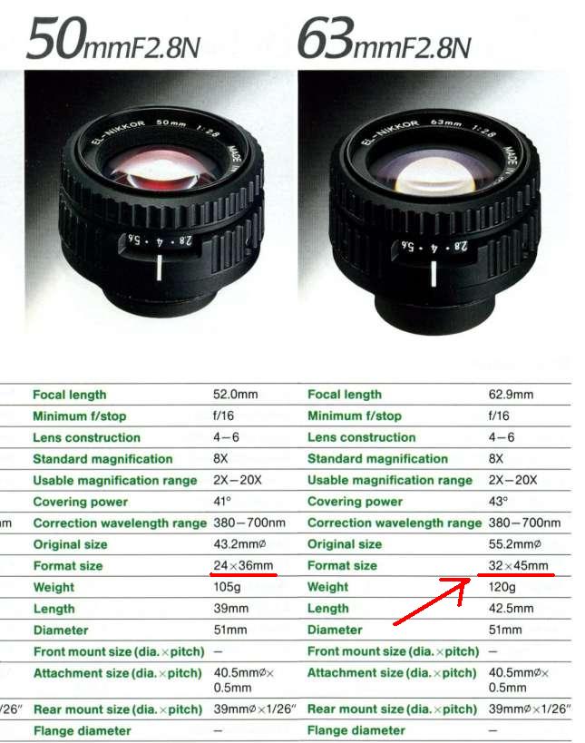

The 63 El Nikkor was designed for 35mm format. Longer than the "normal" 50mm will give more even illumination toward the corners. Nikon's flagship lens for 35mm was the 105 Apo El Nikkor, which cost twenty times as much, and was too heavy for most amateur enlargers anyway. But it could be used for MF too. Total overkill for most printing purposes.
Originally the 63mm lens recommended format was 32x45mm, not 24x36mm , in more recent catalogs is recommended for 24x36mm for obvious reasons. (some formats were mostly defunct)
https://galerie-photo.com/manuels/el-nikkor-enlarging-lenses.pdf
They were just basing that on the diagonal of the film, as an ordinary convention. Going somewhat longer is almost always advisable unless column height is too restrictive to allow that option.
