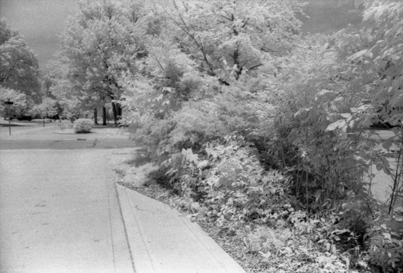

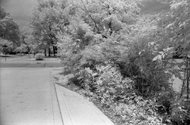

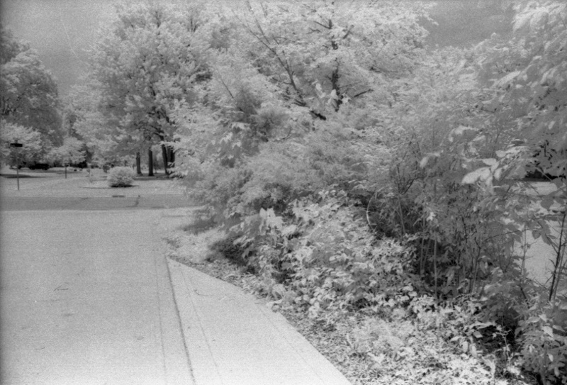

Thanx again for all the input. I exposed a roll on 7.05.14, using a tripod and bracketing my exposures, and finally developed it last weekend. I really like the effect, and think I'll have fun with it.
I'm not good at scanning, and intend to wet-print sometime, so I used a borrowed Epson 2580 I let the scanner do it's own thing with adjusting levels. I re-sized to 800 pixels wide to not take up too much space, and did no other adjusting - just quick-and-dirty scans to get a look at photos.
Rollei Retro 400s using an Hoya R72 filter (except the first exposure).
Developed in HC-110 dilution D for 8.125 minutes @ ~ 68^ F.
Here are a few examples looking down my driveway:
F8, 1/250 second (no filter)
attachment.php
The above is my baseline, set at ISO 400. I'm not sure if it needed more exposure, or if it's the scan (or my processing).
F8, 1/4
attachment.php
F8, 1/2
attachment.php
F8, 1
attachment.php

Not bad, Truzi. Not bad at all.
Pretty damned good if you ask me, great result.
Looks like the one with a good effect as well as some inherent sharpness of plants and things, is the 1/4 of a second exposure, perhaps one at f/5.6 1/8 may be almost optimal for effect as well as detail in stuff that moves, like leaves and things.
