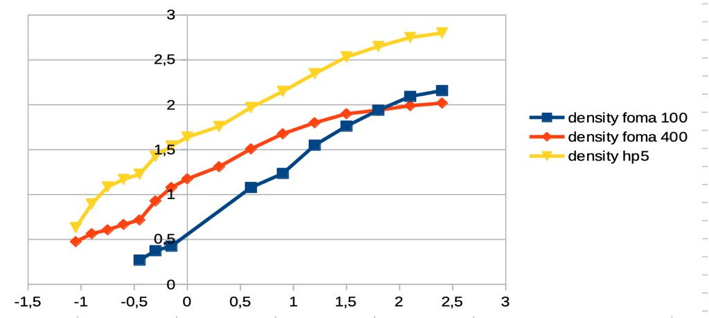

This time my main purpose was to check if my HP5 time for pushing it to 1600 is fine for next developments. But then I got idea that hey, lets add some Foma to the same batch. So everything here exposed + developed the same. I changed the exposure scheme on my device so that bottom half is exposed with half stop interval and upper part is as previously, one stop apart. That is 0.15 and 0.3 for you logaritmic lunatics :wink:
All are exposed at same EI 400. That is the step 8 is at 18%. Yes I know Foma 100 isn't ISO 400 film. (neither is Foma 400)
Developed XT-3, time 20 minutes (I know) and agitation every 30 seconds.
The results again look a bit strange. Foma 400 seem to be behaving very badly, could this be correct? I haven't done any other analysis because I (again) start to question my measuring methods :smile:

I remind separtely: all strips exposed at EI 400.
This causes Foma 100 to have more longer shoulder previous graph because it is getting two stops more exposure. That is wrong. I feel a bit bad for Foma 100. So that is why I corrected just not to bash Foma 100 too much.
And of course Foma 100's contrast is increased quite a bit because of that excessive development.

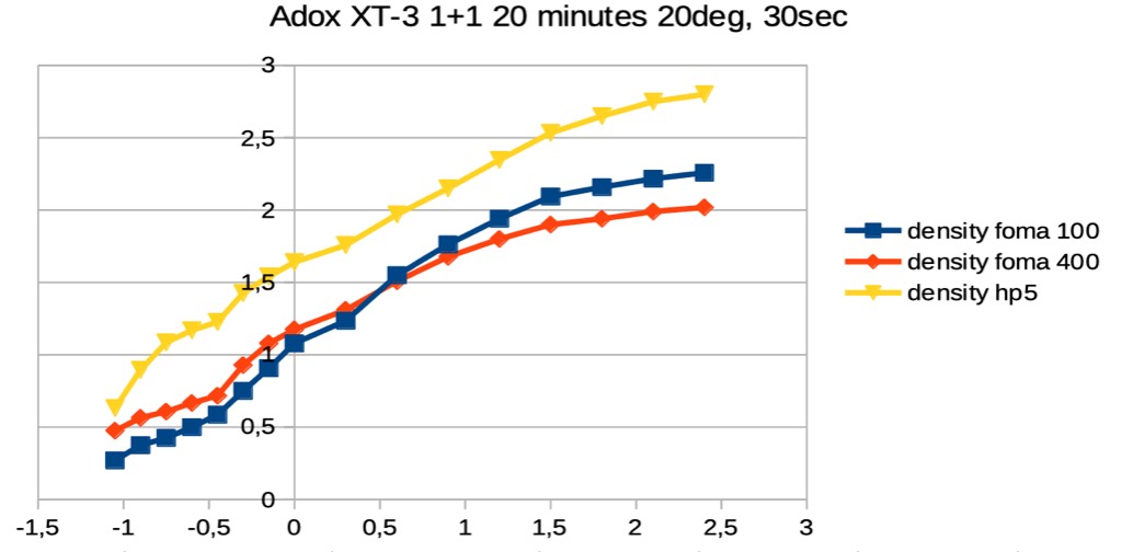

Ok, new tests.

Yes one can see Foma 400 + XT combo awfulness in my graph without any number crunching. Low contrast in genral and highlight compression kicks pretty early.
Is such small difference in my graphs (between Foma 100 and 400) because there is actually just 60-80 ISO difference (0.7 to 0.85 stops) to Foma 100 in real ISO?
Foma 100 tends to actually be closer to 125/160 in XTOL, and 400 tends to be more like 200-250 in XTOL. Others have speculated that they're actually the same film. I don't think that's the case, but they are very similar in a lot of other aspects.
Well, from my (single) test you can see answers to both; not the same film but very similar. I mean amazingly similar. I really expected they are more different.

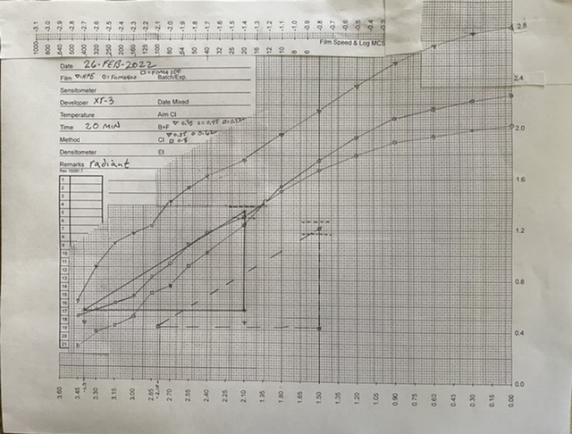

Show of hands for those who say Foma 400 isn’t a 400 speed film. Is that everybody?
@radiant developed in XT-3 for 20 minutes. That’s the developing time which made that Foma 400 hit within tolerance of the ASA triangle.
Foma 100 and HP5+ are far overdeveloped in that same run, they reached CI at or above 0.80
You are seeing the correct normal developing time for Foma 400 and time for pushing Foma 100 and HP5+

@radiant showed that the time to develop Foma 400 to ASA specifications is the same as the time to push Foma 100 to practically 400.

Thanks again Bill for plotting it out. I need to learn do the same, I was thinking of some javascript-tool which would do that from the data. Your graph is a bit low on the resolution btw, it is just about readable of course.
Foma 400 at ASA triangle with that time? Wow, that wasn't anything I expected. I'm glad I added some Foma in the same batch! Now we know how to develop Foma 400 in Xtol :smile:

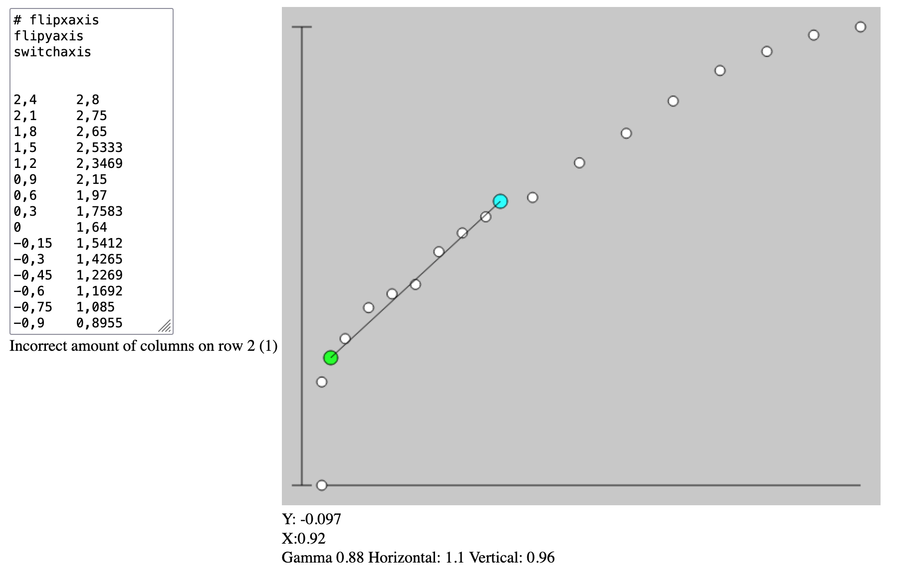

I made this kind of graph tool which could be extended for characteristic plotting / analysis. All code done by me so easy to add features. Any ideas?
Try clicking on the graph, you get the line tool. It shows some data below the graph.
https://jouni.kapsi.fi/filmgraph/
