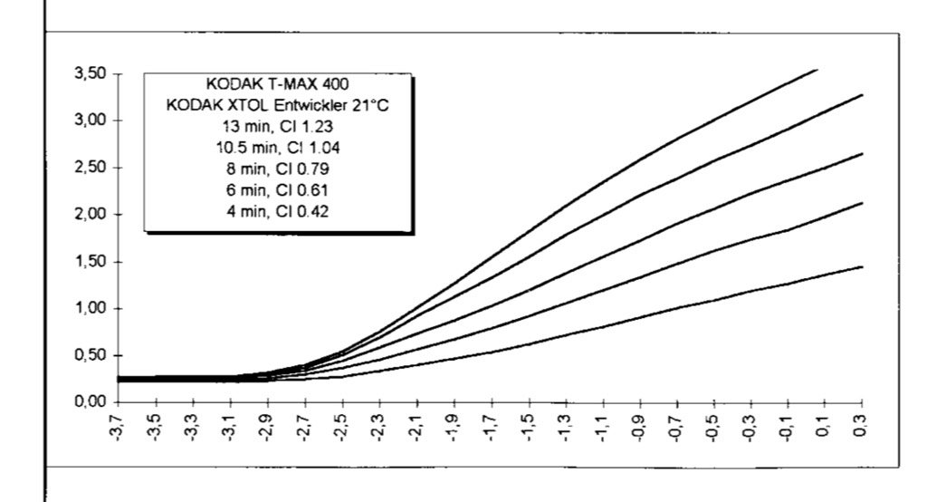

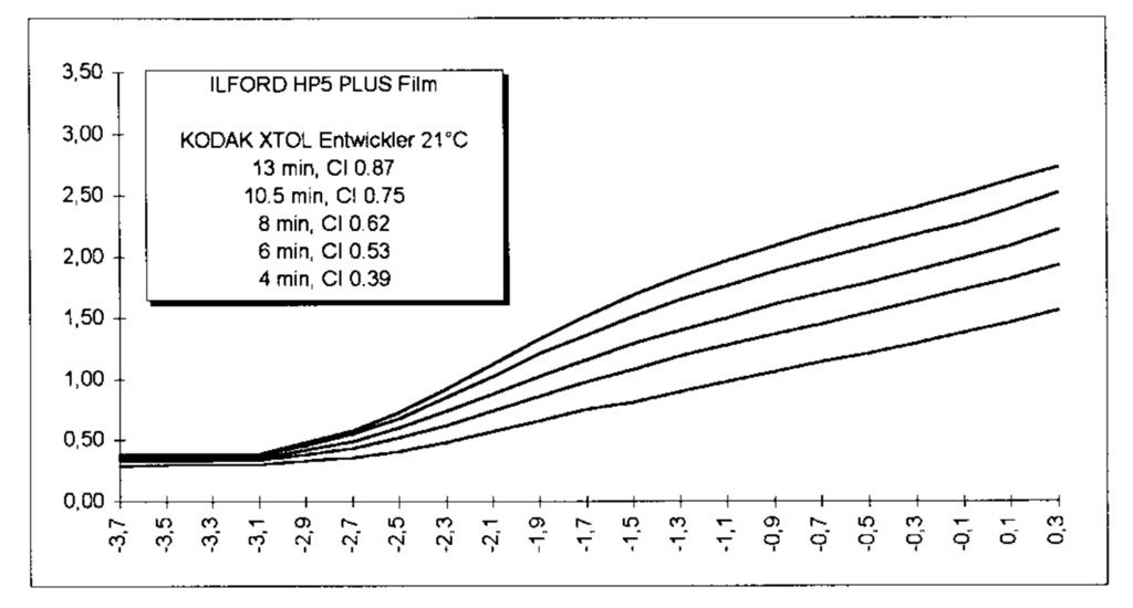

Yes, that is the German version of the very detailed original Kodak XTOL data sheet I have mentioned above.
Best regards,
Henning
From that datasheet you can find characteristic curves in real life units. I wonder why manufacturers cannot publish such things. Maybe to get away with manufacturing variances?

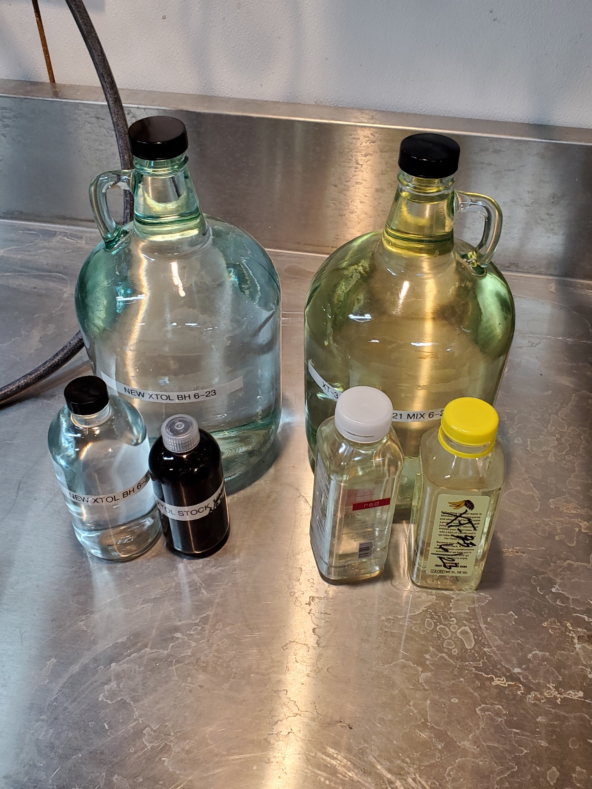

QUESTION about XT-3. I purchased 5L package in October of 2021, mixed it today June 11 2023. Dissolves great, no dust. I have noticed a tint, yellow brown color in the final 5L batch. Is this normal, something I should be concerned with??
I mixed up a 5L of Kodak brand XTOL, I just received from B&H (June 2023) made in USA, it's clear and like the original USA made XTOL, there's a few milligrams of junk that doesn't dissolve even with a propeller mixer.
Trying to understand if this is a shelf life issue with the XT-3, normal, anything I should be concerned about????
Best Regards Mike

I have XTOL but clearly Kodak branded chemistry has been.....confused of late. I don't know why the XT-3 is colored. The powder has been stored at 20°C since I purchased.

This color is normale after several years of storage and the product should work perfectly as expected. This is no difference between our version and other versions of this devloper. It is typical for an Dimezone-S / Isoascorbat replenishing developer system.
