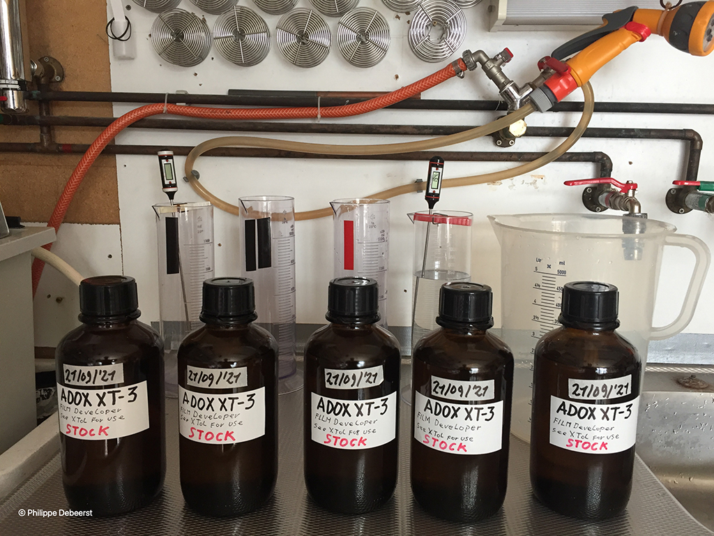

The ADOX XT-3 5l pack arrived this morning, it's mixed and cooling a little, now I can finally try it out...

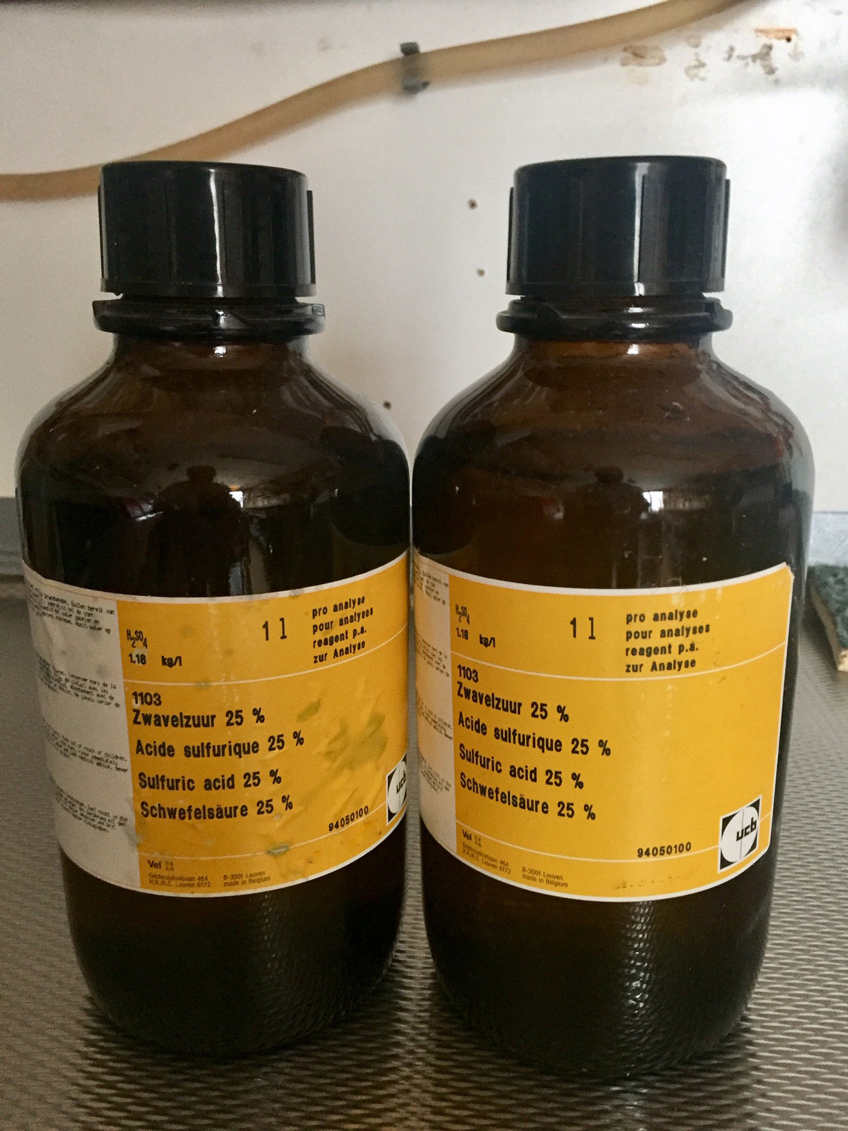

I've got that exact same graduated pitcher. I found it used on Ebay, invaluable! I like your bottles, where did you find those?
Good Morning Mshchem,
In these bottles the 25 % sulphuric acid came I needed to balance the pH value of the chromogenic developer of the E-6 process.
I treasure them as they are wide neck and thus easy to fill and to pour, have good caps, and made of strong thick glass.
I have seen this kind of bottles on the net, there is a Dutch webshop supplier who delivers easy to handle small quantities, by the dozen, but not very affordable and the glass is rather thin...
The graduate pitchers, of all kinds, are easy to find in kitchen supply hardstores, and as they are made for containing food the plastic is rather 'inert', and of a lesser cost than lab hardware...
