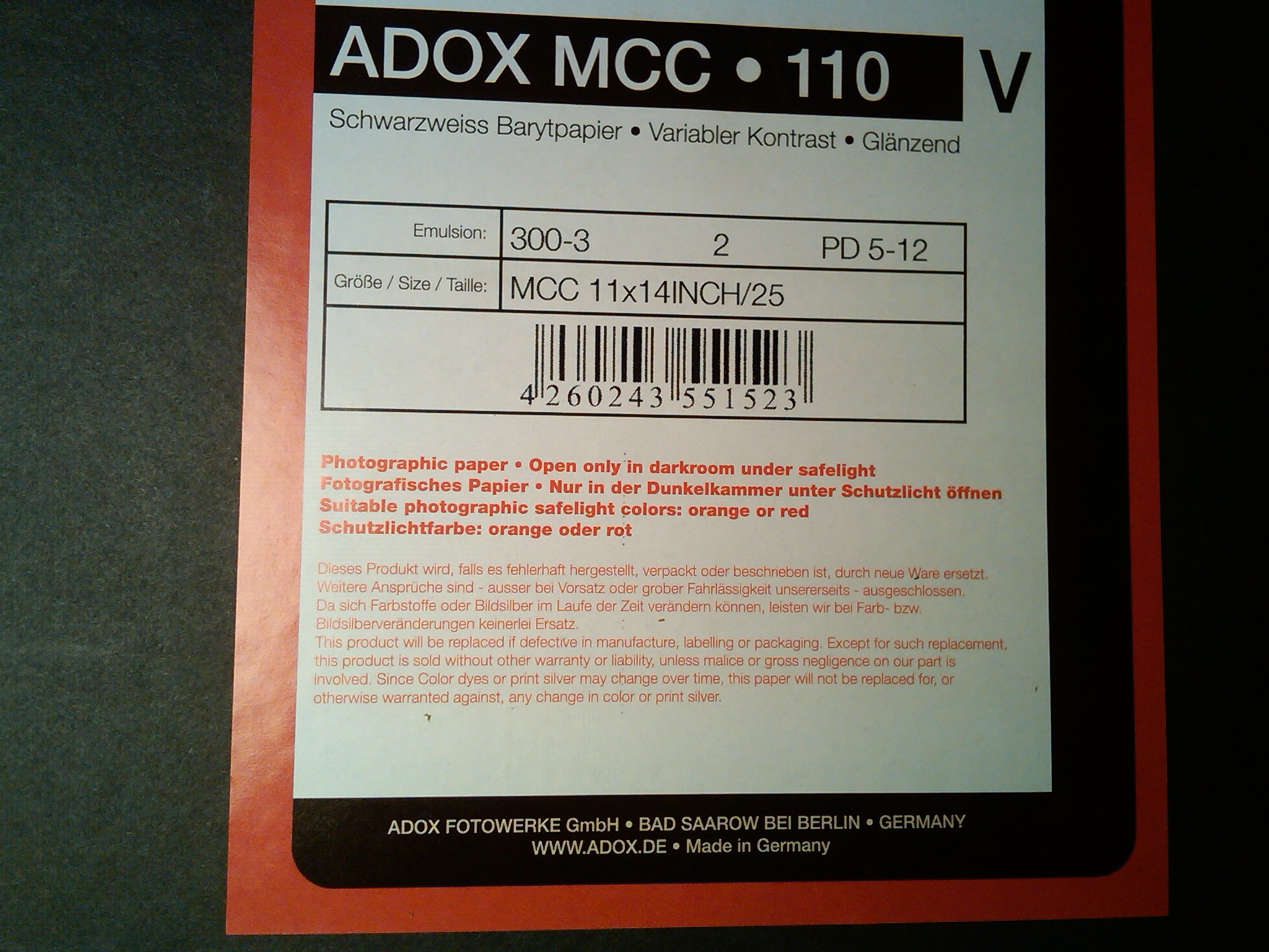

would it be possible to post an image of the label?
The information seems odd and does not match our records thus I cannot look up the batch.
Or did you leave some numbers out?
In general: If the production date (cutting date) is May 2012 this means the coating of the paper can be as early as 2010 (it needs to settle for about 6 months at least and then it can take up to one year for a production to be fully cut). So we are talking paper which is now up to 5years+ old.
This paper will only give full contrast if it was very well stored. Contrast is one of the first parameters to be affected by aging.

ADOX MCC 110 V - emulsion PD 5-12
Thank you for the reply.
A photo of the back label is attached.
Best regards,
J P Jackson
I cannot look up this number in my system. It must be from before we implemented the production tracking numbers.
The typo and way the numbers are written do not match our current setup.

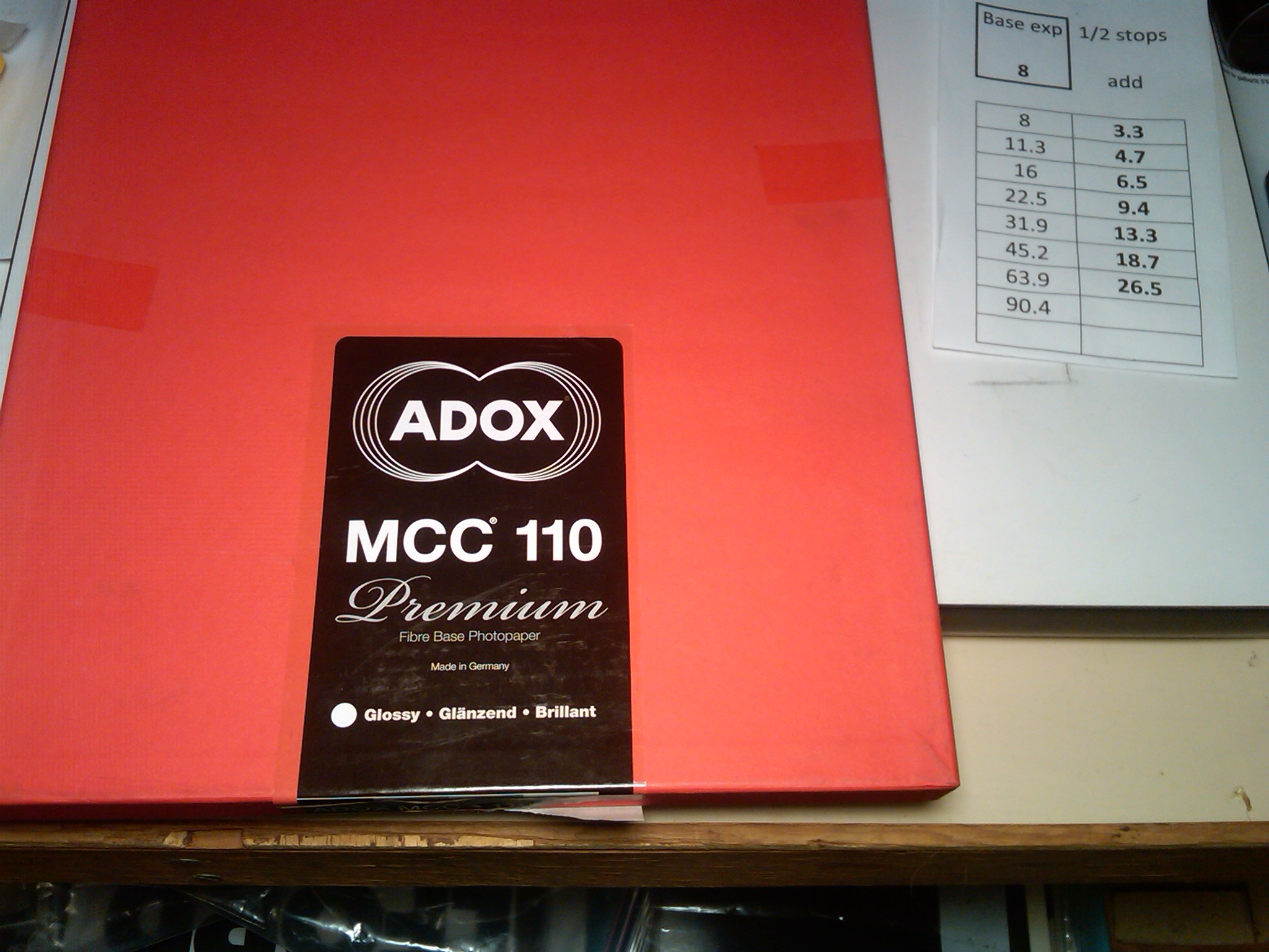

I have to walk to the file cabinet to persue this quest. Is the lid of the box red? I see a black back and red edges of the label so the lid should be a matt red.

ADOX box cover
Mirco,
Thanks for looking into this. A picture of the box cover is attached.
There is no apparent fog (B+F = .1). The paper has been stored in my darkroom at 68F and 55% RH since it was received in June of last year.
