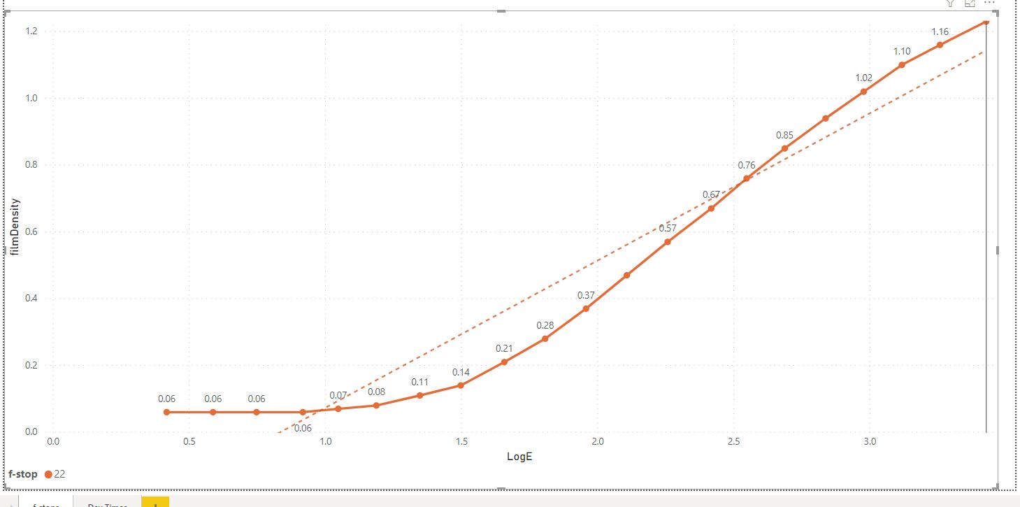

Anyone else using CHS ii with XTOL Replenishment (XTOL-R)? I just got 4 boxes of 4x5 and 10 rolls 35mm of CHS ii in woohoo! I've missed it since I ran out of my sheets a while back. I've been doing a bit of densitometry lately and found out that my original dev time (9:30) wasn't too far off. In 35mm, I get a gamma of 0.54 and CI of 0.53. At 11:00 I get 0.62 and 0.61. That seems pretty close! But, when I went to try calculating ISO (using Kodak's method in h740, the sensitometry workbook), I get an ISO of 25 since my speed point is a 1.5.
This seems low, especially for XTOL? My only other ISO calculations so far are with Pancro 400 and HR-50. I got 320 ISO for Pancro (at a dev time of 15:00) which does seem about right, and 3 for HR50 (at a dev time of 5:00) which also matches some test exposures I did though seems low as well. I'll be testing other films as well. I've done some testing of FP4 but haven't yet calculated ISO since I find it's easier to do when creating the graphs on pen and paper. I've included the curve I get (plotted using Power BI) for CHS ii at 11:00. I can scan my pen and paper one as well if someone wants to see it.
By the way, not knocking CHS ii at all - it's my favorite 4x5 film and am so happy to have it now in 35mm and 4x5! I'm just trying to work out if that ISO is believable or what I might be doing wrong there since I've typically been exposing it at box speed with some great results. ISO aside, it seems to work really well in XTOL-R for me anyway (though all my photos have been made on 4x5 to this point) and in general my darkroom prints have been rather straightforward. So I don't want to read too terribly much into things but being off by two stops did cause me to raise an eyebrow.
EDIT: Put my FP4 curves onto pen and paper and though the curve is a little too high to use Kodak's method, I went ahead and did the calculation (800 / Antilog(A) where A is the log at .1 above Dmin) and got 80. My exposure was probably a tad high so I might be a bit above Dmin as well, but 80 certainly sounds like the ballpark of where I would expect it to fall. I tend to like pulling FP4 to 64 so that sort of explains why. This makes me think my findings for CHS ii aren't crazy far off?
As an update, I both did exposure bracket tests where I took 7 scenes and bracketed between 12.5 to 200 ISO as well as shot a normal roll metered at 50. The short answer is I don't think my ISO calculation of 25 is correct. Practically it looks to be more like 80 for me. For the details:
For the bracket tests I used incident metering with 1 scene also using a strobe. The strobe scene is way off since the incident meter I think was perhaps seeing too much of the strobe relative to the composition. For that one, my best exposure was 12.5 and 25 was good - the others seemed too dark, though 50 ISO may be workable. 2 scenes were of portraits (my kiddo and our dog) and I think I like ISO 25 the best, though 50 was good. 100 was a tad dark. For the sort of regular outdoor scenes I found 100 seemed to look the best.
For my normal roll, I used my X-700 and metered on-camera. I found these to be good save for a few frames which were brighter than they should be and overall they seemed to lean a bit bright.
To judge these I made contact sheets of both rolls using a #1 filter (as I have a condenser enlarger) and Adorama's RC paper, which I have found tends to be a little contrasty.
My takeaway is that it feels like my ISO isn't the 25 I got when using Kodak's method even though the math lines up. Not sure what I'm doing wrong though. Pictorially the results I got were rather good - some frames had nearly perfect exposure and definitely a few frames I plan on enlarging. These results align with the results I was getting previously when I shot CHS ii in 4x5 (and rated at 100) - before I messed about with any of these curves.
4x5 will be different since I would largely be spot metering but tend to check the lights and darks and average them out. My graph shows a shallow shoulder, which I expected based on Adox's description of the film, and gives me what looks to be a workable range of 5-7 stops of mostly a straight line. I think for the first few shots I take in 4x5 I will do some bracketing just to see how my metering methods line up.
I did these same tests for HR50, although not quite as thorough, and I found my ISO value (of 3) in XTOL-R actually seemed to be correct. More testing is needing for that though since that seems awfully low. It's a film Adox recommends the HR developer of course so XTOL-R could just be a bad match for that film.
Not sure if these results are helpful to anyone but I wanted to be sure I did them so I can put my remaining 7 rolls of 35mm film and 4 boxes of 4x5 film to good use! :smile:
