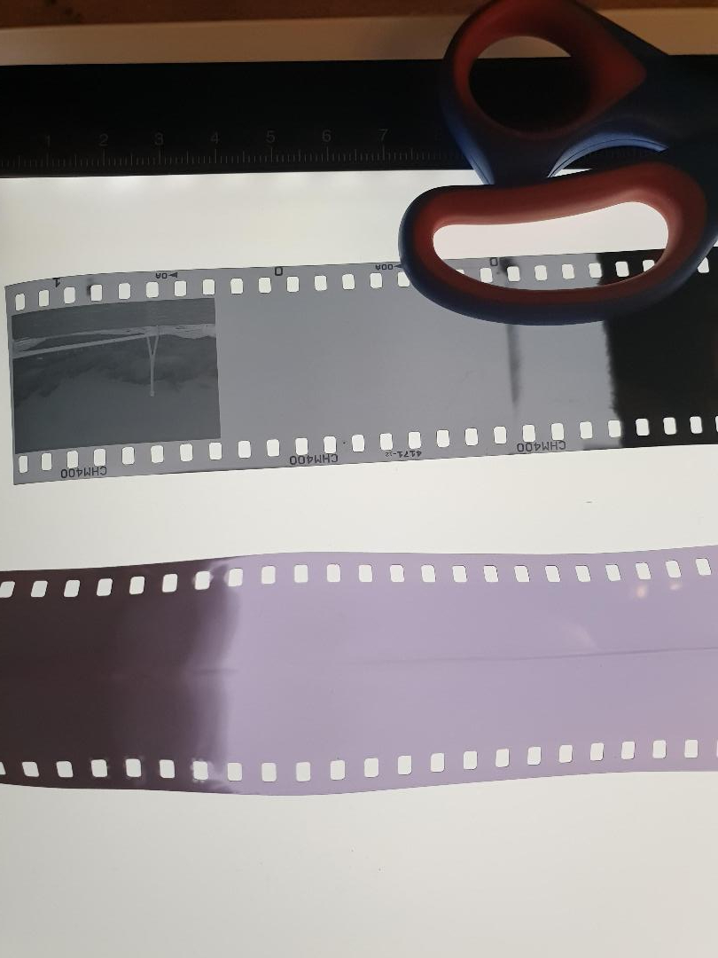

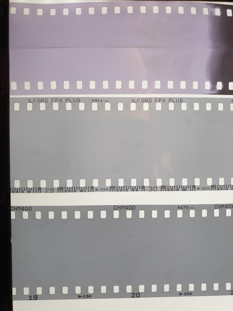

So, the test is done. Now I am thinking - this base fog is there, even on FP4+, that I did not noticed in the first time, probably because FP4+ has higher contrast.
Could it be that this is because of X rays in airport? Film did travel from Hamburg - Amsterdam - Kuala Lumpur - Brunei, and back.
I did used 3 different cameras (Nikon F100, Leica Minilux, Fujifilm P&S), all showing same results.
View attachment 261950 View attachment 261951
airport scanner certainly looking the culprit.
i think lesson here for all of us is - if you travel then do a clip test of leader in fixer first to test for fogging.

Well, I should avoid iso 400 if possible, on the end the films were not totally destroyed, still usable. Or I will also look for some X-ray safe bags - that could be the way to go.
X-ray safe bags
Bad news - they're not going to help. Firstly, they don't block enough xray to begin with with these new CT scanners. Moreover, if something quasi-xray opaque is encountered, the machine or its operator will bump up the radiation intensity to look through it anyway. Xray 'safe' bags are a waste of money and only weigh you down.

yes they just need longer development to compensate.
