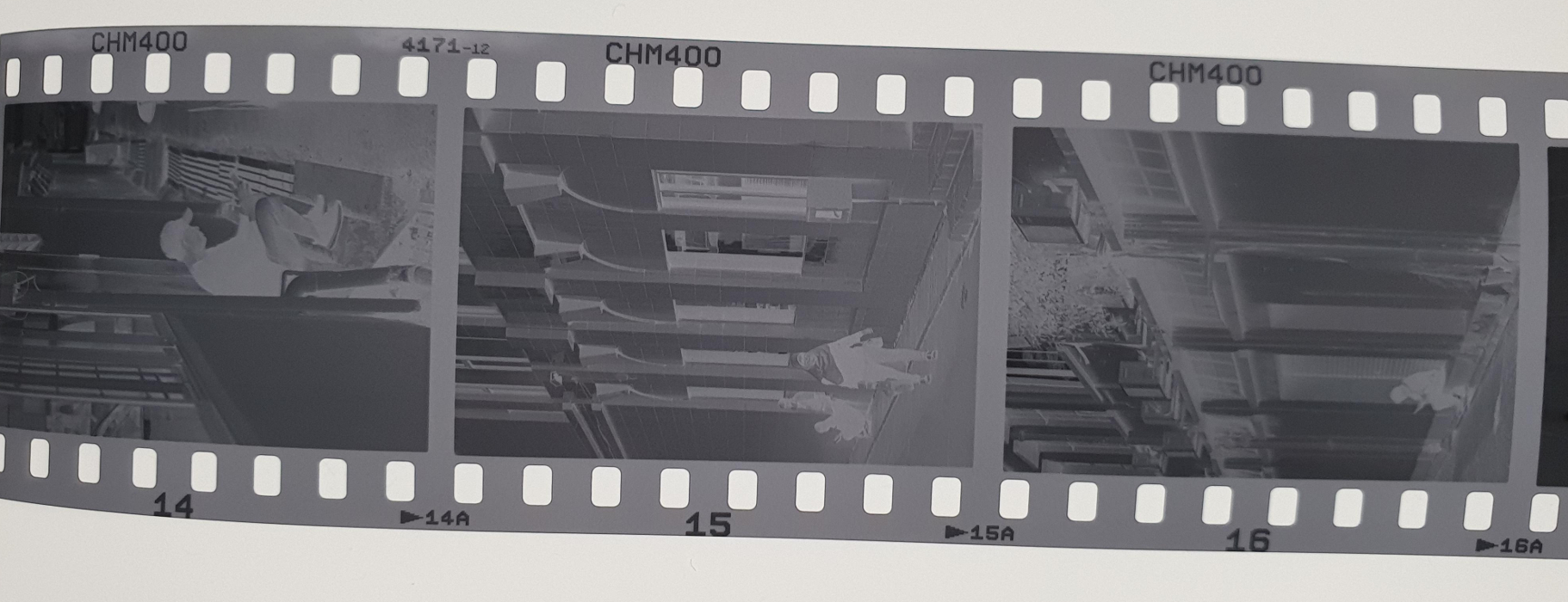

I developed some films that I shoot in Brunei, and Adox CHM 400 in Rodinal 1+25 has really low contrast. Rodinal and fixer are fresh (no issues with FP4+ and Adox iso 100 / they are developed great), I used Nikon F100 and Leica Minilux, in both cameras the same low contrast. Marks on the film are developed in full with nice contrast, base of the film is not PET clear, it is purple, fixing time 10min in 1+4 fixer. It was bright and sunny / very contrasty scenes. I used in darkroom filter grade 4 to get decent prints, but I am wondering - did other have the same low contrast with this film? On web I see much better results, so wondering... Developing time for 1+25 was 13 minutes, longer because of lower temperature in my basement (17 deg C) - devchart says 6min on 20 deg C.

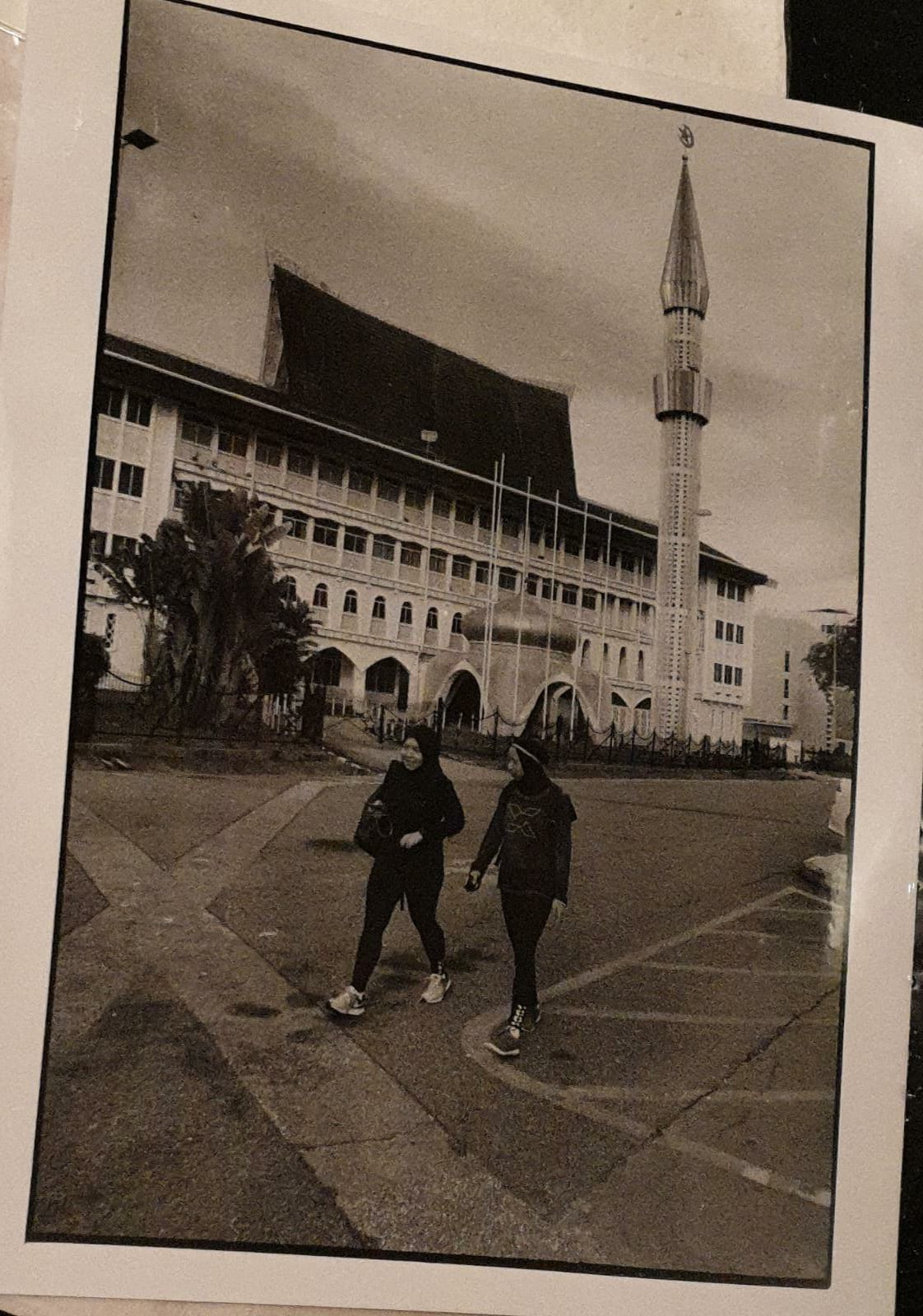

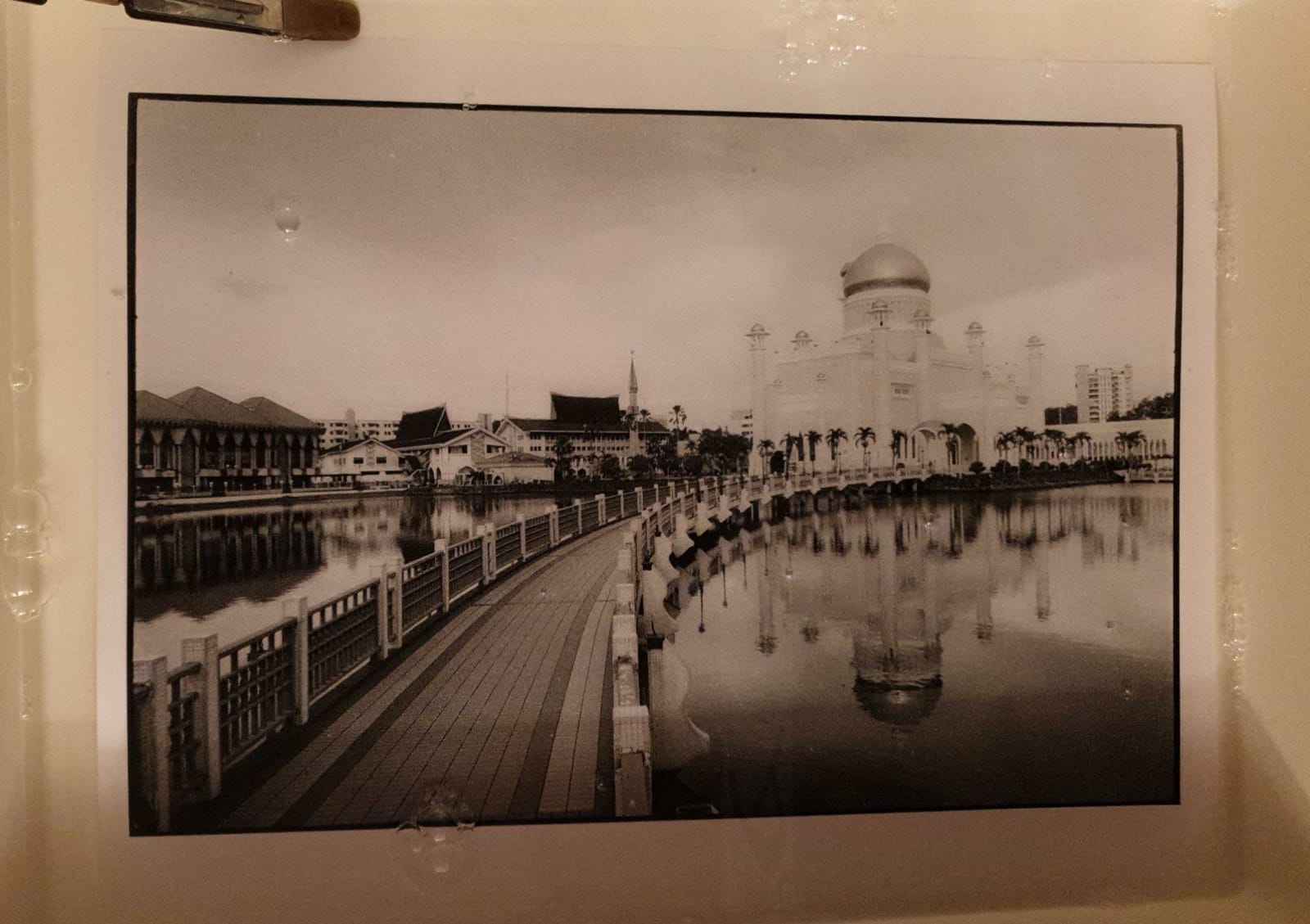

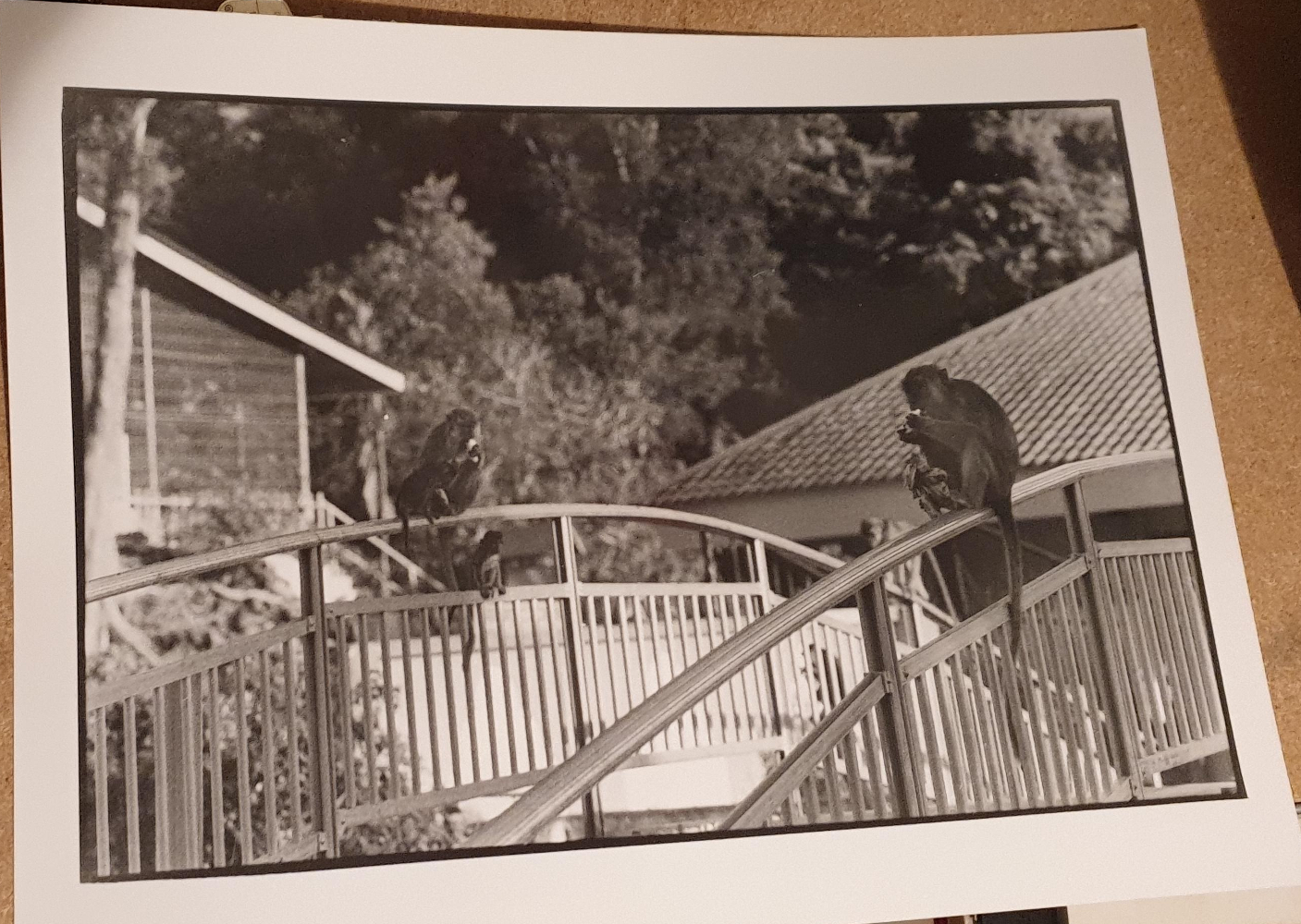

Here are 2 prints (shoot with smartphone, prints are still wet):
May we see the negatives?
To me, that looks like under-exposure.

The temperature might be the culprit. The datasheet im looking at stops at 18 degrees. If you started at 17 degrees for 12 minutes you could have seen a drop off in activity and temperature by the end of development. Ie it might have ended up 15 degrees or lower in the tank at the end of the 12 minutes and just too cool in there for the developer.

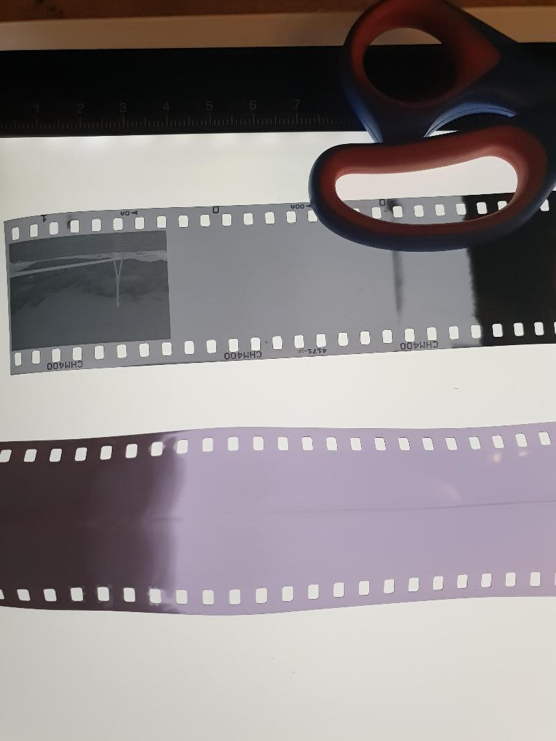

base appears to be perhaps a bit fogged
Yes, indeed. I wrote about base in initial post, but film is fresh, and I shoot like 8 rolls, in 3 different cameras. And I fixed with fresh fixer, for more than 10min.

@darkosaric This shot with the priest seems to have some fogging. The lower part of his clothes seem strangely light and so does the road on the bottom left part.
No, on clothes there was a water stain on a negative, and this is a cheap negative scan, that scans uneven. Print itself is good (after I have cleaned the negative).

Id be tempted to cut a small bit of exposed leader from another roll and throw it straight into the fixer and see if it clears.
If it doesnt then put a bit of exposed leader from a different brand in the fixer and see if it clears.

I will do that, I have 2 more rolls (purchased 10 rolls). I am guessing fog issue, will revert when done.

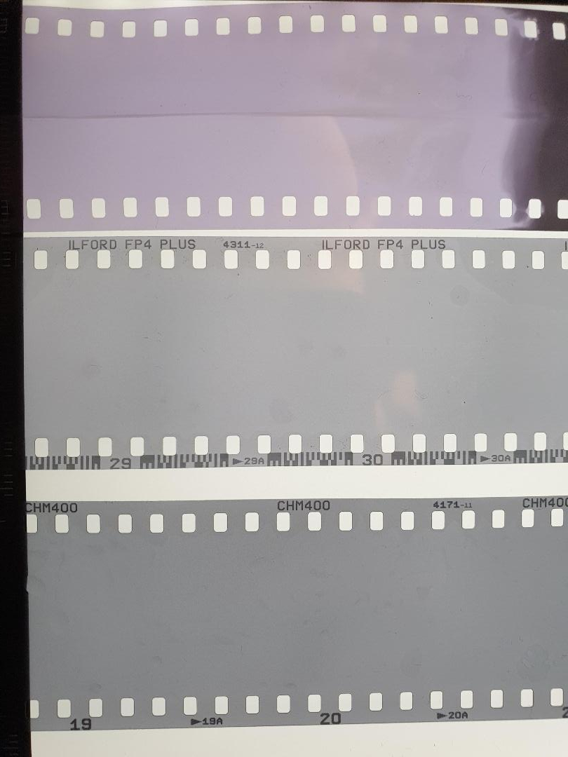

So, the test is done. Now I am thinking - this base fog is there, even on FP4+, that I did not noticed in the first time, probably because FP4+ has higher contrast.
Could it be that this is because of X rays in airport? Film did travel from Hamburg - Amsterdam - Kuala Lumpur - Brunei, and back.
I did used 3 different cameras (Nikon F100, Leica Minilux, Fujifilm P&S), all showing same results.
New machines at airports fog film. I think you have identified several things . Base fog from xrays, cooler than optimum processing, things start to get weird when you are out of the 20 -25°C range for black and white film. And the damned purple dye. I process on a Jobo and I run at least 3 minutes hypo clearing agent, after a 5 minute rapid fix on Tmax Delta etc films. In the photos you are definitely seeing base fog from something and the cool temps, I agree may be an issue.
