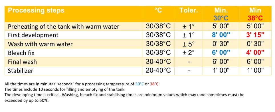

A few quotes from the ADOX C-TEC 41 DEVELOPING KIT user manual:
"Color development is not much more difficult than B&W. You can use ADOX C-TEC 41 between 24°C and 38°C - whichever temperature is the best for you to keep constant over the development time.
Lower temperatures are easier to control because they are similar to the ambient room temperatures, but the development time increases."
and second quote:
The standard processing temperature for C-41 is 38°C.
ADOX C-TEC 41 can be used at 38°C or 30°C.
(My note: inconsistency. First, they say it can be used between 24°C and 38°C, and then they say it can be used at 38°C or 30°C.)
third quote:
"The standard temperature for C-41 is 38°C.
30°C for home use is recommended, but with a rotary processor, 38°C can be maintained quite easily."

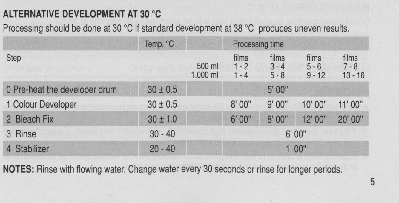

I usually read the manufacturer's instructions carefully and try to follow their recommendations exactly.
However, in the case of this C-41 kit from Adox, I don't recommend following everything in the manual.
First of all, they recommend rinsing for 30 seconds with warm water after developing.
Rinsing the film with warm water after the developer doesn't stop the development process, and not only the temperature but also the time is crucial here.
Perhaps with an 8-minute development time at 30 degrees Celsius, the extra 30 seconds of rinsing won't affect the development as much, but at the standard temperature of 38 degrees Celsius, overdevelopment will occur.
There was already a thread on this forum started by someone who used this kit from Adox.
He had problems with colors etc.. After using the STOP bath, these problems disappeared.
I also highly recommend converting the BLIX from this kit to a separate BLEACH.
As @Rudeofus mentioned here in his article:
According to Adox, BLIX is only sufficient for 16 films, and they don't recommend overclocking.
After a fairly simple conversion to BLEACH, this bath is enough to bleach about 50 negatives and can be stored for up to a year.
