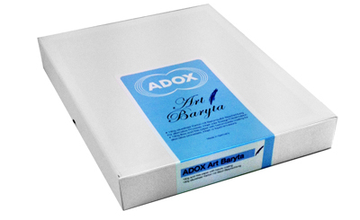

ADOX Art Baryta - now available.
ADOX Art Baryta is a chemically neutral acid-free paper base with 190g/sqm weight coated with a pure white Bariumsulfate-emulsion. Especially stabilized for the use with photographic emulsions or alternative processes. Also suitable for a coating with aquaeus dyes or dyes dispersed in oil. The bariumsulfate-coating enables bright highlights and keeps the coating from difusing into the paper base yielding higher sharpness and less consumption of the coated media.

what is the price and sizes available??
Best, Peter
Peter,
we made 8x10/100´s two weeks ago. Other sizes will follow.
The price is 29 EUR net.
You can buy it with Fotoimpex.
Once freestyle carries this item they will charge a similar price and you don´t have shipping to the US.
They receive samples now so it will take a few more weeks before the paper is available from Freestyle I guess.
