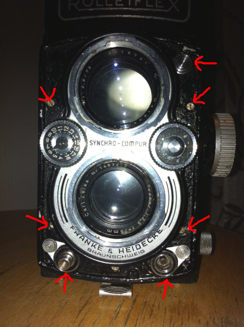

- Remove the leather and front-cover (4 screws) + removing the knobs for self-timer, shutter and m/x sync levers. (make sure you put the small parts in a cup or similar or they will get lost)

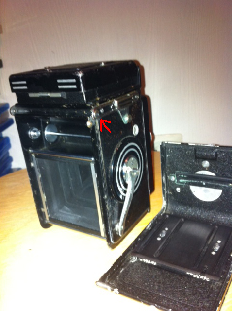

- Remove the lid that you normally open to insert film into the camera, completely.

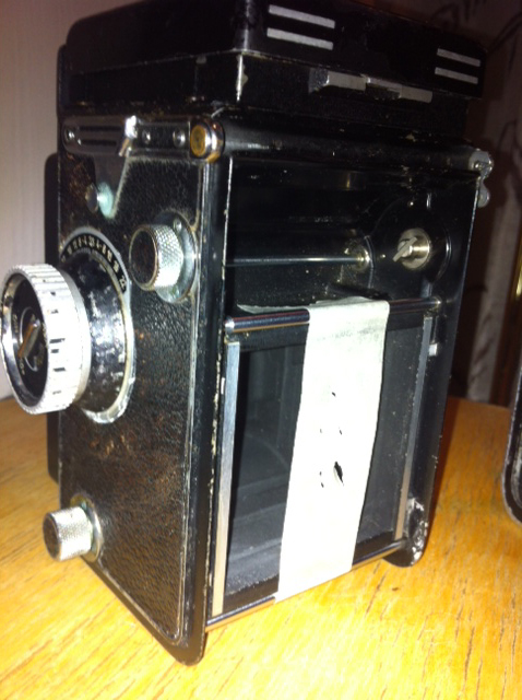

- Place a piece of masking-tape over and past the rollers that the film rolls over (you'll need 4-5 inches), so that the tape lies flat on the film-plane, where the film normally lies.
- Now, poke a few holes and irregular tears in that tape with a sharp object.
- Do the same with a new strip of tape, fold the tape back on itself about 0.5 inch on each end, poke some holes in it.
- Now, place that piece of tape on your viewing ground-glass (smack on the middle). (The folds you just made, makes it easier to remove it later).
- Use a strong flash-light, place the camera on a stable base, direct the camera towards a white wall.

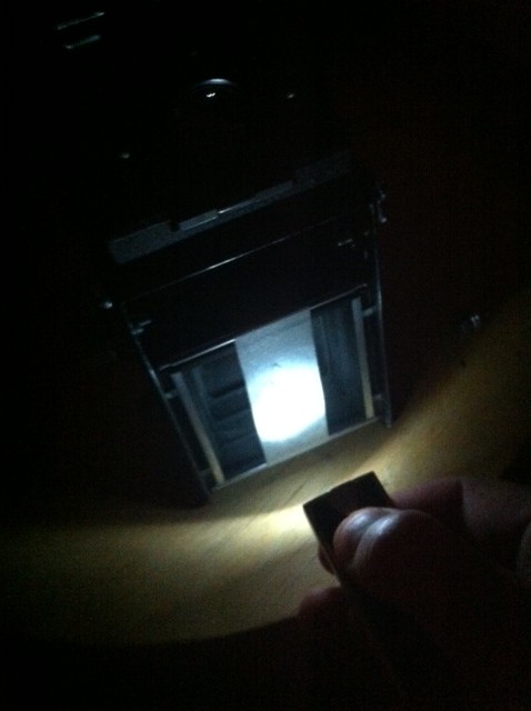

- Set camera to bulb, use a remote trigger which is able to hold the shutter open by itself.
- Trip the shutter, make sure the shutter stays open.
- Shine your flash-light into the camera from behind, adjust focus on the taking-lens via the focus-knob, so that you can see your tape, with the holes and small details clearly on the wall.

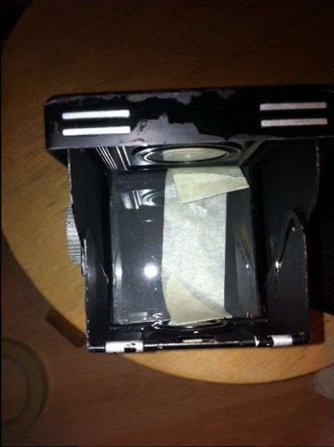

- Now shine your flashlight from above and down at your ground glass. You should see a new image on the wall. (albeit dimmer, as the focus-screen and mirror steal some light, hence you need a strong light for this)
- Loosen the lock nut and screw on the viewing lens until you get a nice, clear view of the tape on the wall, with all the holes and small details as sharp as you can get them.

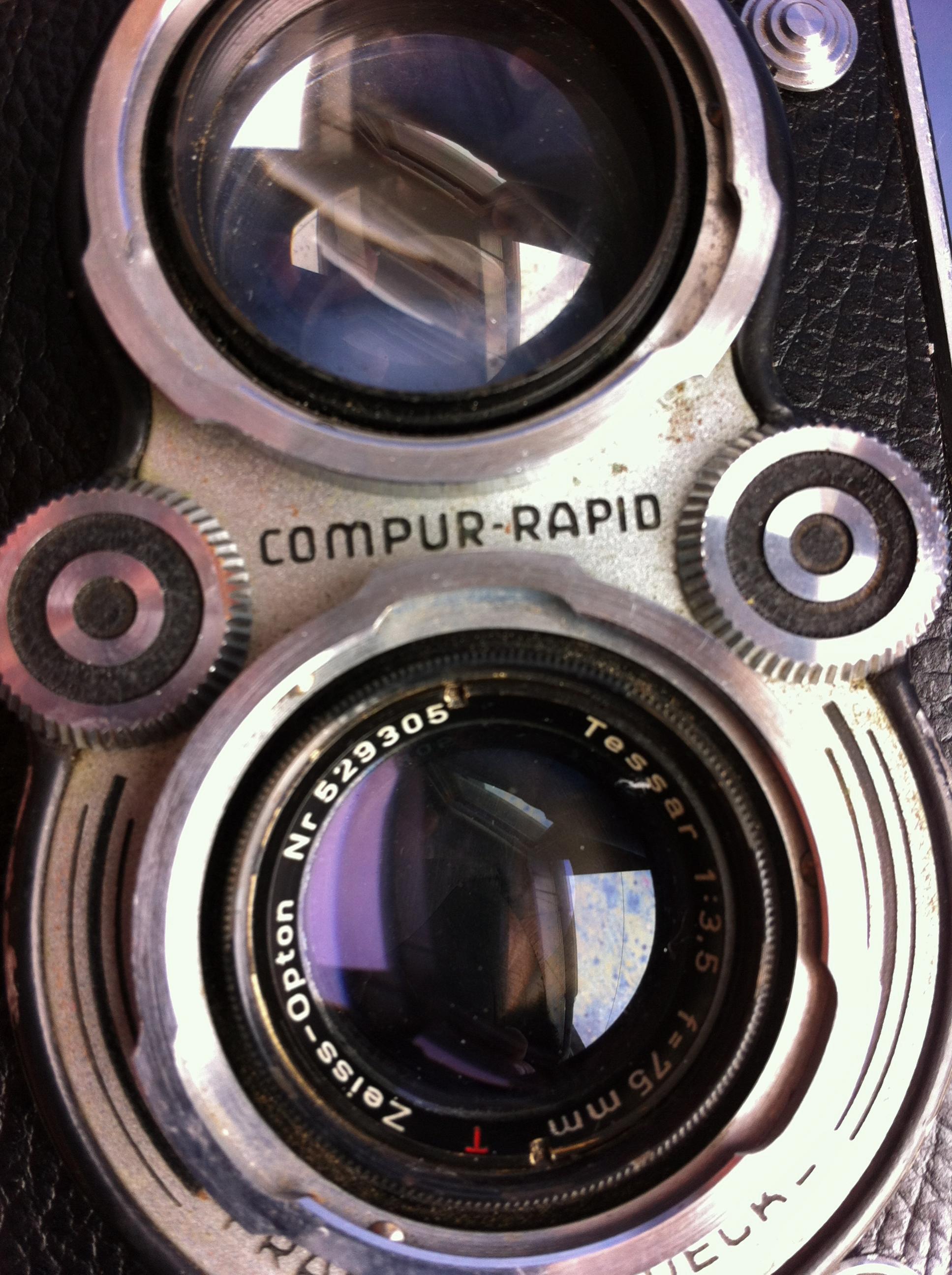

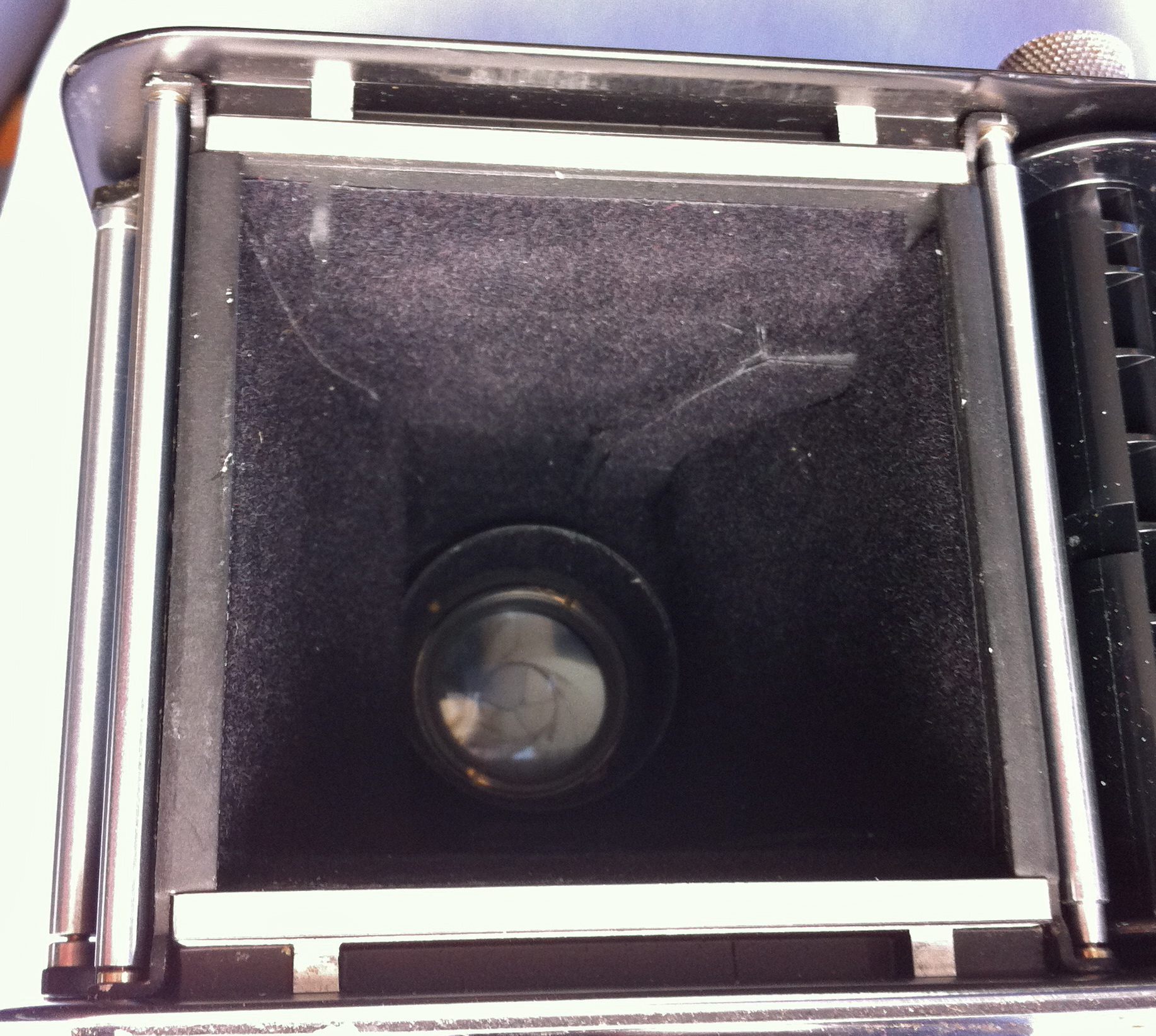

Anyway, here are some very crappy iullustrative photos, I did this now, just to show how I did it.
Front removal points (sliders and knobs can be poked loose by a small screwdriver)
Removal of back, note that one need to lift the lever pointed out with the red arrow to be able to lift the back off.
This is how the tape is supposed to be attached to the back (I did it a bit loosely for the photos here, but it should be as tight and as "film like" as possible).
Tape attached to the ground-glass
Shining trough from the back, trough the tape and towards the wall.

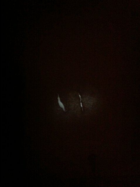

How the holes apear on the wall, quite a bit of detail to focus on.
Light the ground glass and adjust the viewing lens and you should be set.
