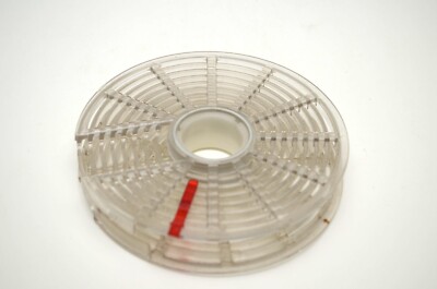

There is a 16mm JOBO spool on eBay for £20 .
It's a different model number than mine , so might be for a different tank size .

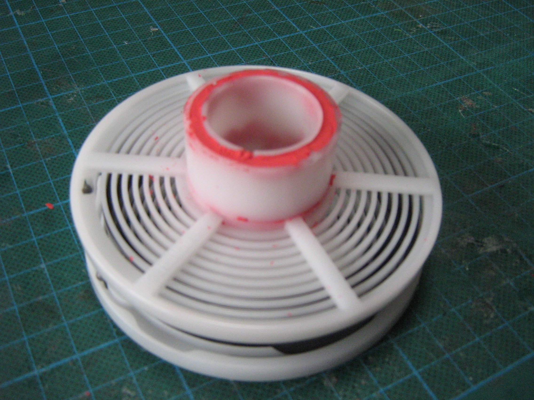

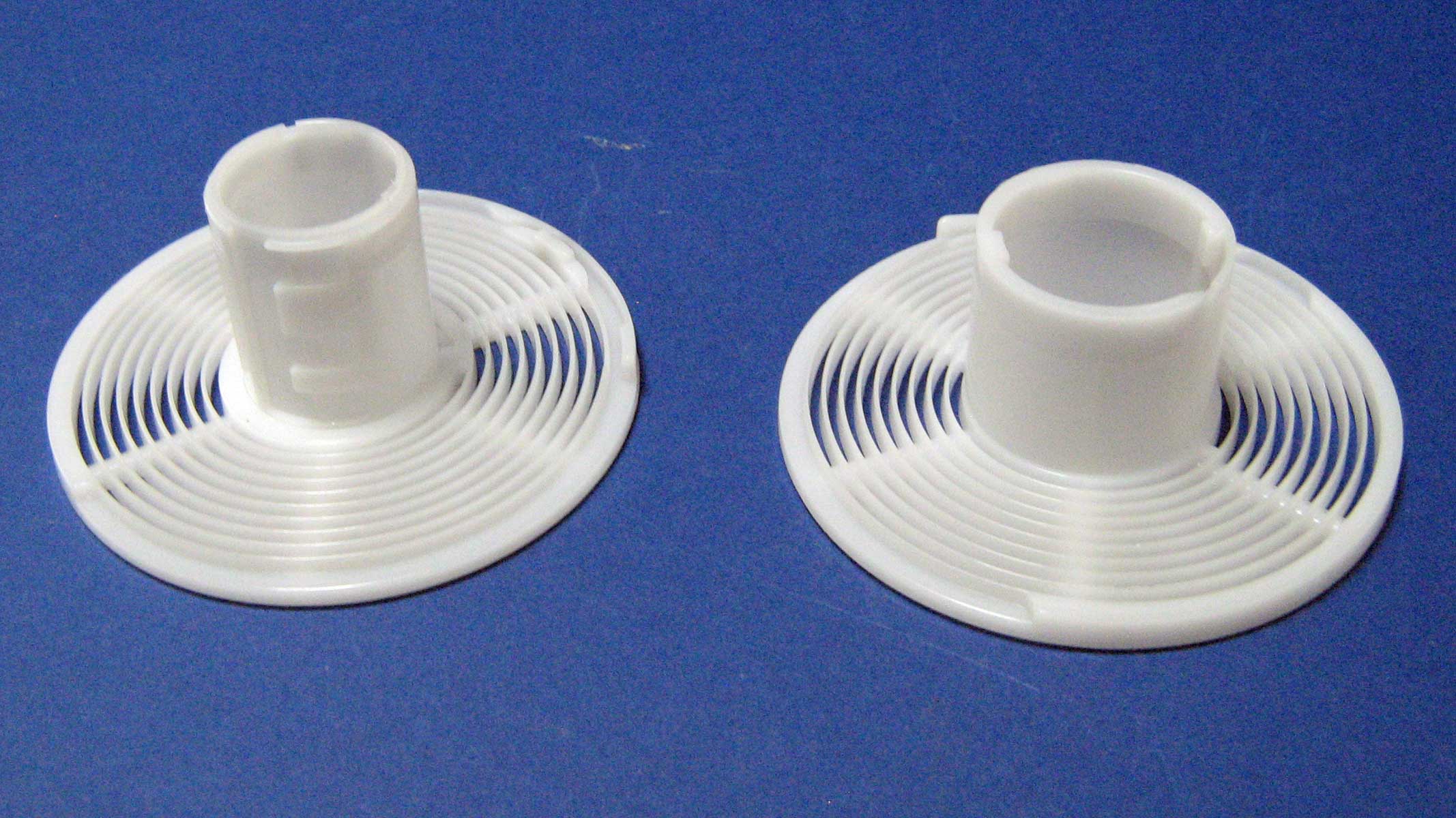

Well I thought I might might as well have a go at converting a spiral myself. Even put a question on AI! on how to do it. Naturally came back with the obvious, cut down the column of an existing Spiral. This I did with a Paterson unit reducing the outer height to 12mm. Took care to cut evenly around. Well it works. Once cut the piece cut off can be used a spacer above and the best thing is fix it all in place. What I had forgotten is that the spiral plate on the inner column rotates separately. So the ratchet mechanism still works. I used a rubberised filler glue stuff called Sugru but I think there are similar products on the market. Happen to have a red pack.
So the two parts before cutting the one on the right down to 12mm.
Below after cutting and assembling. Dud 110 16mm film went straight in. So now I can use my last two Orca 100 110 films.
