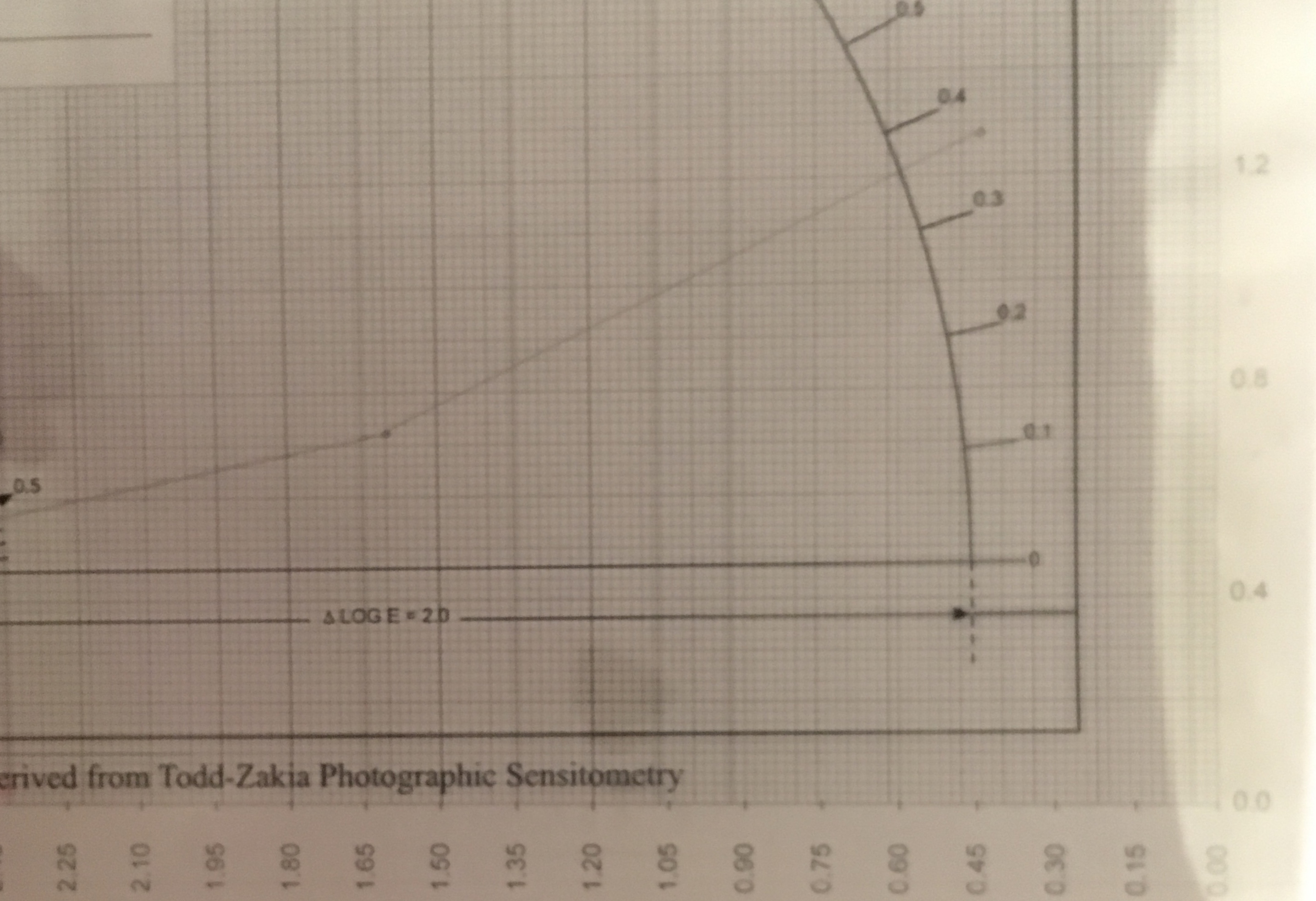

I think it is the callier effect, the chromogenic versions have a gamma of 1 which is what these silver films are attempting to replicate.
The blue and green gamma is spot on 1 with my measurements here from page 3: https://www.kodak.com/uploadedfiles/motion/5273_ti2655.pdf
Its only a guess, but it seems to match.
The curve is 45 degrees but the horizontal and vertical scaling are different. So not 1, closer to 0.5
Plus that’s interneg from color slide.
Posted the wrong link, it is exactly 1 on the vision 3 intermediate film. :redface:
https://www.kodak.com/uploadedfiles/motion/5242_ti2461.pdf
I am only guessing it is the callier effect that requires a different density for the silver film. However I am reasonably sure the effective gamma must be 1.0 otherwise the contrast will shift from the value expected of a duplicate. i.e. if it not the callier effect its something else.

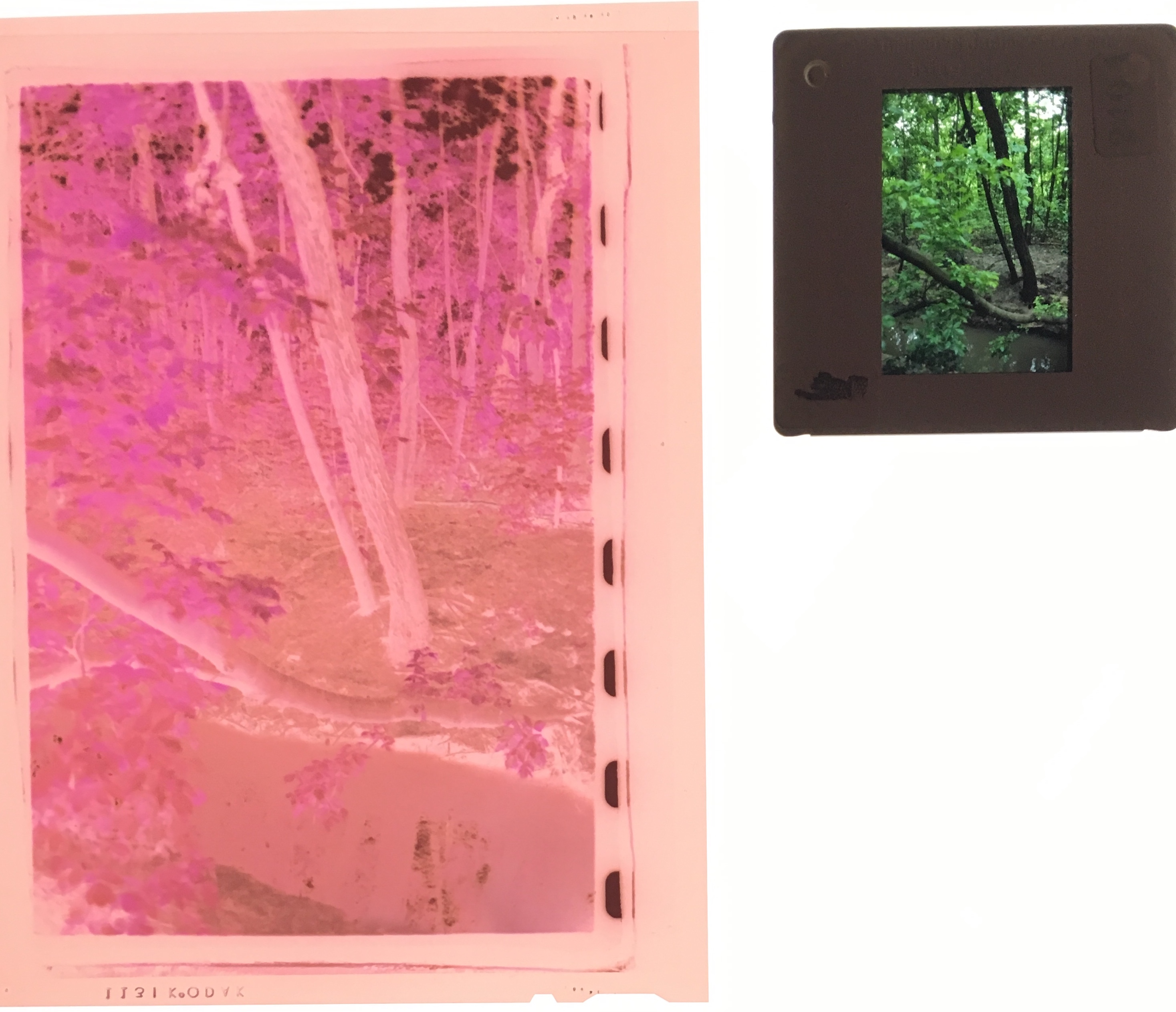

E15E07F1-97E1-4FF7-B331-1308111E5832.jpeg 60460E89-C6A4-466B-AEB4-B5C0C5E1716B.jpeg
Ok that data sheet says gamma is near “unity” for camera negative to master positive intermediate. I agree there will be steps where that’s the right contrast.
I know you’re not talking slide to print, but I want to show you a typical low contrast intermediate.
I found this set in my collection, this is a slide original to color negative intermediate, that was printed on regular photo paper. I graphed the tree, mud and sky and estimate the CI of the Kodak 1131 to be 0.37
I want you to forget the Callier effect unless the application involves enlargement in a condenser source. Cinema usually doesn’t so there wouldn’t be a Callier. I think Kodak calls it Q
Maybe they are enlarging to 70mm? Maybe as Drew says, they never tested. Maybe you do need to develop to unity gamma.
So keep looking for what you intend to recombine the color separations onto. So long as that’s undefined, you wouldn’t know the required contrast.
