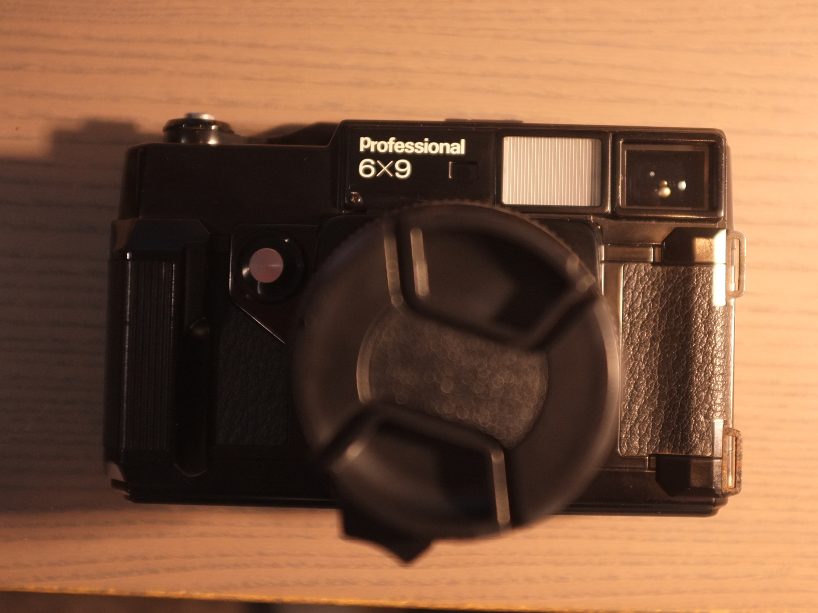

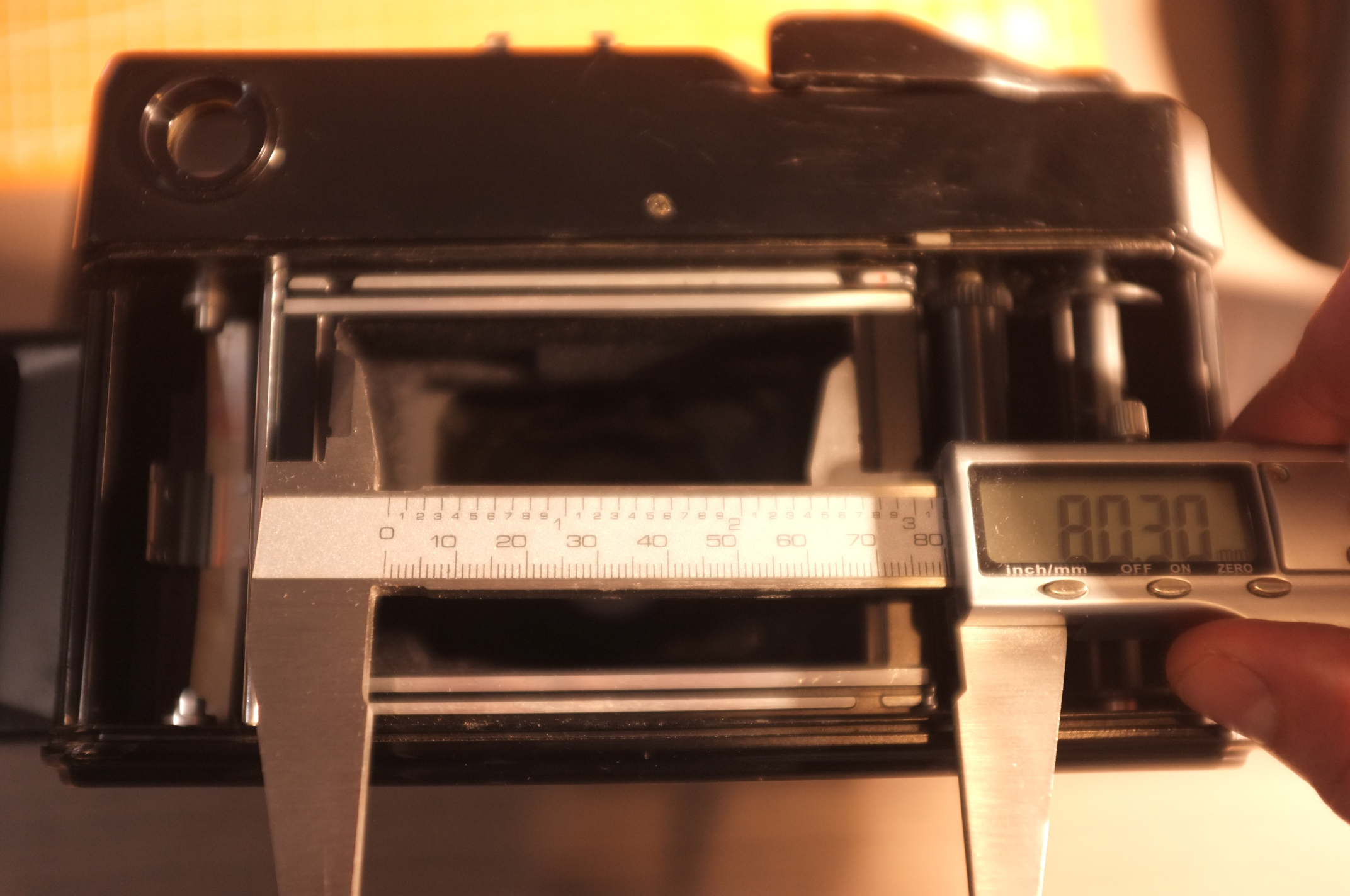

I have a Fujica GW690 6x9 Professional.
I assumed that the frame size would be 6x9 cm, but it is much narrower: 54.5 x 80 mm instead.
Do I have a GW690 branded camera with GW680 innards?
(My Voigtlaender Bessa II, on the other hand, is much closer to 9cm, at 88mm wide. It seems more worthy of the Texas Leica moniker than the Fujica?)

My GW690III looks to be identical to what you're measuring
Even 4x5 isn't 4x5 :smile:.
Your Bessa II is actually unusual.
It is perhaps easier to think of medium format frame sizes in English units:
2-1/4" x 1-3/4", 2-1/4" x 2-1/4" square, 2-1/4" x 2-3/4", 2-1/4" x 3-1/4".
These convert to metric units:
57x44mm, 57x57mm, 57x70mm, 57x83mm.
It's not exact because many cameras (especially newer ones IMO) will have slightly smaller actual frame sizes. For example, a lot of 2-1/4" square cameras are actually about 56x56mm, 6x7 cameras are about 56x68mm, 6x9 cameras about 56x82mm. But they are usually closer to the quarter inch sizes than to "6x4.5, 6x5, 6x7, 6x9", which are basically convenience names.
The "normal" size for 6x9 is 56x84mm.

Yes that's the proper size. The 6x7 and 6x8 versions have masks glued onto the reliefs on the left and right of the film aperture. The size on the negative will be a bit larger than 80mm because of the offset of the reliefs.

Yeah, my 1930's Bessas are also both unusually large, around 88mm if I recall. Horseman 970 and most others are 82mm. 54:82 is closest to true 2:3.
I'd be concerned if the image height was too much; there would be more risk of edge fogging or uneven development. Actual width would be determined by the mechanics of the winding mechanism, and how easy it would be to set this during mfg depending on whether 6x6, 6x7, 6x8, or 6x9 were in mind, using similar interchangeable components.
I don't have a GW 6x9, but a GWii and GWiii, which have exactly the same image size, and probably the same mechanical innards too. I've only gotten into and myself serviced the older model in that respect; but the repair manual shows nearly all the same hidden interior parts for both.
max frame width on 120 is typically 56mm...so called 6x6 and 6x7 and 6x9 is not that wide
645 is typically only 42-43mm not 45, with 55-56mm across the film width.

I was also curious about the actual frame size a while ago. At the time, I even measured the 6x9 negative taken with my Fujifilm GW690 camera. It measured 56 x 85 mm. My 6x6 cameras produced frames measuring between 56x56 mm and 58x58 mm (rangefinder).
Here is the note I wrote at the time:
24x36 mm 864 sq.mm
Crop digital medium format sensor
33x44 mm
Phase One (digital)
53.4x40 mm
6x4.5
56x42 mm 2352 sq.mm
(2.7x as large as 35mm format)
6x6
56x56 mm 3136 sq.mm
(3.6x as large as 35mm format)
6x7
56x67 mm 3752 sq. mm.
(4.3x as large as 35mm format; 1.6x larger than 6x4.5)
6x9
56x85 mm
