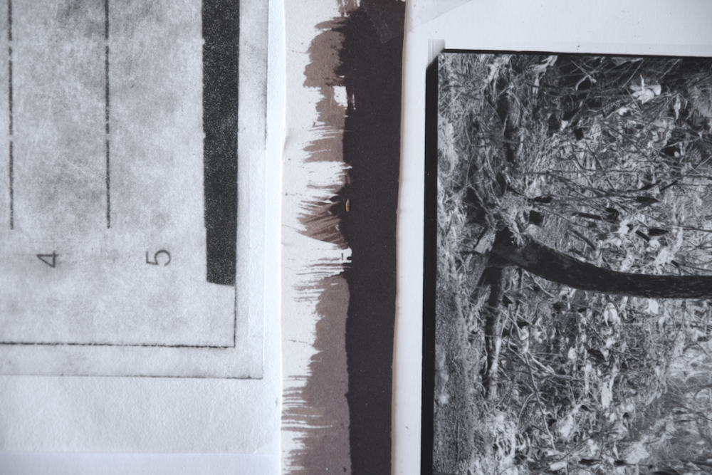

The experience of 'black' in photographic terms is a malleable thing, and trying to get three different examples in one photograph is nigh impossible...having said that...can anyone comment on the photo below?
From right to left is a selenium toned fibre base silver gelatin glossy print, the middle one is a hand coated salt print, and the one on the left is a hand baren pressed 30gsm moistened 100% mulberry bark machine made paper using Gamblin Bone Black thinned with plate oil from E9220 photopolymer film and a fine aquatint screen. Whole plate got the aquatint exposure, then the positive had a strip of ruby lith tape to see what 'max black' could be achieved.
Instinct tells me that my gravure black will get much better with a press and more experience.
Just how black are your gravure blacks?
Mine weren't a whole lot better than what you show there - maybe a bit more even. Having said that, I was looking at a couple of Paul Cupido prints about a week ago and the blacks on those were absolutely solid. Evidently I didn't press a densitometer against them, but they were as black as the black on any matte silver halide paper, and perfectly even without any white spots/specks.
I think you really need a press, yes. I never tried it by hand; the papers I used were a lot heavier, too, so it wouldn't have worked as well as it did in your case. Anyway, I'm sure you'll make lots of progress in the blacks department.
It would be nice to see some in real life, unfortunately, online examples are what I'm stuck with.
With a 27"x 32' roll of paper and a 13.5" x 250' roll of photopolymer film, I have the freedom to experiment, spin my wheels, test, and otherwise get comfortable within the process to my hearts content 👍
Do I understand correctly you are just using your hand to press the paper and getting this kind of results. What about a dry mount press? Anyone tried that?
:Niranjan
Gravure is capable of delivering essentially 100% K (400% in 4-colour) in a single pass if you do things properly. Etching presses deliver an enormous amount of pressure (and with enough power in their mechanisms to shear really serious size bearings if they jam).
:Niranjan
I think a dry mount press would only achieve a warm hug, not the paper fibre squishing forces needed to see the plates edge & surface embossed into the papers surface.
...and yes, that gravure sample was done by hand.
I used a fist sized glass lid to a candle in a jar...smooth & flat with rounded edges. Covered the plate & paper with a 300gsm piece of paper, made sure things wouldn't squirm around, and spent about 5 minutes going over the 5x7 plate with firm pressure.
Not a long term solution!
Then again...Asian printmakers have been using hand barens for over a thousand years or so to good effect, so there might be some nuggets of wisdom in that realm which may be useful to making polymer photogravures. (Thinking thin, Kozo, Gampi, etc, papers here).
That's what I'm hoping for...bottomless, reflection free blacks that you can feel yourself falling into.
Asian printmakers have been using hand barens for over a thousand years to good effect
But with block printing, not intaglio.
I agree the hot mount press is a non-starter. You really need the insane amount of pressure that an etching press can provide to really work the paper into the plate.
Which means an etching press or access to one via a print studio. There are good ones that aren't hundreds of kg or enormously expensive.
