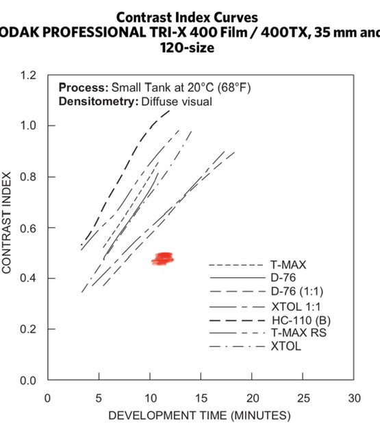

First thing I would do is hunt for a Time-Contrast graph for Tri-X and D-23 1:1. (I would make that graph for you if I were going to use that film/developer combo… but I don’t have plans right now to do that).
You got about 0.96/2.10 = 0.46 contrast, in 12 minutes. You should want about 1.20/2.10 = 0.57
Kodak Data Book, Processing Chemicals and Formulas for B&W (1954) says D-23 average developing time is about 19 minutes in a tank. I don’t know why you picked 12 minutes but let’s continue…
Red dot is what you got… this doesn’t have D-23 1:1 but suppose the time-contrast curve is parallel to D-76 1:1 and knowing what you got, I would try 16 minutes next time.
