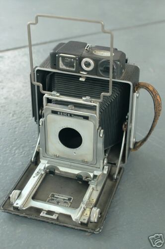

three types of budget camera's are in my ebay watchlist:
the busch pressman, which is a presscamera but looks nice
the burke and james watson press, which is a presscamera too,
and the burke and james watson view, wich is the viewcamera.
if I understand everyone correctly the latter is the one that is intersting for me? true?
thanks Game
One thing to keep in mind is the focal length of the lenses you will be using. Contrary to a lot of folks, I personally like using longer focal length lenses and don't find a lot of use for wide-angle (less than about 125mm) lenses in 4x5. For 4x5, my favorite lens was a 240mm, closely followed by 360mm. My choices in newer 4x5 cameras, therefore, did not include cameras such as the Tachihara and Shen Hao and others like them, simply because 12" - 13" (300mm-330mm) of bellows draw was insufficient. Both my B&J and Ansco 5x7 cameras had between 14" and 15" (360mm - 375mm) of bellows draw, making them just usable for most of what I was interested in doing. Now that I'm mostly working in 8x10, of course, everything is different...
A press camera will be made of metal and have very few movements. There may be a rangefinder on top, and/or a large handle attached to the side. The tailboard camera is made of wood, often (but not always!) has a red bellows (for B&J) or yellow-green bellows (Agfa/Ansco.) Let me see if I can find some pictures for you...
Ok. The press camera picture is of a Busch Pressman, but most of these old press cameras look very similar. This one has a lot of options on it, like the wire frame "action" finder. The B&J picture of a model they called the "Watson" and is a 4x5 model. This one looks to be in excellent condition, like new. The 5x7 model is pretty much identical, just larger. Most B&J tailboard cameras (and Agfa/Ansco too,) will be a shade of gray unless they have been refinished (the wood underneath is hard maple.) That's one easy way to tell at a glance. This particular camera appears to be a brown color, which I personally have never seen but what the heck, it looks nice. Both of these pictures came from US E-bay, by the way, and are for sale.
