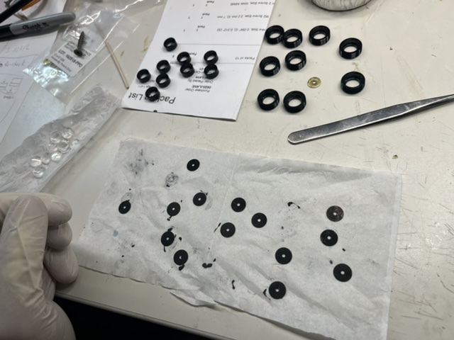

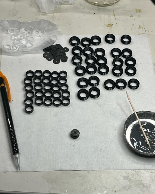

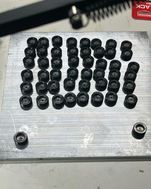

I started assembling the inner lens assembly last night, and built the first 20. I've built another 30 tonight.

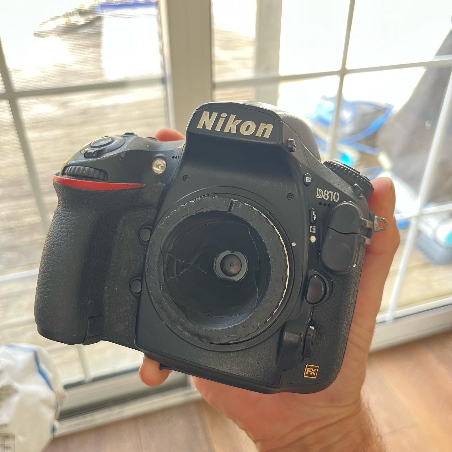

Earlier today, I took one and mounted it in my hack-job 3D printed adapter for my Nikon D810. I had to shoot in live mode to keep the mirror up out of the way, but I was able to capture some images around the house.
The main housing will be arriving in a few more weeks. Then, I will be able to mount these in the housing, set for best focus, and then Steve will make them available for sale. I think he is considering taking preorders, but that'll be up to him.
Apertures are blackened brass

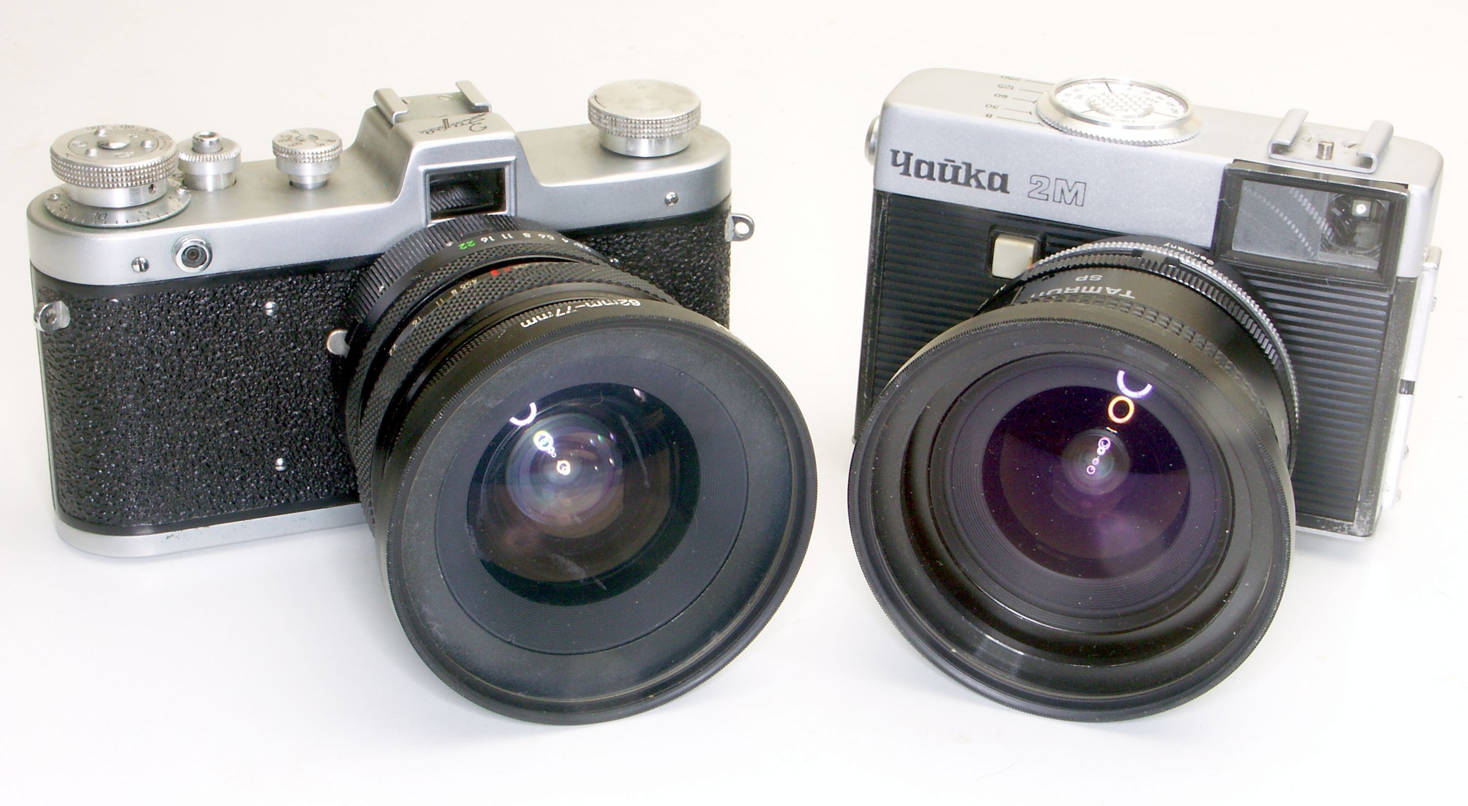

One option is to use retro-focus wide-angle lenses you already have, and use an adapter for your L39 camera(s), like this ZAPA and CHAIKA (YANKA):

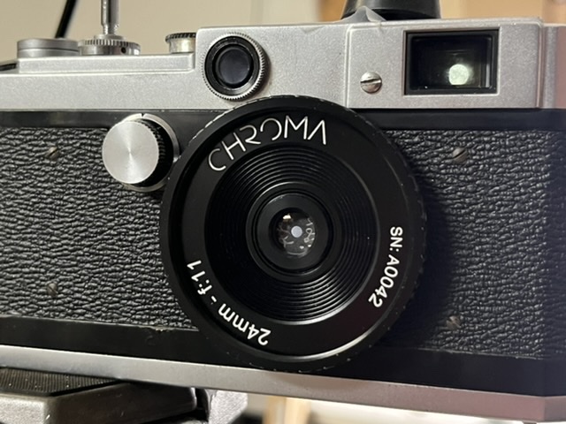

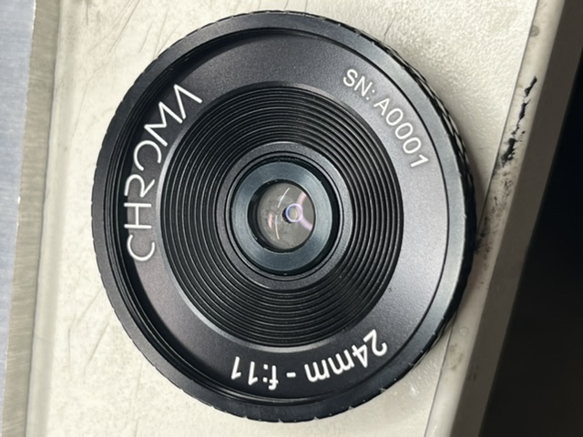

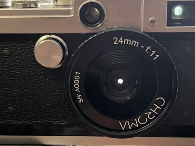

Serial # 1 of first production run. And on my test camera.
Congratulations.
I've never seen such a low serial number before, probably never will again. 😃
Congratulations.
Haha. Me neither! Nor will I have this one for very long. Steve will get this one. I’ll lay claim to #2. :smile:

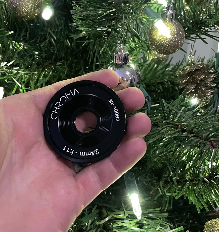

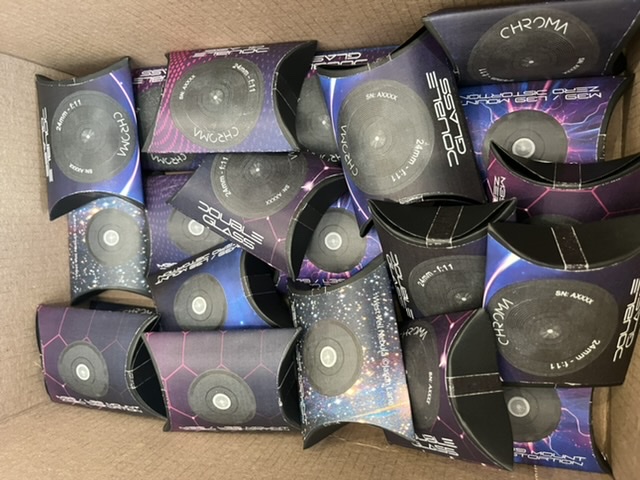

Lenses have started shipping out. Here you can see the cool, minimalist packaging that Steve came up with.
