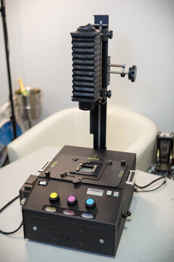

How would one of these with a high end digital camera and an APO enlarging or copy lens compare? Big advantage is individual slide color/exposure/contrast control (if necessary) and if you set up your work flow right you can shoot a slide every 10sec or so... you also have the option of using flash or quartz halogen bulb exposure for whatever that's worth
I have a setup like this. Negative flatness can be a problem - and just the over all film handling. Flash is great, but too strong, so you have to get ND filters. I have a stack under the diffuser. Worked ok for a job of 2000 framed kodachromes. But again - a good drum scan is more my taste. All depends on what the files are for.
