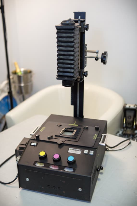

How would one of these with a high end digital camera and an APO enlarging or copy lens compare? Big advantage is individual slide color/exposure/contrast control (if necessary) and if you set up your work flow right you can shoot a slide every 10sec or so... you also have the option of using flash or quartz halogen bulb exposure for whatever that's worth
This is a comparison of detail that can be captured with a Pentax K20D 14.6MP @ 4672 X 3104, Coolscan 4000dpi @ 5700 X 3780, Nikon D800 36MP @ 7360 X 4912. As you can see, the D800 has more pixels then a 4000dpi scan but the Coolscan is able to achieve a tad more detail.
Resolution testing my SMC Pentax-M 50mm F4 macro lens by Les DMess, on Flickr
The big crop on the right is an optical magnification of about 4.5X of the center portion that clearly shows the detail achieved on this frame of 35mm Kodak Techpan (shot at ISO25 and processed in Technidol) and not resoilved by the scans conducted.
I would agree that a DSLR scan is far faster particularly on true b&w film where the effectiveness of ICE does not come into play and post work is very limited to inversion. For color slides it can be faster but not if the slide contains dust and scratches. The Coolscan 5000 takes about 50 seconds to get a full res and clean scan using ICE - about 30 seconds without.
Kodachrome D800-Coolscan by Les DMess, on Flickr
Spotting this DSLR scan would take far longer then the scan.
But when it comes to scanning color negatives, then the much more complicated post work would take far longer then a scan from the Coolscan. And if spotting dust and scratches is required then even longer . . .
Kodak 160VC-06-36 K20D vs 9K ICE by Les DMess, on Flickr
Excuse my poor attempt at color negative conversion compared to the fully automatic results from the Coolscan+Nikonscan. As good as I am in post work, I can't imagine how long it would take for me to match the magical ICE of the Coolscan+Nikonscan.
