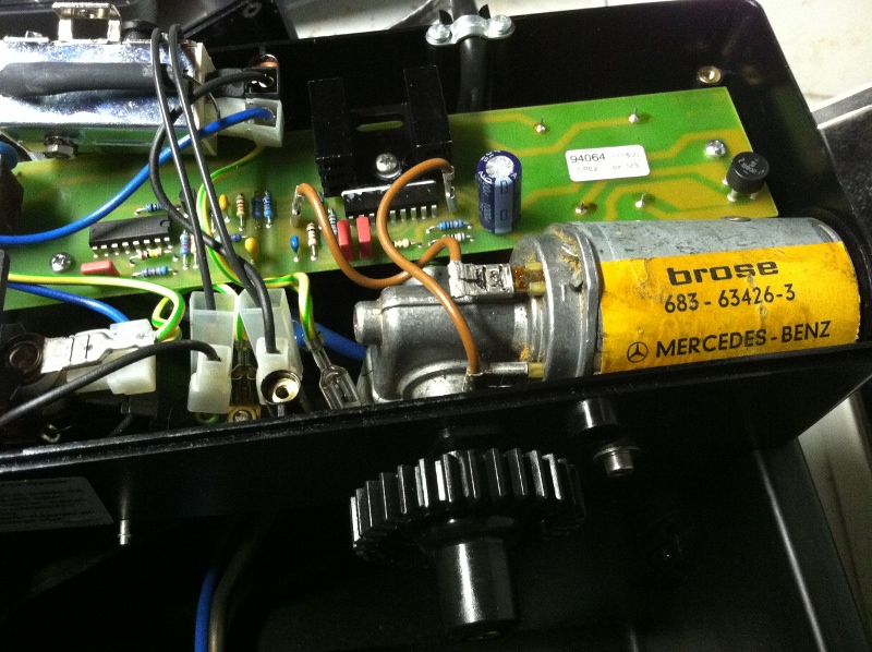

Thanks, I pulled the thing apart. Let's just say the engineering in the machine is very "Germanic." I pulled out the motor which is fully sealed and dropped some 3in1 around where the shaft goes through the transmission, hoping to get some to seep in... No Dice... I did see a large hole in the top of the motor but I don't think there are any bearings in there. Well I am done for the night. I'll play with it more tomorrow.

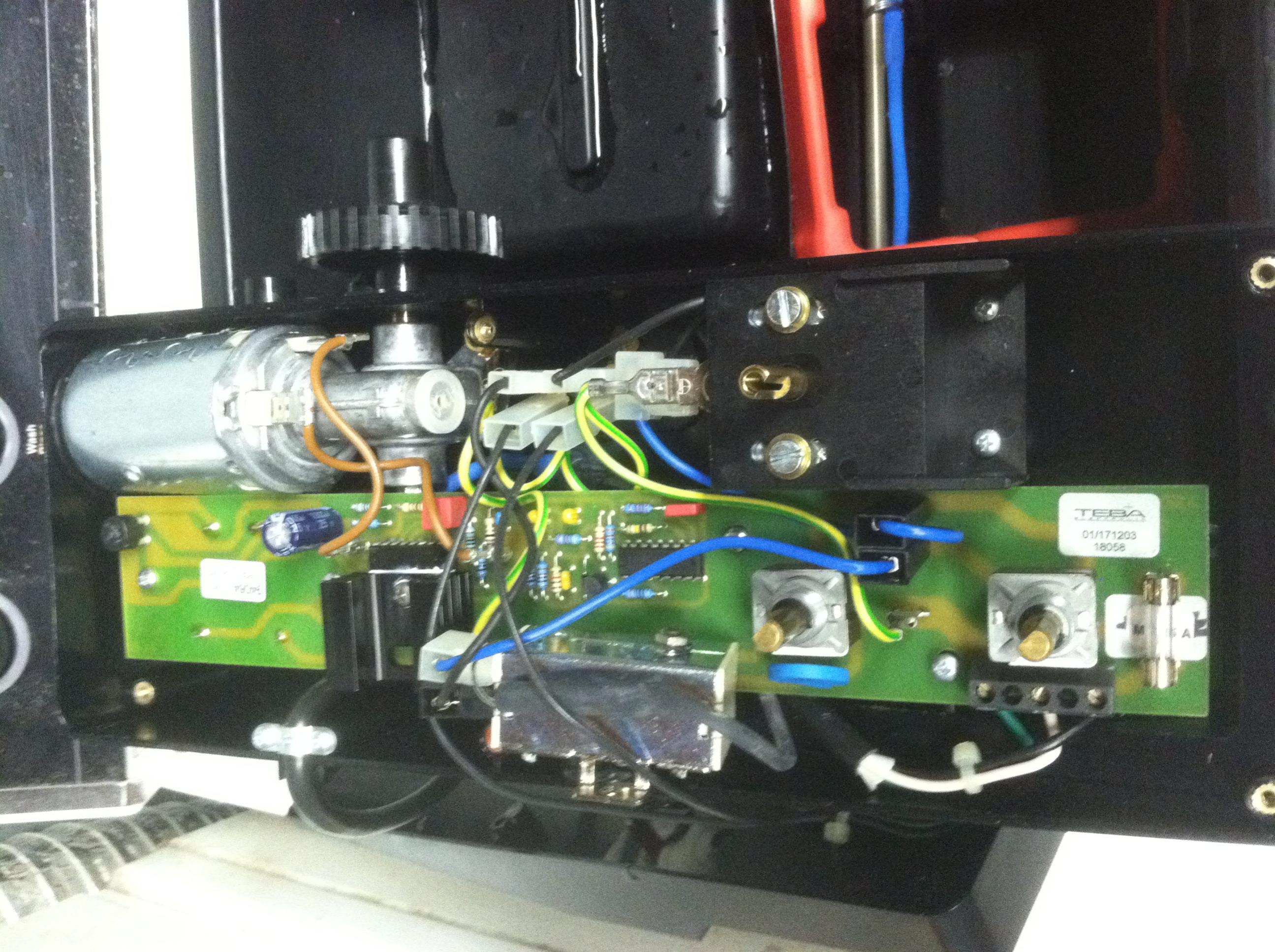

That's what the inards of the machine look like. There is no "claw" but when it stalls it makes that motor is stuck hum. It also happens indipendant of the machine reversing.

I pulled the motor apart, cleaned it out best I could, oiled the shaft, and re-assembled. Ran smoother than ever before. I then put a tank on, and was simulating a film processing cycle. 7 minutes in it stalled again, but with less warning. Tomorrow I will hook the motor directly into a 12V power supply. My CPE-2 Plus seems to have a switch on a circuit board that reverses the motor rather than a mechanical method and I noticed a random heat sink was VERY hot.

If the heatsink (presumably the one by the brown wires; I think it's the transistor for controlling motor speed/direction and I think it does reversals based on a timer unlike the CPP2 which has a "claw foot" that switches every 2 revs) is very hot, that still probably indicates a motor-drag fault. Given that you got some improvement by cleaning, you can probably get it all they way to nominal operation by further cleaning and careful lubrication. If the transistor there is a MOSFET (quite likely), increasing temperature will increase its on-resistance, which in turn will generate more heat, etc, until it all stalls. Can you read the part number on that transistor? It might be possible to replace it with a more-modern version (FETs have advanced a long way in the last 10 years) that doesn't get as hot and gives the motor a little more torque.

There is a Bosch model number on the motor. It's the headrest motor for a Mercedes Benz W124. I just picked one up on eBay. So yes the rumors are true. Jobo used Mercedes Benz parts.

Thanks for all the help and I hope this thread helps some one else in the future. The Mercedes Benz headrest motor was a drop in fit. All I needed to do is remove a bracket that was bolted to the motor base and de-solder the leads to the motor. I don't know if it would work for any one else's machine but it worked for me.
Dave M.
`Appears to be running fine now. Not sure why cleaning and re-lubing the old motor failed. Everything looked good inside. My best guess is a bad bearing surface as the rear of the motor was getting toasty hot.
