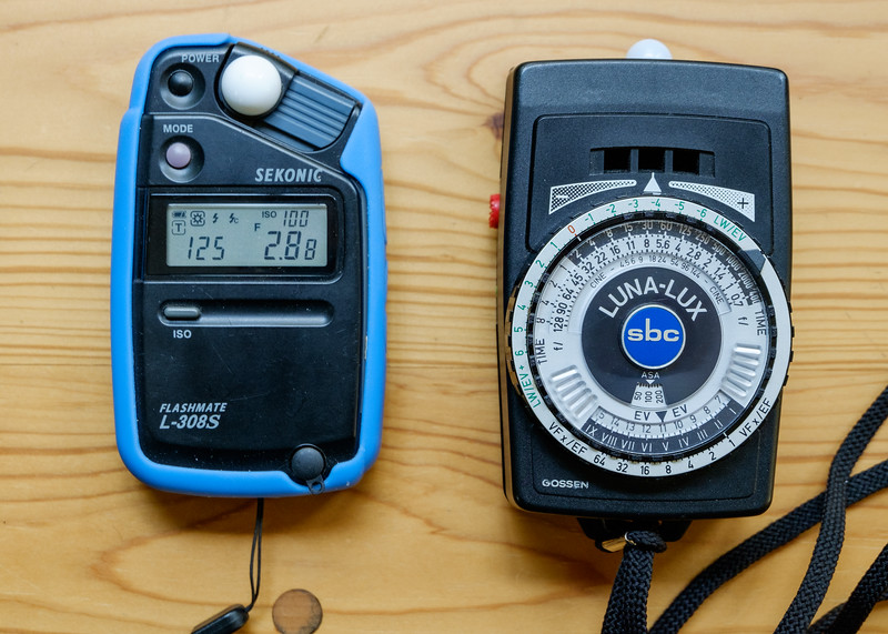

I have both the Sekonic L-308s and a Gossen Luna-Lux SBC. The "s" version of the L-308 is older (and cheaper) than some of the more recent ones. And the "Luna Lux" is similar to the "Luna Pro F" discussed by @eli griggs in post #27, except the "F" has a needle indicator, but the "Lux" uses LEDs. Any one of these 3 meters is capable of accurate readings in both reflected and incident modes -- and they all use commonly available batteries.
These meters look complicated, but read the manual, ignore the features you don't need, and after using one for a while, it becomes second nature.
On eBay, I paid $50US for my Gossen Luna-Lux (2019), and $160US for my Sekonic L-308s (2020). I have not checked prices recently.
I love the big sexy dial on the Gossen, and I love the way I can see the correct settings for different combinations of shutter and aperture without needing to push any buttons! But, 9 times out of 10, I carry the Sekonic -- mostly because it takes less room in my camera bag. I think the Sekonic may also be a little more ergonomic to use, especially one-handed.
Avoid any of the older meters that take 1.3V mercury cells. There are some workarounds, but it's much easier to get a meter that runs on currently available batteries.
