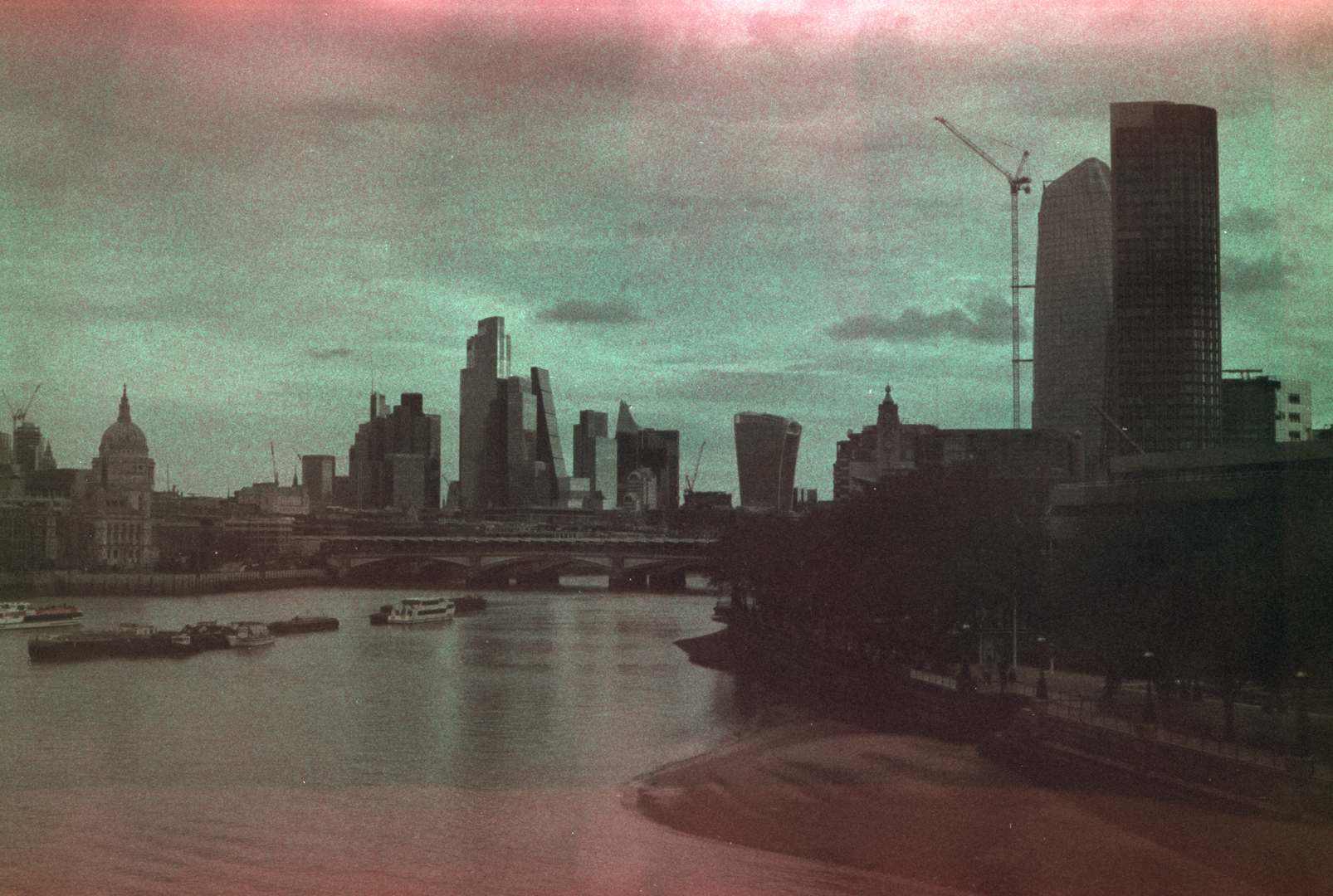

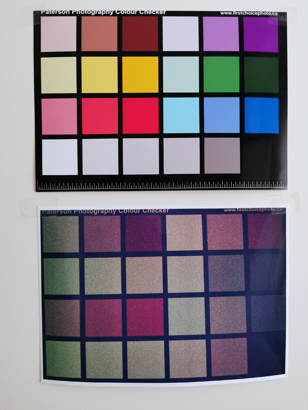

I tried the formula of example 1 in the Patent with 18.4g sodium hydroxide, developing for the specified 7m 23C. Film was a strip of 1yr out of date Ektar 100, EI=100.
The result was completely opaque negatives apparently covered in black silver. These were bleached for 5 min and fixed but remained opaque.
The sodium thiosulfate in the solution was increased from 19 to 125 grams per 800ml and a second strip developed 2min 22.5C. Again the negatives were opaque to my scanner but on bleaching and fixing a very thin image was visible. This was scanned with the setting for Ektar 100 with the result attached.
It does seem that the time of 2 mins at room temperature given in the book mentioned above is about right. It may be that the formula given in the book will give better results than the patent formula which necessitated addition of bleach and fix steps and appears to be not a satisfactory monobath.
The other patent from 1980 corrects some of the earlier ones. It specifically names Eastman Color Print Film type 7383 as appropriate for their formula. ECP films have specific characteristics, so trying something like Kodak 2383 may yield better results, but it's super slow. If you go that route, you'd also need to use filters since ECP film is intended for tungsten light. FPP Sun ISO 1 is daylight balanced copy film, so that may be better. For C-41, maybe Aerocolor IV (Kodak 2460) or Ilford Phoenix would be slightly better since they have a clear base? I actually like weird colors like your photo, so for creative photography I'd call this a win!I tried the formula of example 1 in the Patent with 18.4g sodium hydroxide, developing for the specified 7m 23C. Film was a strip of 1yr out of date Ektar 100, EI=100.
The problem is not so much in the color developing agent; it's in the fact that development is poorly controlled and no developed silver is removed from the negatives.Is it possible to achieve better results using CD3? CD3 development appears to be less affected by temperature.
It may be a little difficult to find this result very inspiring.
