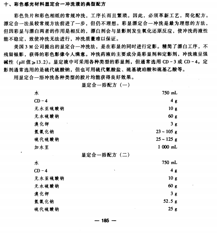

I found a formula for a color monobath developer in a book, which claims to develop and fix color negative film in a single step at room temperature in just 2 minutes. I'm quite skeptical about this, but I currently don't have the means to test it. I'd like to hear everyone's thoughts on this formula.
Monobath Developer Formula
  • Water: 750 mL
  • CD-4: 4 g
  • Anhydrous Sodium Sulfite: 10 g
  • Anhydrous Sodium Sulfate: 60 g
  • Potassium Bromide: 3 g
  • Sodium Hydroxide: 52.5 g
  • Sodium Thiosulfate: 25 g
  • Add water to make a final volume of: 1000 mL

10. Typical Formulation of Integrated Developer and Fixative Washing Solution for Color Photosensitive Materials
Conventional processing of color negatives and color photographic paper is lengthy and cumbersome. Therefore, it is necessary to innovate the process and simplify the formula. Although the combined bleaching and fixing method is an improvement over the conventional method, it is still not ideal. The combined color development, bleaching, and fixing processing method is the most ideal method, but because the effects of color development and bleaching are opposite, the bleaching agent will undergo an oxidation-reduction reaction with the developer, making the properties of the processing solution unstable, thus making processing impossible and making it difficult to guarantee the quality of processing.
The integrated developing and fixing method proposed by 3M in the United States involves fixing the image while developing it. This simplifies the bleaching process, eliminates silver residue, and yields satisfactory color images. The main components of the developing solution are the color developer and the fixer, and the solution is strongly alkaline (pH ≥ 13.2). Various types of color developers can be used in the developing and fixing solution, but CD-3 or CD-4 are commonly chosen. The fixer is usually sodium thiosulfate, but thiocyanate, mercaptosuccinic acid, and mercaptoacetic acid can also be used.
Good results can be obtained by using a combined developing and fixing bath to process various types of film.
Formula for a combined bath with styrax and styrax (Part 1)
water 750 mL
CD-4 4 g
Anhydrous sodium sulfite 10 g
Anhydrous sodium sulfate 60 g
Potassium bromide 3 g
sodium hydroxide 23~105 g
sodium thiosulfate 25~125 g
Add water to
1000 mL
Formula for a combined bath with styrax and styrax (Part 2)
water 750 mL
CD-4 4 g
sodium hydroxide 52.5 g
sodium thiosulfate 25 g
Add water to 1000 mL

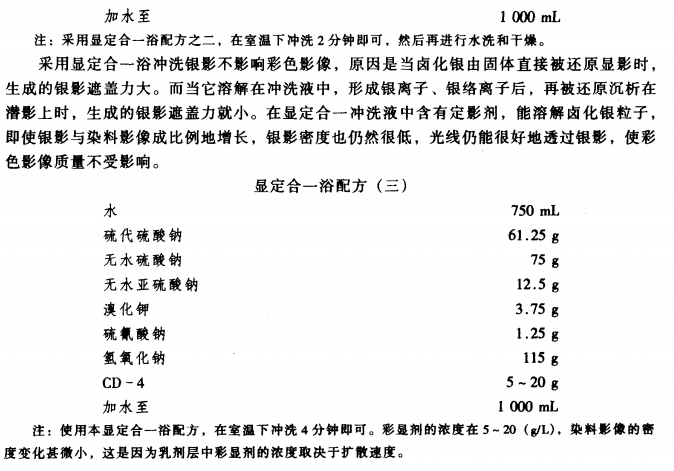

Note: Use the second formula of the combined bath solution. Rinse for 2 minutes at room temperature, then wash with water and dry.
The use of a combined developer-fixer wash for developing silver halide does not affect the color image because when silver halide is directly reduced and developed from a solid, the resulting silver halide has high covering power. However, when it dissolves in the developing solution, forming silver ions and silver complex ions, and is then reduced and precipitated onto the latent image, the resulting silver halide has low covering power. The combined developer-fixer wash contains a fixer that dissolves silver halide particles. Even if the silver halide increases proportionally to the dye image, the silver halide density remains low, allowing light to pass through well and ensuring that the color image quality is unaffected.
Formula for a combined bath with styrax and styrax (Part 3)
water 750 mL
sodium thiosulfate 61.25 g
Anhydrous sodium sulfate 75 g
Anhydrous sodium sulfite 12.5 g
Potassium bromide 3.75 g
sodium thiocyanate 1.25 g
sodium hydroxide 115 g
CD-4 5-20 g
Note: When using this one-bath developer-stabilizer formula, rinse for 4 minutes at room temperature. The density change of the dye image is minimal when the developer concentration is between 5 and 20 g/L, because the concentration of the developer in the emulsion layer depends on the diffusion rate.
