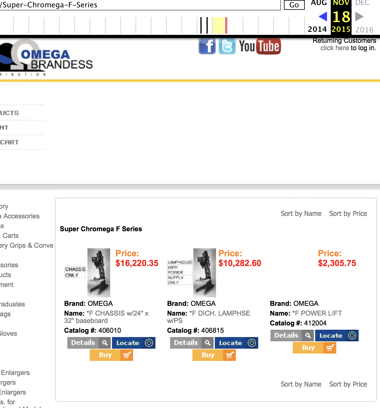

These new old stock Omega F (8x10) enlargers and heads have probably been sold as they are no longer listed, but the way-back machine can still pull them up with the prices from 2015:
That is $16220.35 for the chassis and $10,282.60 for the color head.

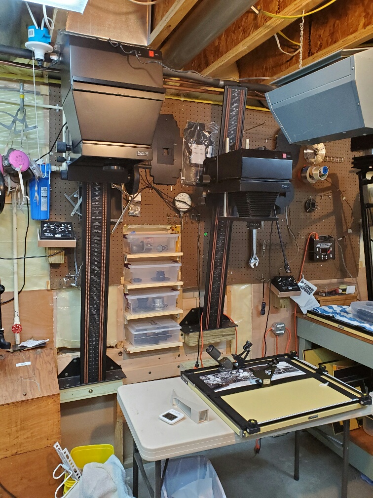

I have a 8x10 and a 5x7 Zone VI type 2. Both have the Calumet sourced VC heads, I use a Metrolux II integrating timer. These things AFAIK were made in Italy (the enlargers not the heads) I love these. I have Beseler 4x5 units that I use for medium format. If the VC head would go poof, I would be looking at a LED head. These things work so nice and see little use I doubt I will have a problem. The 5x7 I have setup for 6x17, I had a 6x6 carrier modified by SKG to 6x17 I like better than the factory version. The 8x10 carrier is amazing, stretch out glassless carrier. I would love to try printing color with these enlargers but the LED heads and controllers would be hard for me to justify.
Those are some great looking enlargers! I think an LED would be just about perfect on a chassis like that.

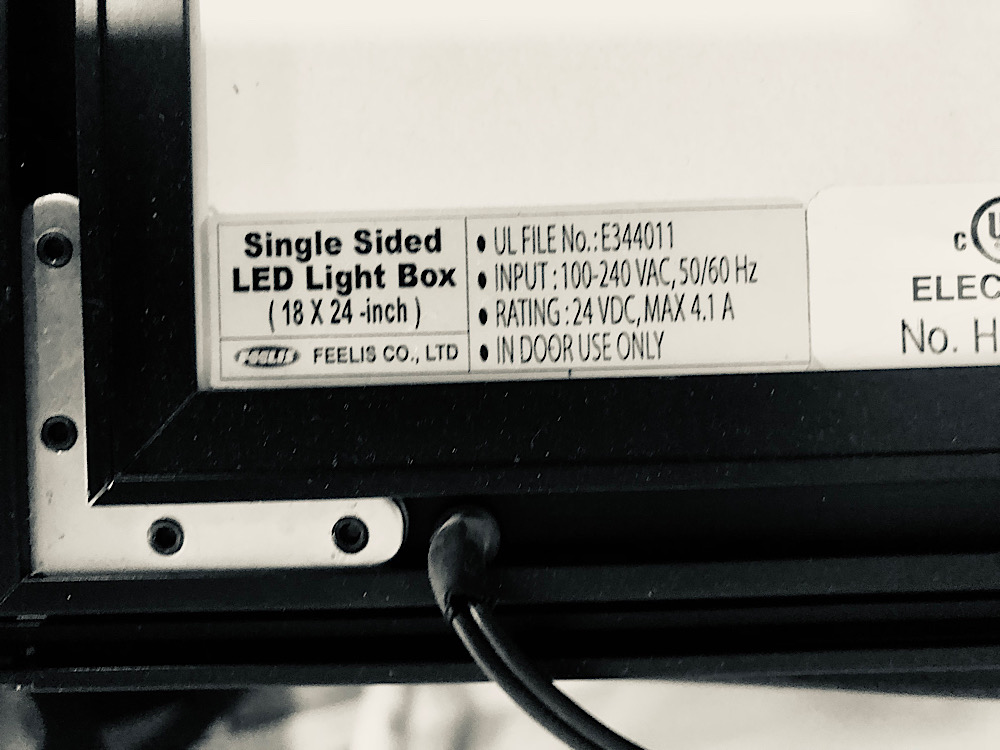

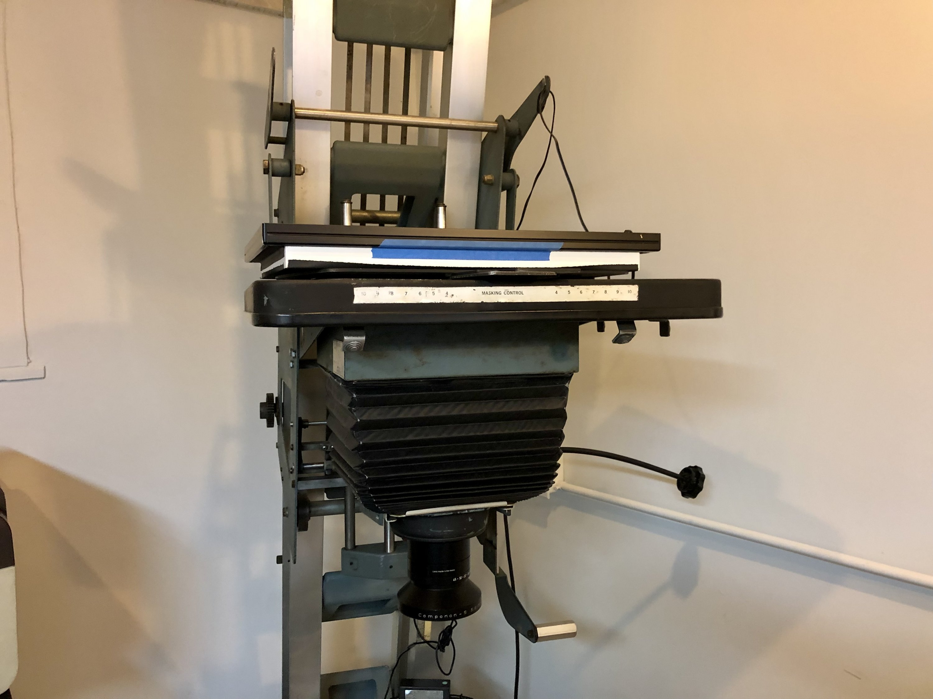

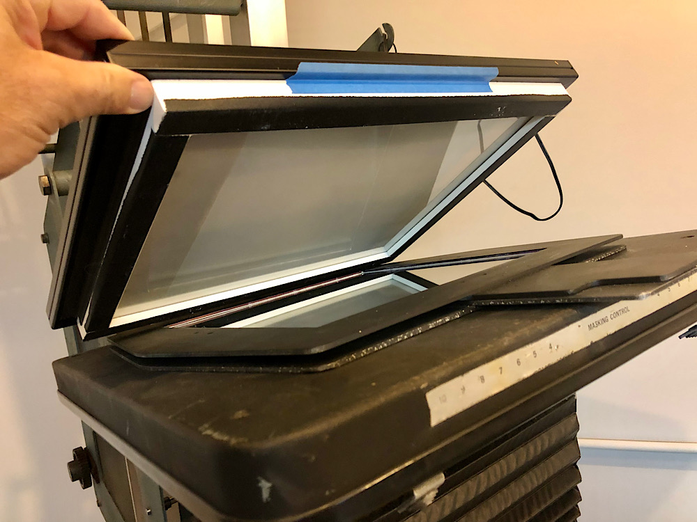

Here are some pics. Exposure times for B&W 8x10 neg to 11x14 print are about 40 seconds IIRC with under the lens VC Ilford filters. Light source just sits on top of the negative carrier. Picture frame from Target spaces the light panel a sufficient distance from the diffusion material (a Rosco diffusion sheet) to provide even illumination without hot spots.

I really appreciate those close-up photos of your Super Chromega F and the LED panel. I didn't realize the panel was 18x24" (good to know). From your photo I looked up slim LED light panels on the Feelis (feelisusa.com) site. They come in standard, slim, and ultra slim widths. For example: http://feelisusa.com/products/light-box-slim/

Do you have the Chromega filter drawer that would sit above the negative carrier (I don't see it in the pictures)?
I purchased a couple of the big 24" Rosco sheets -- gel equivalents for 00 and 5 grade filters for split grade -- to try in the filter drawer. I was curious to try the gels even with the Dichroic head as I'm not quite sure about the condition of the filters. It's not a done deal I'll go with an LED light source but I'm definitely interested in finding out more and open to the option.

Hey carlj,
The dimensions didn’t look right- I measured actual 13x17” for the outside dimensions- I don’t know why the label said otherwise. The original link to the panel on the LFPF site in broken, but I think I found it in the same company’s catalog here:
https://www.anythingdisplay.com/ind...&search=Led+light+box&description=true&page=2
I ordered the standard color temp 6500k. I am not using the filter drawer as the light source sits right on top of the carrier. I’m sure one could fabricate a slot without much trouble with some foam core and tape- there is no heat to deal with. As I think I mentioned I just use below the lens Ilford VC filters as I generally prefer not to split print when it is not necessary, but that’s just me. BTW, It looks like I ended up using Lee 212 diffusion and I needed two layers. Looking back I was getting a 15 sec exposure at f/11 for an 11x14 enlargement of an 8x10 negative.
