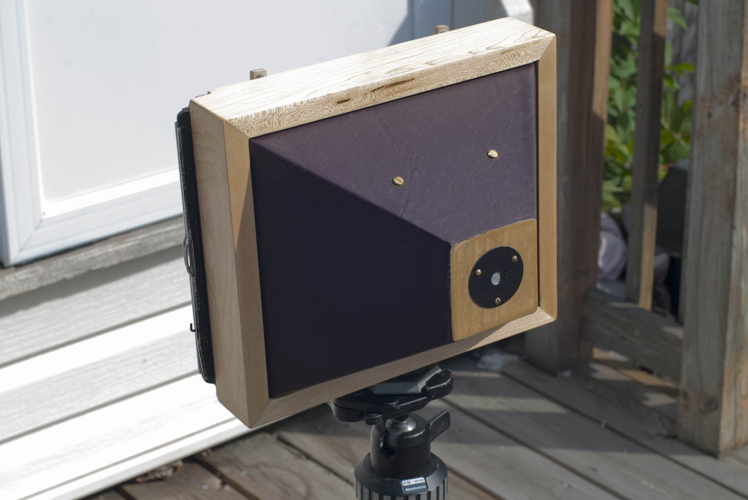

I'm currently in the middle of an 8x10 pinhole camera build. I thought might be of interest to some. I also have a few ideas about how I'm going to complete the project I'm not sure of, one of which I'll lay out here, so I also welcome input from the peanut gallery.
Here's what it looks like right now:
If you're interested in seeing how I got to this point I'm keeping a bit of a running diary of the build at my blog so you can find details on the start of the project here, and get an idea of where things stand as of the time I'm writing these words here.
As you can see the camera incorporates a cone ala the Ilford-Harman Titan and I'm hoping to likewise make the cone interchangeable. For pure vanity reasons I'm also hoping to keep this as clean looking a possible. Currently there is a lip inside the main box of the camera that the cone just rests on. The standard way of mating two parts like this is to use they typical kind of metal clip used to mate lens boards and other parts in more standard LF cameras. I'm severely limited when it comes to fashioning metal parts, and in any case it seems an awkward solution given the angles at which everything meets. My thought then is to secure the cone to the body from the inside, but I'm not sure my current plan for doing so is all that sound.
What I'm thinking is this - currently the inside of the cone is lined with felt (very dark though I worry about fibers landing on the film) secured with a generous spread of carpenter's glue, and I've left this untrimmed at the base so that the felt hang down into the box. My thought is that I can attach one side of a Velcro strip to the felt which can be used to secure it to a strip of the mating side running just inside the lip it rests on in the camera thusly:
My main concerns are that this scheme may not allow the two parts to be held tightly enough together, or that they may loosen too much over time. It would be easy to avoid this situation by permanently attaching the two sections, giving up on interchangeability. A big part of the cone rationale was weight savings anyway (plus I like the way it looks). If anybody has other ideas though I'm all ears.

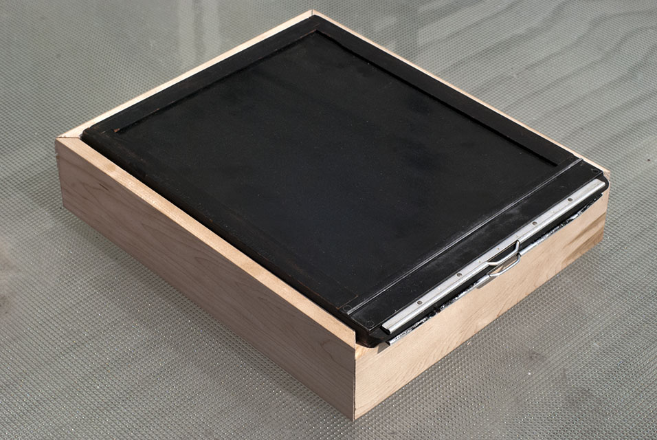

Thanks for the ideas about magnets Matt. Your thoughts about using felt as I've been planning pretty much describe why I was concerned about using it this way in the first place. I've been leaning towards the idea of attaching nylon straps to the cone instead of attaching the Velcro to the felt.The idea of using rare earth magnets might be even better though if I can come up with some sort of scheme to affix them. I'm having a hard time picturing how I'd arrange this though as the mating surface is only about 1/4" all the way around. This may require some thought.
Also I'm interested to hear a bit more on the arrangement you used to clip film holders to the back as this is the other area where I'm still tossing around ideas. The 4x5 project I built does this with a nylon strap/Velcro scheme but this project will have a nicer finish and I'm not keen on ruining it with stuck on Velcro strips on the outside.
This shot was taken fairly early in the construction, but it should give you a good idea of how the film holder will sit against the camera in case this helps.

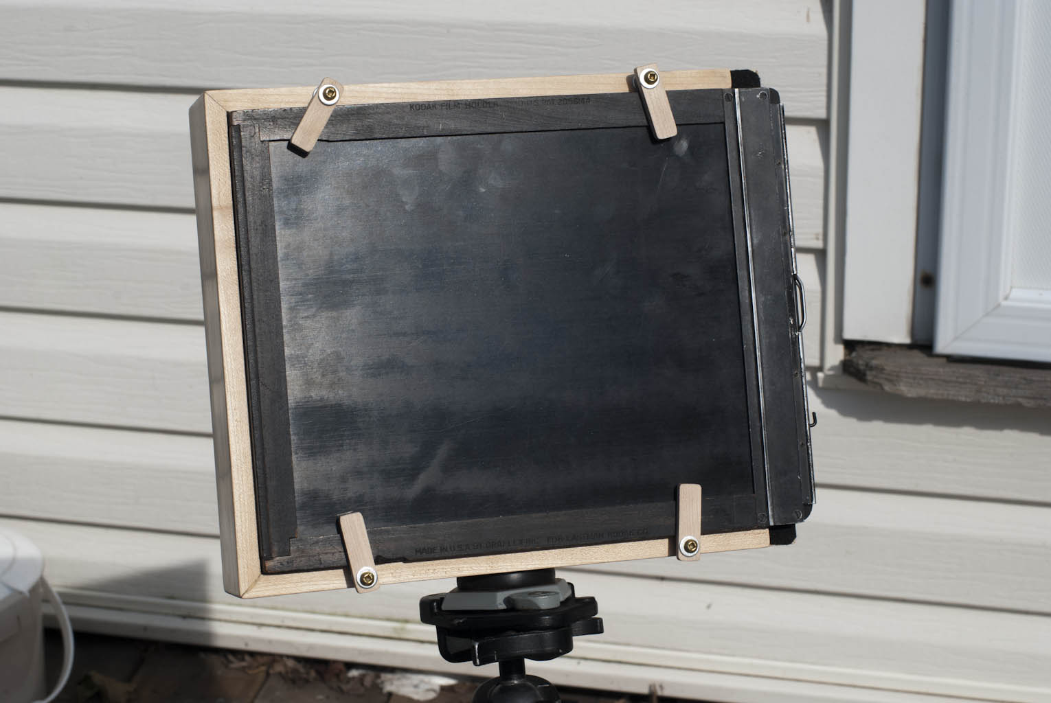

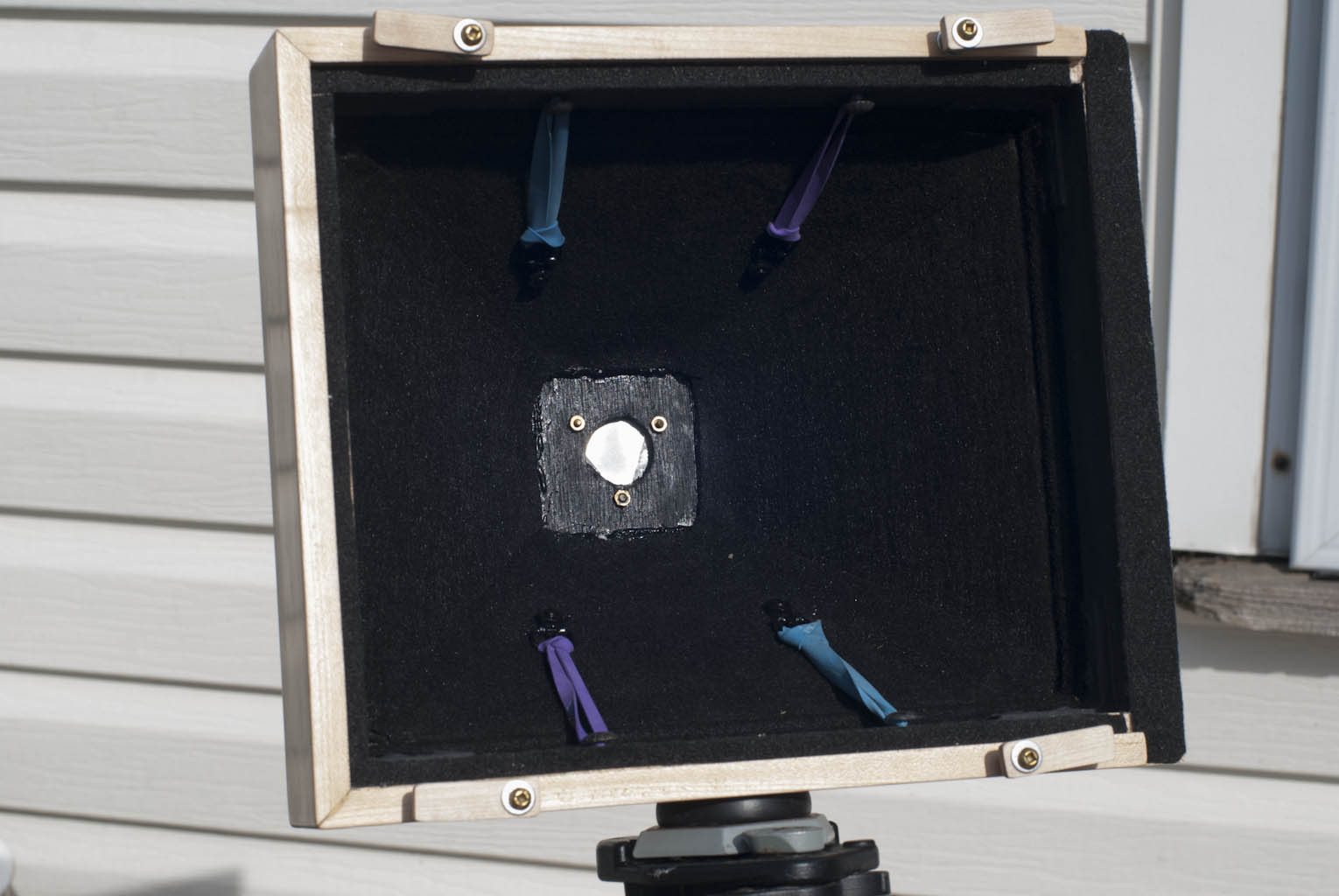

Things are nearing completion, so here's what I wound up doing...
To secure the cone I bolted some mirror hangers inside as an attachment point for, at least for the time being, some good old fashioned elastic bands. I bought some mini bungee cords for this but even the small ones turned out to be too thick. I've been saving the short thick ones that grocery store uses to wrap heads of broccoli together as it seem to be the kind of thing that's likely to come in handy for something, and indeed they were just right for this. On the body side these go over some upholstery tacks that I didn't drive in all the way.
I may change things out as I go along, maybe swapping the elastics for nylon straps with Velcro, but for now this configuration seems to be doing the job nicely.
A for securing the film holder, I chickened out of drilling the film holders in order to add rare-earth magnets as Matt suggested, cool as this idea is. After agonizing over a few fancier options I was considering I went with something more along the lines of what I had originally been thinking and made up some simple latches using a surprisingly appropriately sized off-cut strip left over from making the original box.
I had assumed it would be easy to find latches like this ready-made but found nothing at the local big-box hardware stores I visited. All the better I suppose as these match the rest of the camera.
There's a few finishing touches needed but overall the camera is now in a usable state and ready for some test shots.
This cone gives me 180mm at f/330. I'll probably add a threaded ring so I can attach a lens cap to use as a shutter once I find an appropriate sacrificial filter or step-up ring. The nice thing about this kind of LF pinhole camera is that a shutter isn't a full time requirement, it's only needed when the dark-slide is pulled.
