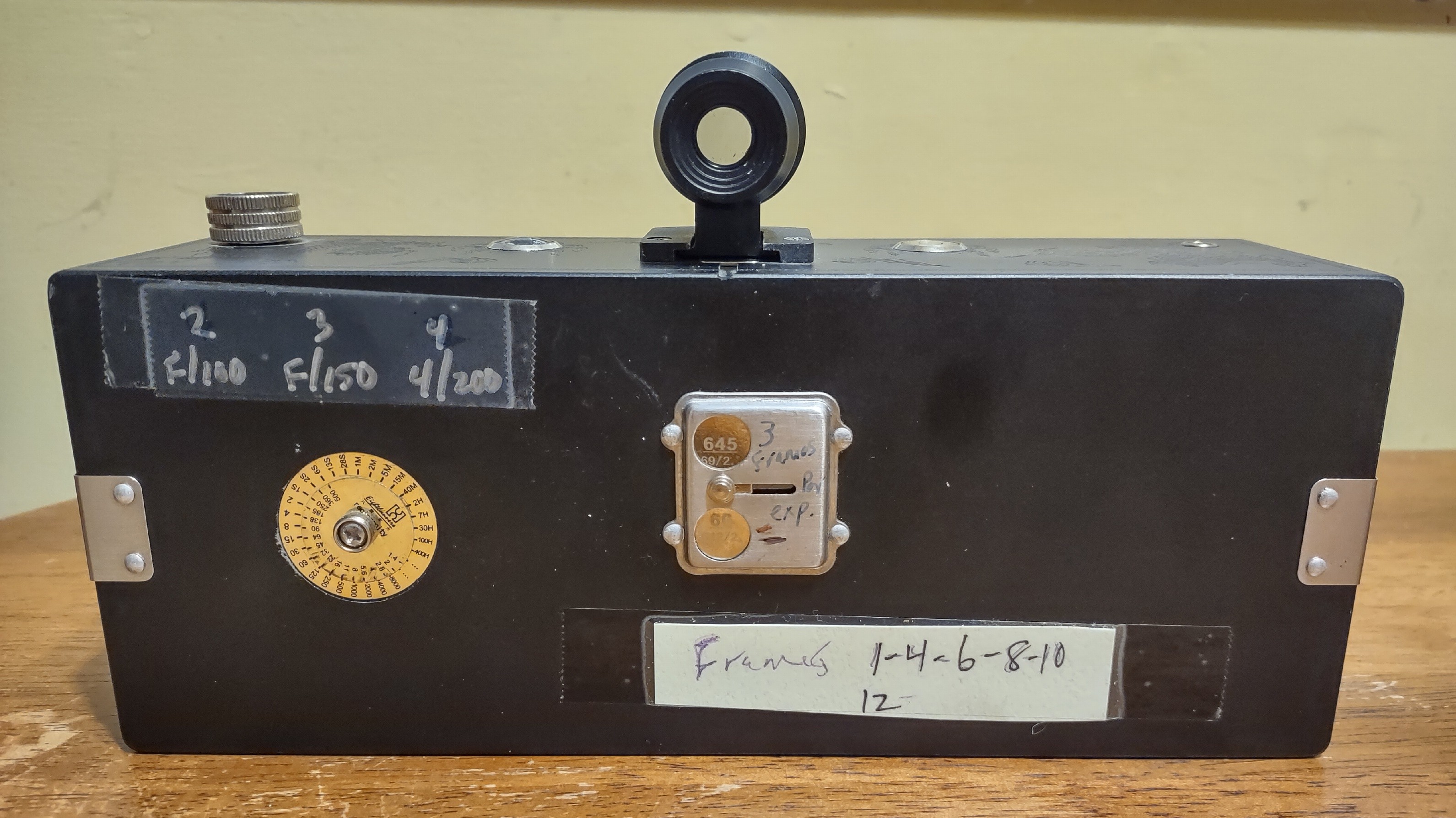

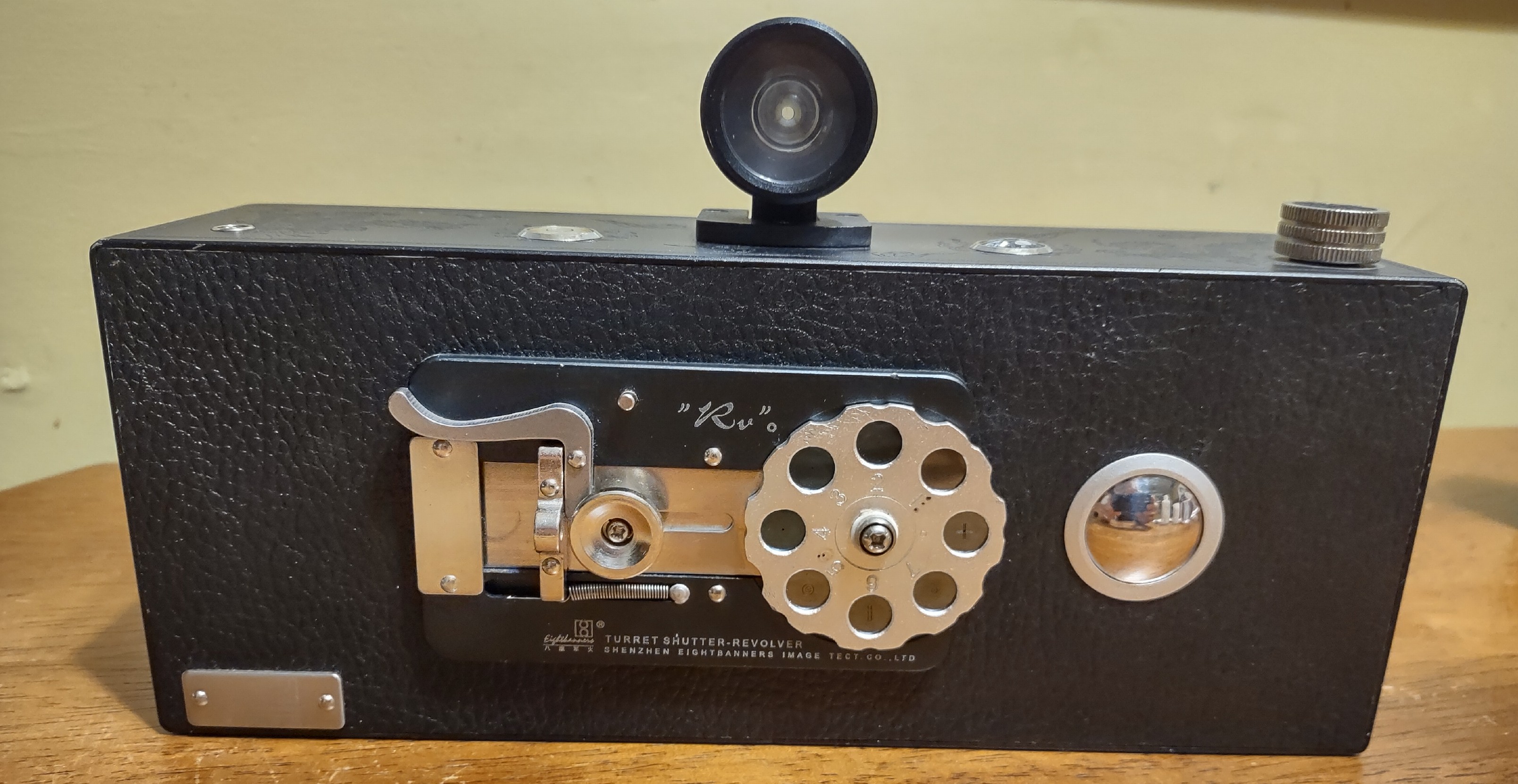

It's here. Looks like someone misunderstood the pinholes in the turret, slot 2 is the smallest, slot 4 the largest. I think this came with a .2mm with optional .3 and .4, so I'm guessing those are the three sizes installed. There are a bunch of patterns in there and two sizes of zone plate. I'll have to change that back legend to reflect the correct f stop for the number 2, 3, and 4 positions.
The one thing I really don't like is that the pinholes are really shiny, I'm going to need to do something to stop the reflections. Not sure if I have any good matte black paint anymore, might need to get some fresh stuff.
Does anyone know which numbers I need to turn to in order to line the film up correctly? Should be 4 exposures as far as I can tell, but not sure which numbers on the 645 or 66 opening, it certainly can't be the frame numbers written on the label, that's too many. What I've read on other cameras is that 6x9 gets 8 exposures so this should be 4. Wish they used a window for the 6x9 printing on the film.
(edit) would 3, 6, 9, and 12 in the 645 window make sense? Been away from this stuff for way too long.

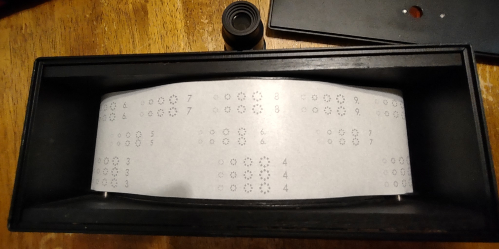

Well... Loading the film is certainly not the most simple task for me. I need to make some kind of tool to help hold the spools and get them in the centers.
Also make sure the red windows are clean and try to buy film with nice dark numbers printed on it. I have some ultra cheap "Ultrafine Extreme" that I picked up somewhere, it has light gray printing and very hard to see. So I wrecked a roll to find out. Stuff was in the fridge for about 5 years now.
After I realized that I couldn't see things moving past the window, I pulled the back off to see what was happening. On rewinding the film back to the source spool for more practice, I noticed that this film might expose part of the tape when using the about 1,4, 7, 9 scheme. Also should that be 10 and not 9?
Pretty clear that this camera lived on a shelf for many years, the front viewfinder cover glass is "frosted" with something, cleaned the outer surface but still something inside. I need to apply some heat and see if I can get the black part away from the lens assembly inside. Also had the clean the red windows for a similar problem (inside and out).
Not sure I'll get out to try some pictures for a few days, but now I have a test roll to practice loading the reel in the changing bag.

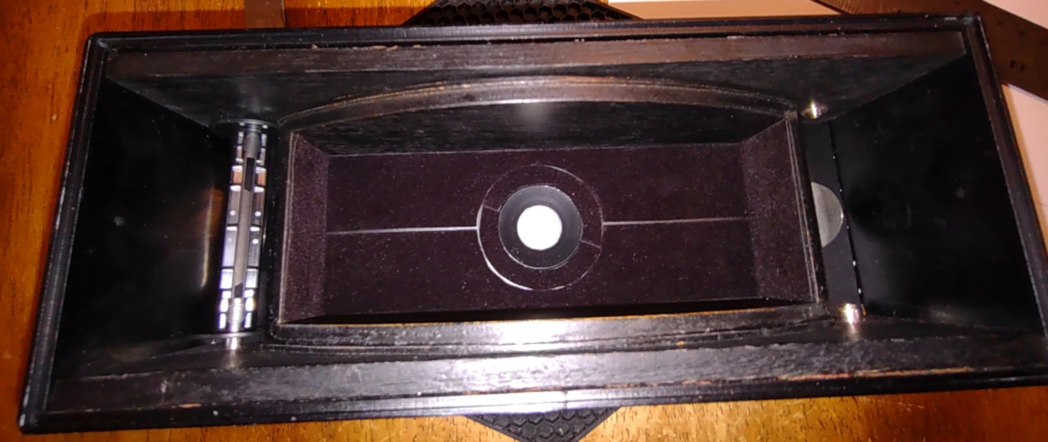

Shiny inside needs to be fixed.
Flash on to try and demonstrate how reflective it is inside. Hopeful fix
Flat black enamel from Microtools and a roll of telescope flocking that I've used on other cameras to help with light leaking through wood and remove reflections. Probably not going to start on this tonight.

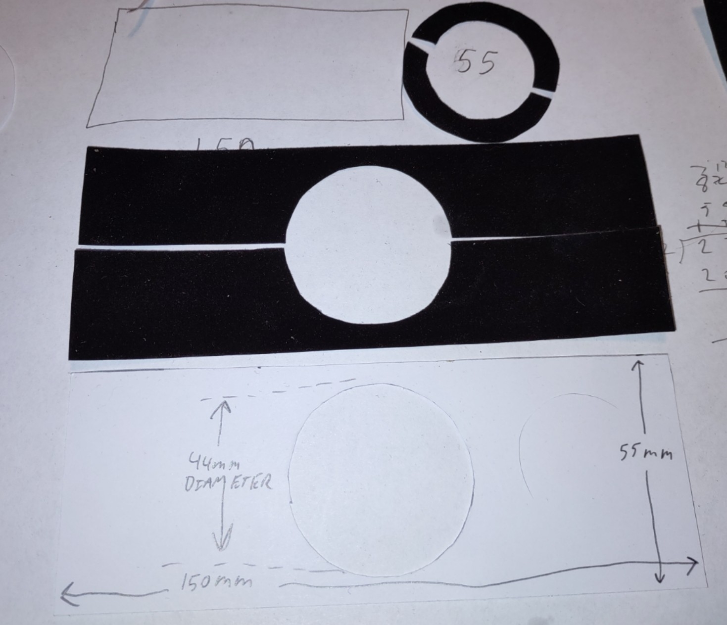

Making some progress, need to cut pieces for the top and bottom of the frame. Not exactly doing the most complete job, but should be good enough. Others will probably think this is polishing a turd, which might be true, but it's my turd to polish, and it's dark outside so what else can I do with this camera right now.
In the end, I know reducing scattered light inside will help to increase contrast in the image. How much it will help? Who knows, but it's my time and materials to waste so I might as well do something that I think will help. If I see a horizontal line in the middle of the frames, then I'll have to go back and fix things with new material. Considering that it looks like I have a lifetime supply of flocking, I can mess around a little.
Again using flash to try and demonstrate the affect. You can see a reflection off of the shutter on the top of the box, so I definitely want to put something on there. Then paint the metal parts I can't flock to try and reduce their reflectivity.

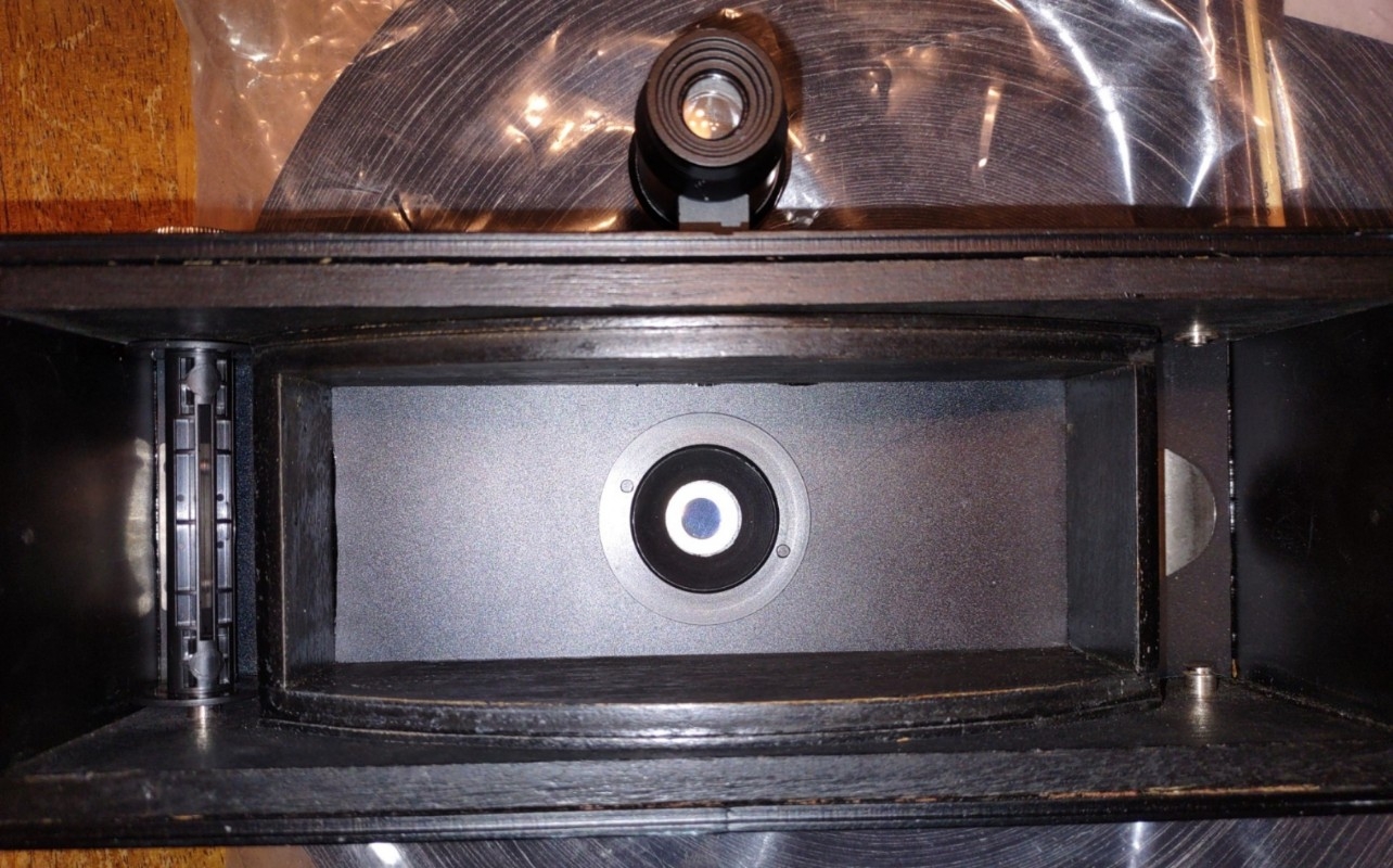

The matte black paint was not a real success, but all the other surfaces are "good" now.
If you are wondering why the center round part has the split offset, because it sits roughly on top of the wrench holes that holds the turret on. It also needs to be tightened a bit, the cable release has enough leverage to cause the turret to rotate.

Ran another roll through with the back off and a pen to mark the edges.
On 645 scale, it looks like 2, 6, 10, and 14 get the job done.
On 66 scale it looks like 2, 5, 8, and 11.
The 645 scale gets that first exposure really close to the tape, the 66 scale really close to the end so this may come down to how generous the film company is with heads and tails on the spool.
I still need to bend some kind of tool to help me position the reels in place, find my light meter and put a fresh battery in, and then take some pictures to test.
