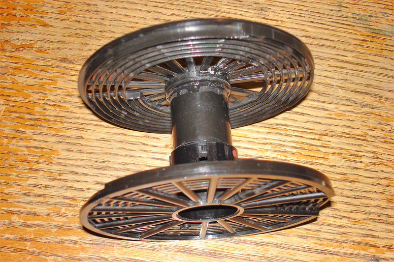

I had 2 Watson's (35mm) in my hands the other night talking to myself about splitting them in half lengthwise and plastic welding them back together with a spacer in the middle. My wife of course thinks I am crazy, but showed no inclination to either load the film or develop it.
If you have access to a band saw it's very doable. The hardest part would be to cut the bottom off one of them and leaving enough material to get 70mm of height. You will need an empty 70mm spool to fit things up.

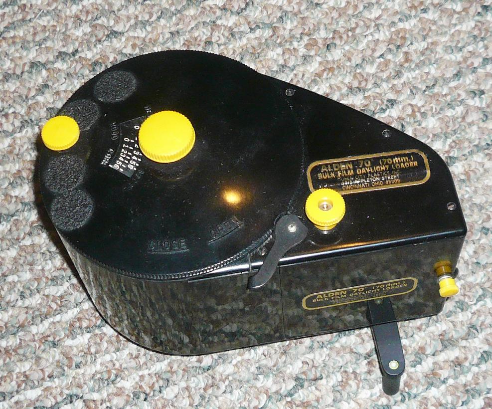

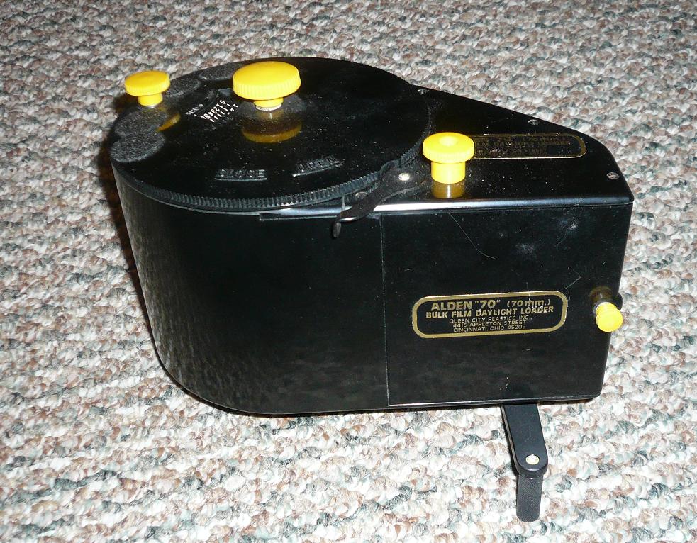

Do you have a pic or link to that Alden? All my searches turn up the 35mm version. It would be fantastic to see your home made developing tank too.
Sure! Here ya go:
The Alden 70mm bulk loader:

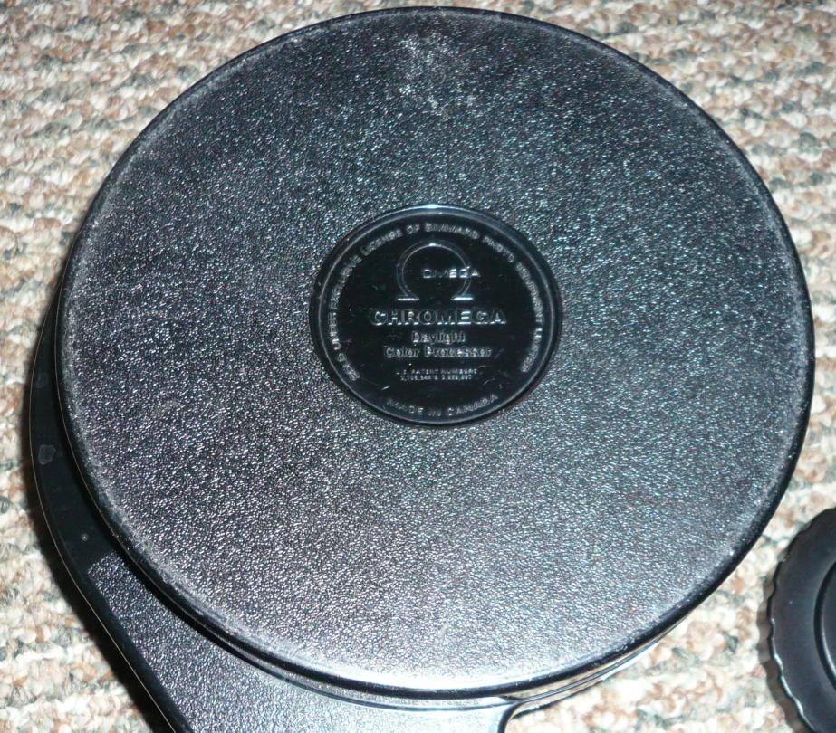

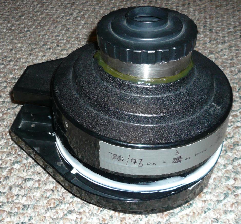

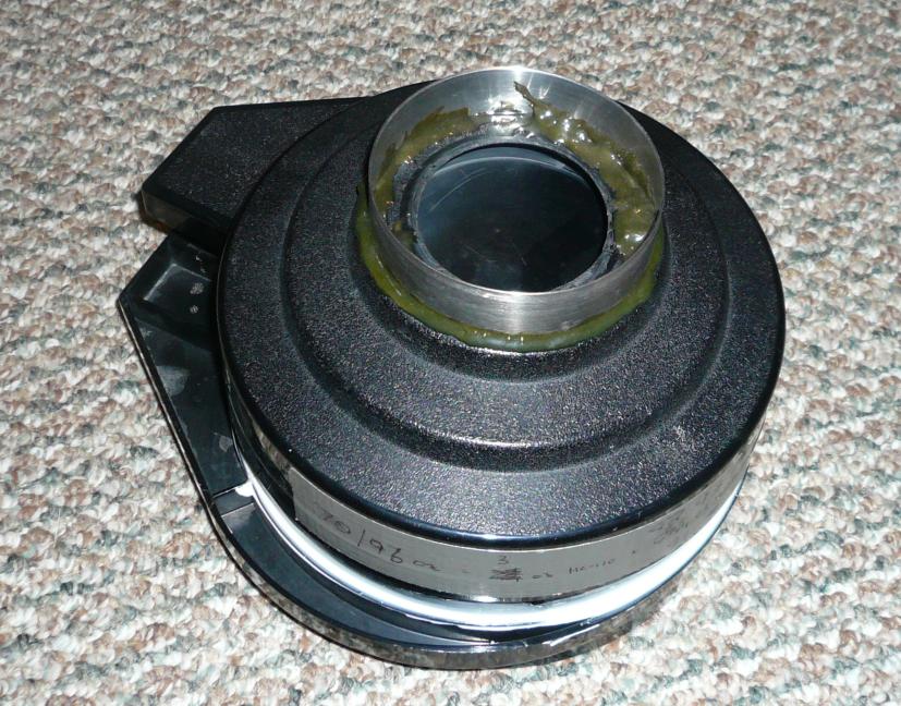

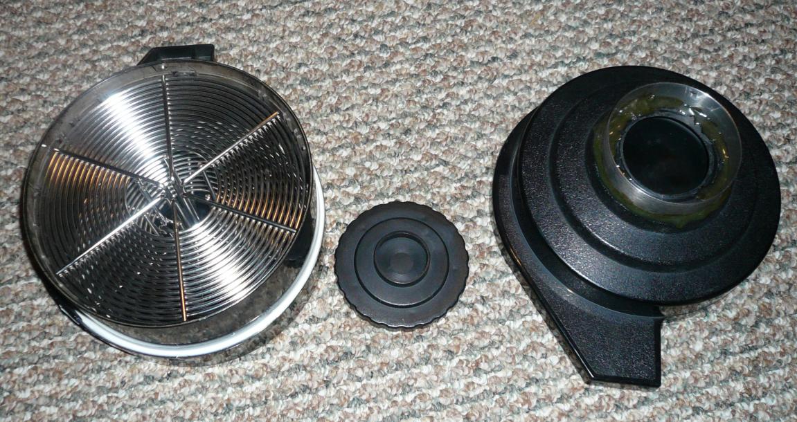

My home made 70mm tank. I bought the 70mm 15' reel first and then went looking for something to put it in. It fit in an old Omega Chromega processing tube/tanks for prints. It's about 6 7/8" inside diameter. Takes 96oz of developer
The problem with the tanks was I could not invert it for agitation or all of the developer would spill out. I had cut down a 120 16oz SS tank to fit a 127 (46mm) reel and I had saved the cut off SS ring. I simply epoxied it to the top of the Chromega tanks and a standard Kinderman tank top will keep the liquid in.
I had to cut down the tank as it was quite tall. More epoxy and silicone sealer. I made this tank around 1988 and it's still going strong.

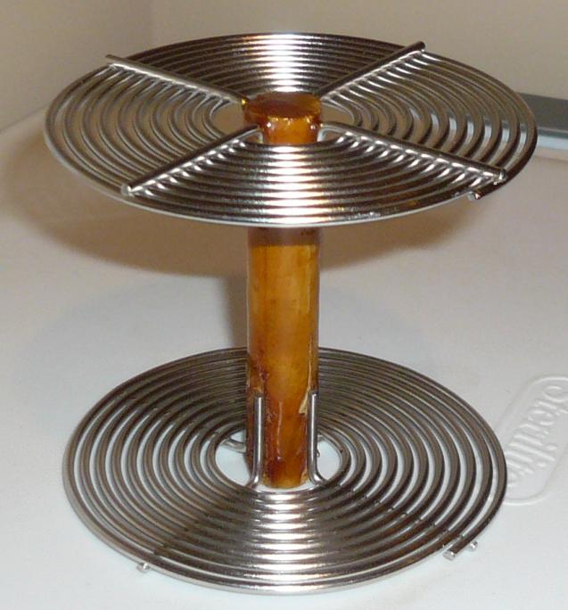

I also mad a 70mm reel that will fit in a standard 16ox SS tank. I took a 35mm 36exp reel and cut it in half. Using a dowel, I spaced the reel ends 70mm apart and epoxied the whole thing. Did this in 1978 to process 26 exp 6x6 frames in 16oz of developer. Works well :smile:

Alden 70mm Bulkfilm Loader
Right from the beginning i removed the counter/sensor(taped the hole) in fear of it could scratch the films.
No need to be fearful? Can i reattach?
NB: I was unlucky and crashed one part of the loader. Queens City Plastics replaced it with no costs for over the ocean-shipping. Was very surprised since they didnt allow to purchase directly. Now i am treating it like raw egg.
