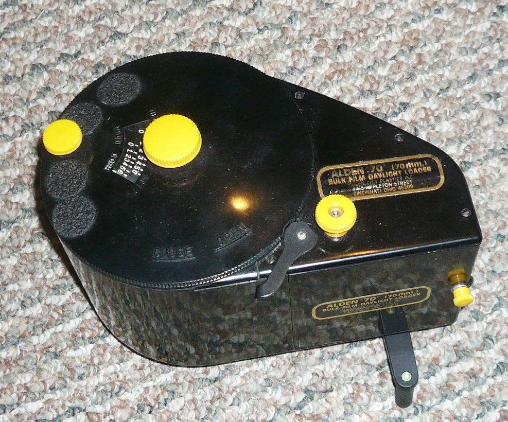

Sure! Here ya go:
The Alden 70mm bulk loader:

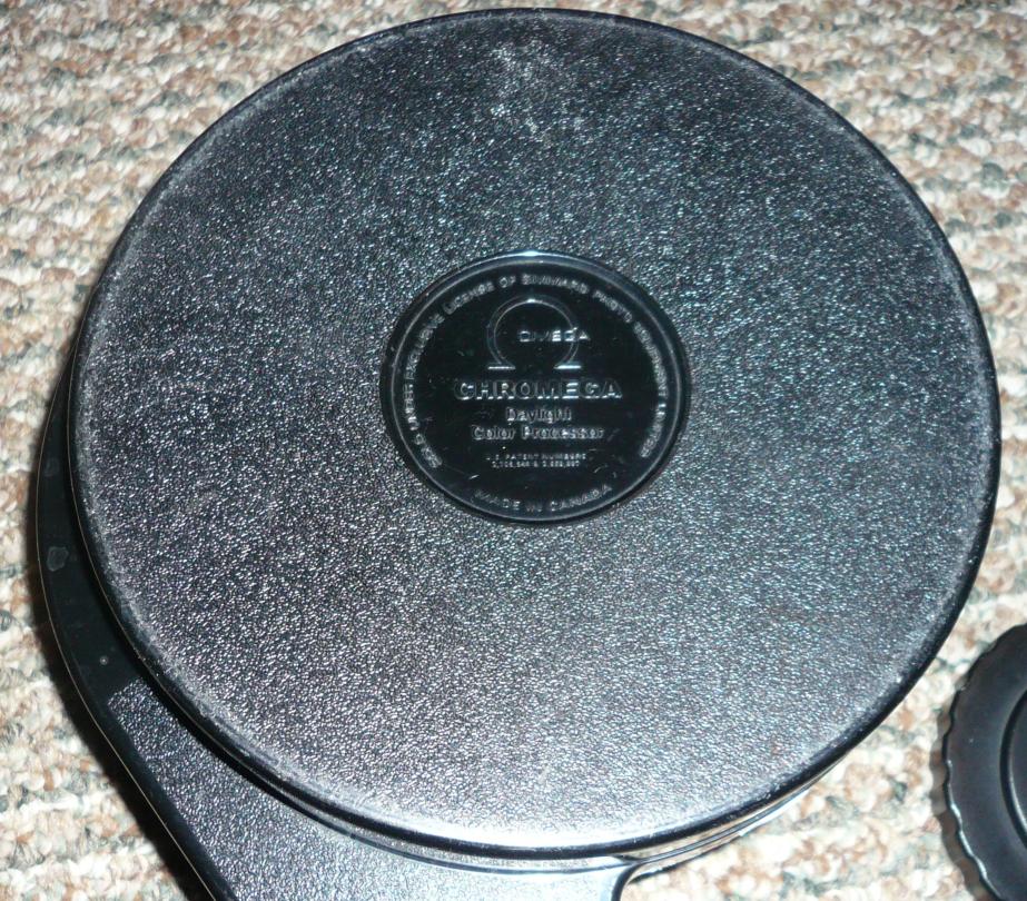

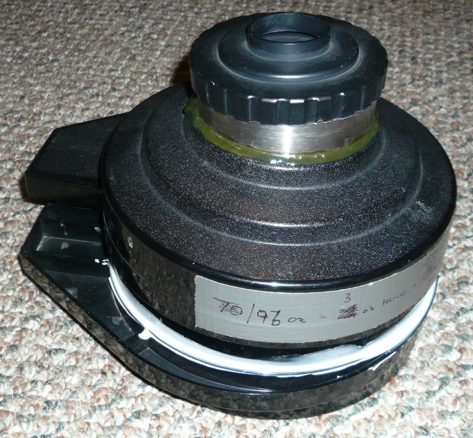

My home made 70mm tank. I bought the 70mm 15' reel first and then went looking for something to put it in. It fit in an old Omega Chromega processing tube/tanks for prints. It's about 6 7/8" inside diameter. Takes 96oz of developer

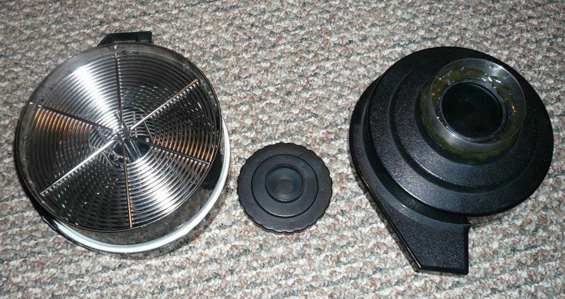

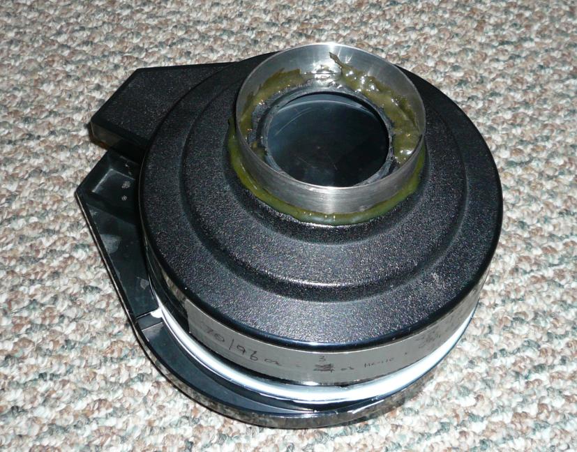

The problem with the tanks was I could not invert it for agitation or all of the developer would spill out. I had cut down a 120 16oz SS tank to fit a 127 (46mm) reel and I had saved the cut off SS ring. I simply epoxied it to the top of the Chromega tanks and a standard Kinderman tank top will keep the liquid in.
I had to cut down the tank as it was quite tall. More epoxy and silicone sealer. I made this tank around 1988 and it's still going strong.
