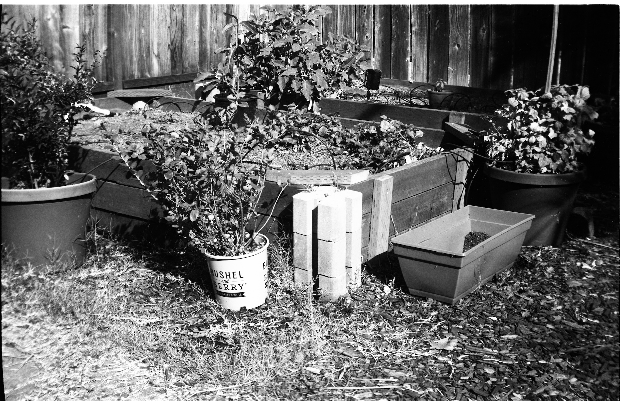

I guess you speak from philosophy, while I speak from experience. This one is actually from the primitive lens of Brownie Special Six-16, Ilford Pan F+. I don't know if it is not sharp. We can agree to disagree. 😀
One way of reducing aberrations is to make the lens very slow by modern standards, like f/11 to f/13. The designers of Brownies knew what they were doing. I don't know exactly what each person means by "dreamy," but often some kind of subject isolation from a combination of limited depth of field, spherical aberration halo effects, and soft corners. These are going to push you to wider apertures.

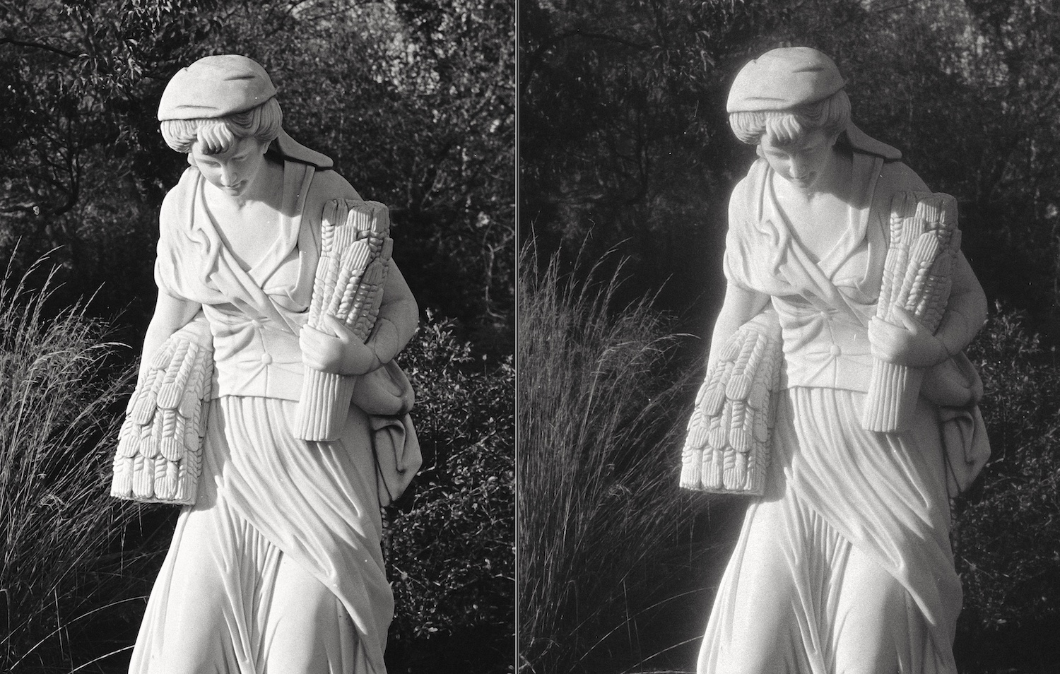

Most of the images from my Rolleicord V are more normal looking that what I have in mind -- except, I did make a few shots with pantyhose stretched over the lens that do get more interesting. I discovered that stretching the hose material more tightly reduces the effect, so I had some control of the degree of softness.
Below are a couple of examples from the Rolleicord with pantyhose "filter" effect. I think the effect would be more to my liking if it were less uniform -- that is, a bit sharper in the center, and maybe less sharp in the corners. So I am going to try to make some custom filters, but first I need to find a Bay 1 adaptor that converts to 49mm filter threads.
So I may decide that using some kind of filter to modify a relatively modern lens from a 6x9 folder may be a more reasonable option compared to trying to find a camera with a meniscus lens that also offers more than one or two shutter speeds and/or apertures.
I might like a little stronger effect than what this second one shows, especially around the edges?

The effect is more subtle on the second photo, but I think it should be noticible on the first one if viewed on a decent sized monitor?
It's easier to see when zoomed in (click thumbnail to enlarge)

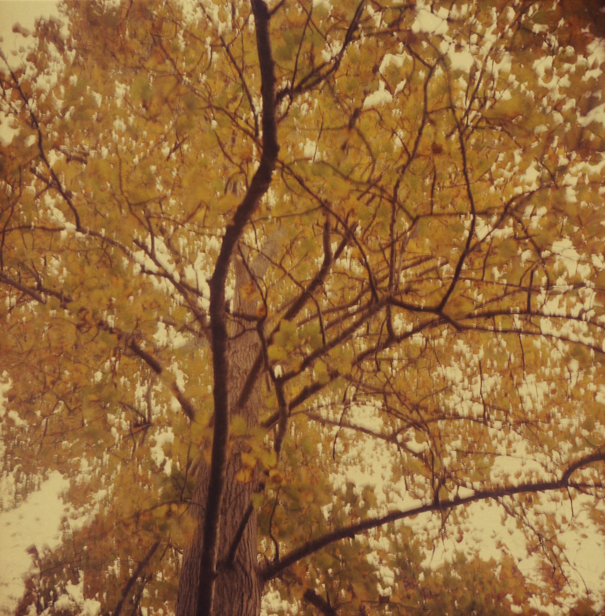

Something like this:
Which was taken with the same lens and camera as this one:

To be clear, I don't want just blurry, which is how I see your tree example.
Understood - you want something like the over-hyped "Petzval" look.
If you look at my tree example, the trunk of the tree is fairly detailed. It is just that I included so much image veiling flare in the image that there isn't much contrast.
