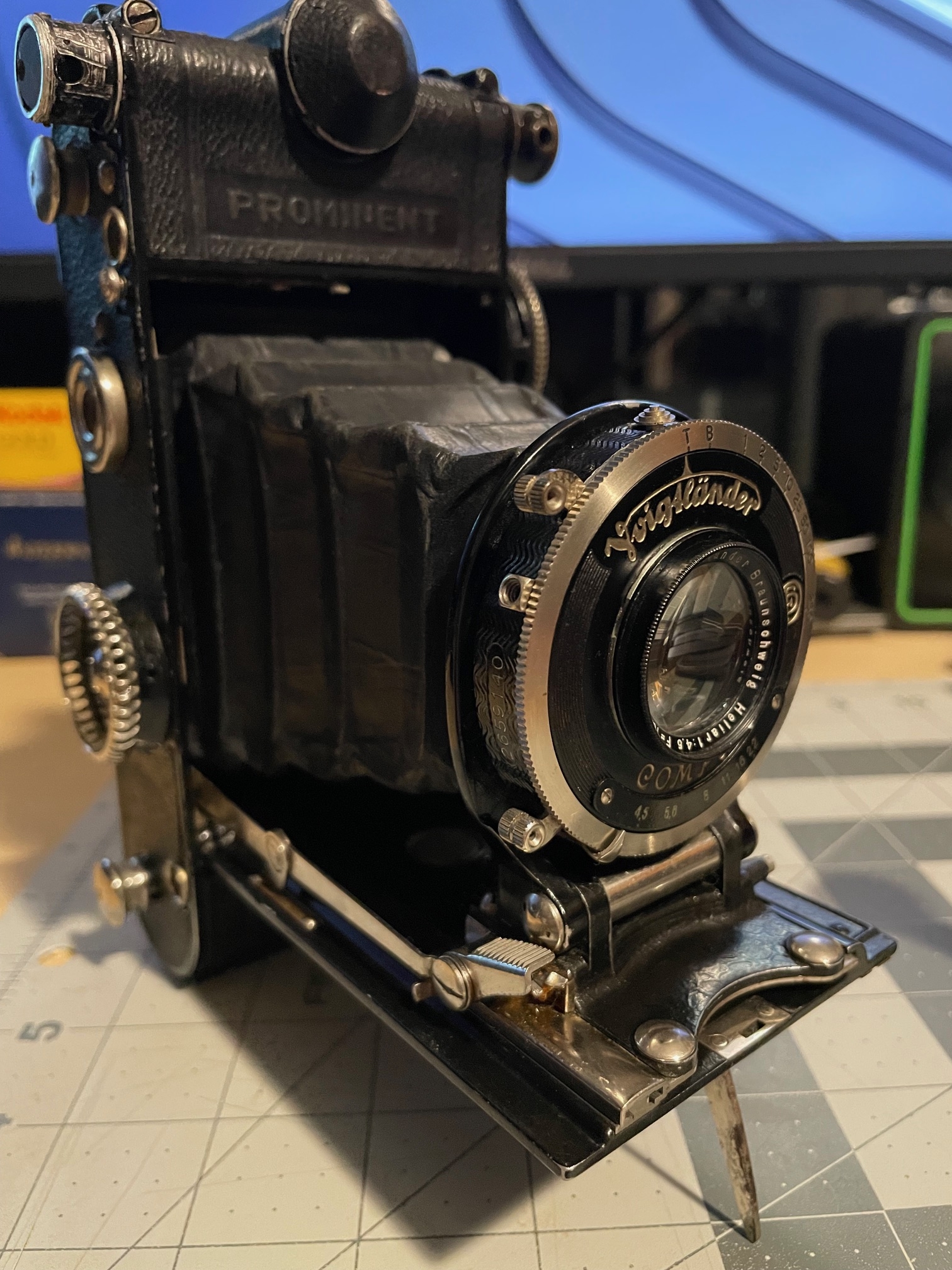

Unsure of the construction of the 105 mm f/ 4.5 Lens on my Voigtlander Prominent 6x9 camera, but it fits the bill for "vintage look".
Found this through sheer, blind luck at a price I couldn't resist; can't imagine paying what the market asks for the camera now...
That looks to be a Heliar lens. 5 element, very sharp and wonderful in other ways. No wonder it gives such a nice look.
Thanks Dan for that info. Shows my lens ignorance but I am always happy to learn.

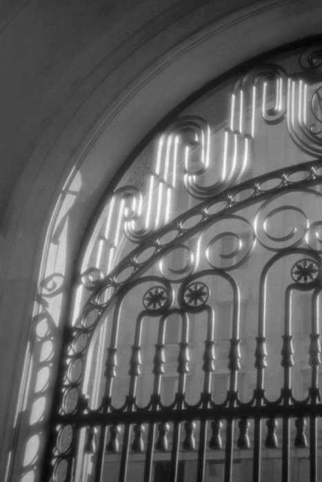

I have one of the cheapest, early versions of the Voigtlander Bessa with am f3.5 Skopar lens (not the Color Skopar) and used wide open it's a very soft, dreamy lens. Is this the kind of "vintage look" you're after?
Maybe. I couldn't tell from looking at your Flickr page if the potted plants was the only photo taken with camera, or also the ones before and after it?

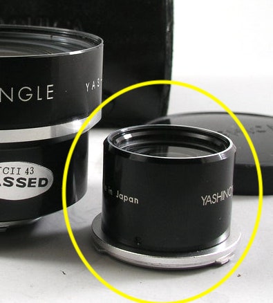

I get effects like that using the WA viewing lens on the taking lens of a TLR.
Thanks, @ic-racer, but I'm not sure what I am looking at? Apparently, that is a Yashica brand wide angle viewing lens? Is it available in the Bay 1 mount? And do you have any example photos I could look at?
Typical TLR bayonet I Wide-angle adapters came with a smaller adapter for the upper focusing lens. The focusing adapter is sharp in the center (so one can focus) but the edges are pretty blurry. I think I have an example I can show...
So? Did you LOOK at the photo I made with it?
Yes. Soft. F/4.5 and faster tessar types of that generation are soft wide open. The OP specified that it didn't want tessar types.

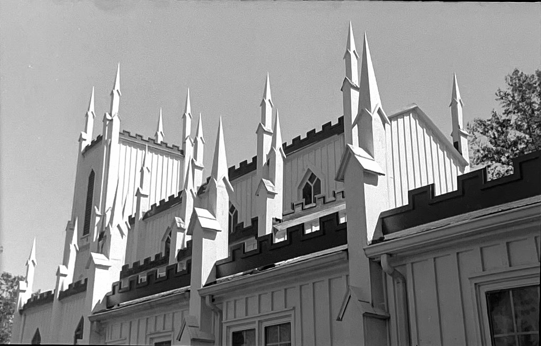

The Voigtlander Bessa with f/4.5 Voigtar is a triplet. It's soft until f/11.
This is f/8 with it, check out the corners. Focus is around that point near the center where the sunlight hits that railing.
Most people do not desire Bessas with these lenses: mine was 85 dollars. Zone focus, popup finder. But they might have put this lens on the RF as well, I don't know.
