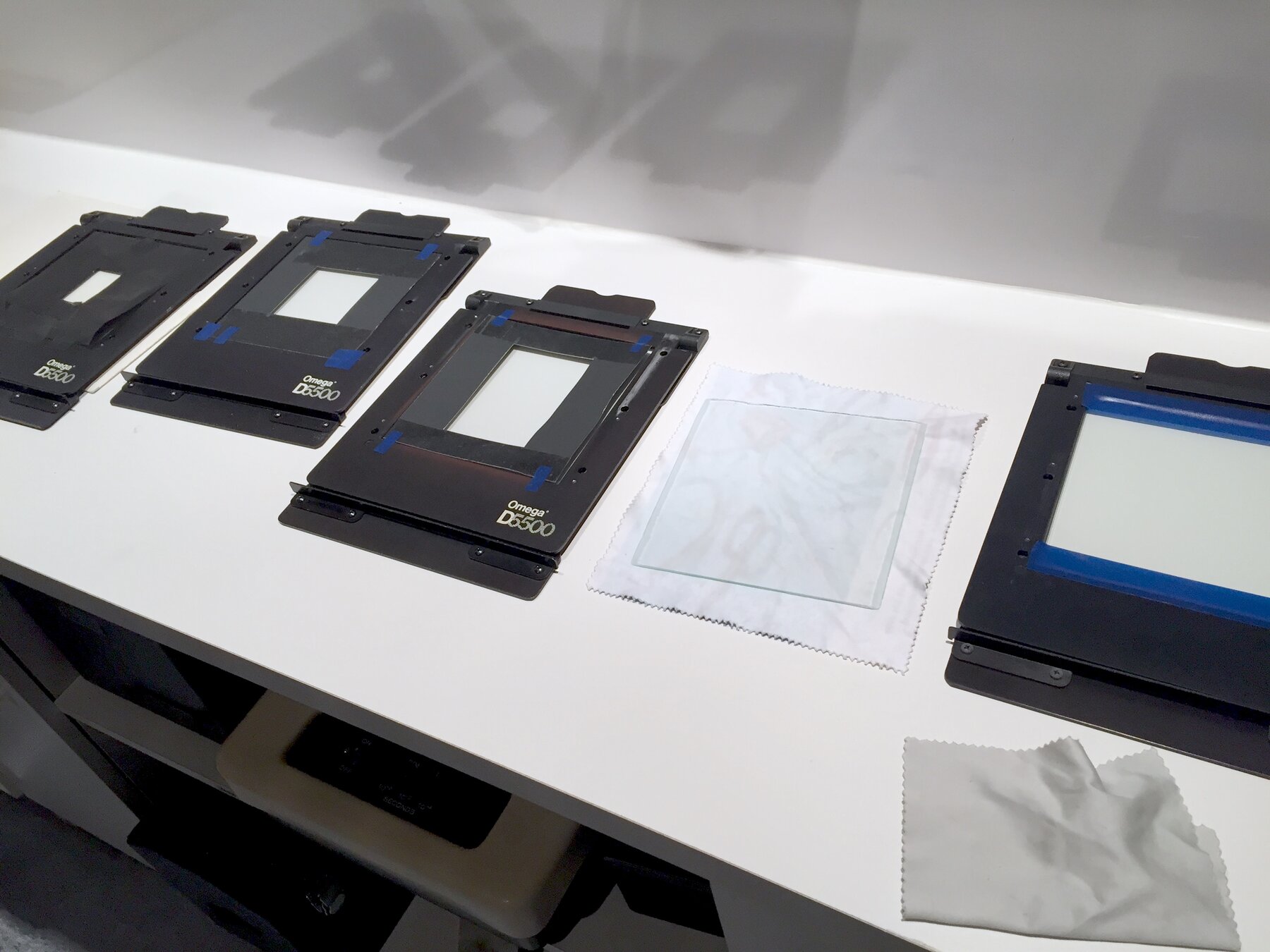

On my Saunders I typically use masks with my glass carrier even though I have other carriers. Glass is better. I've made masks out of thin aluminum and rubylith. For the smallest Minox I also use rubylith tape over a mask since it is impossible to cut a hole that small. If I ever get a 3d printer I'll just print the masks. If I ever get a mill I'd just redesign the carrier.
I think the glass carriers hold large medium format negatives best. I made masks for these carriers (all 5x5" glass).
