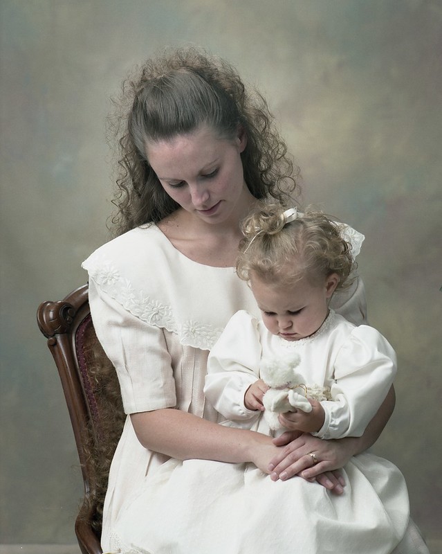

I have several 16x20's from the 6x7 and to my eye there's about as good as it gets. Sharpness, grain free and just superb. They were studio shots but I loved the outcome. This is one of them but the scans, of course, don't do the original justice.
Francis and Kami006ab by David Fincher, on Flickr
