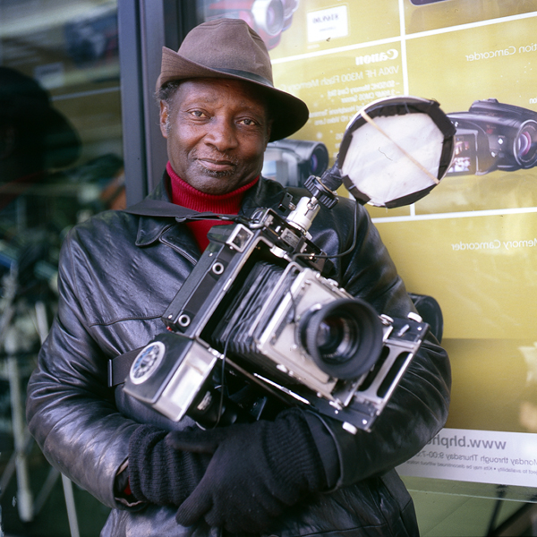

Lovely photos, I see this guy around all the time in the city! Always at the parades and such too, but he's always around chatting with someone and Ive never had to chance to meet him. I think I saw him in the exact same spot in front of B&H a week or two ago.
