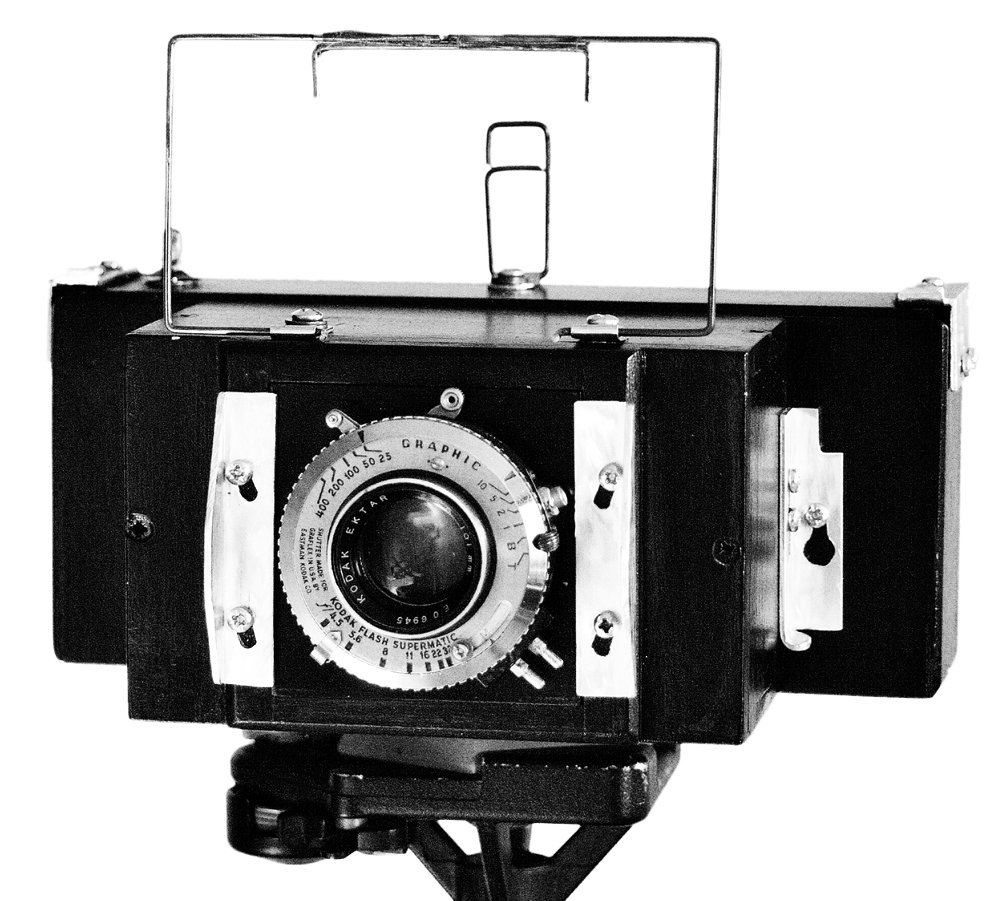

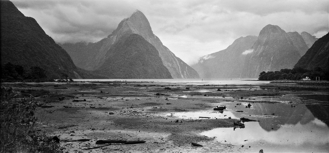

I use a Kodak Ektar 101mm f4.5 from a defunct Miniature Speed Graphic on my home made 6x12. Initially I shot everything at f32 as I made it fixed focus. I also shot hand-held withe everything at around 3m/10ft at larger apertures. I have now modified it to focus but it needs more work. Attached is shot of camera and one taken at Milford Sound, New Zealand. Film is FP4+ in Rodinal.
