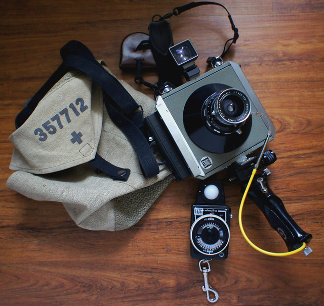

Norma Handy Stuff 3 by Nokton48, on Flickr
I custom built from scratch this way kewl one of a kind Sinar Norma Handy which works good with 6x12 or 9x12/4x5.
This camera is not one to be taken out on dark days. Requires as fast a film as possible. Handles like a giant Leica with 21mm F3.4 Super Angulon. What we have here is the Norma extruded cone with 65 f8 Schneider helical factory installed.
Made from a hacked Norma Auxiliary standard and a lot of fun hours on the design and build process.
This is the camera they should have made; They would have sold a lot of them.
